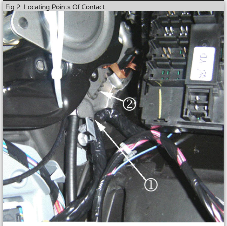

if this vehicle has had the air bag deployed then the seat module must be reprogrammed because there is a code stuck in memory. check around parking brake where harnesses are and see if any are chafed or cut that may be a problem. finally scan for codes as it may show a code. Here is a guide to help us with the CAN scan
https://youtu.be/InIlnsjOVFA
Check out the diagrams (Below). Please let us know what you find. We are interested to see what it is.

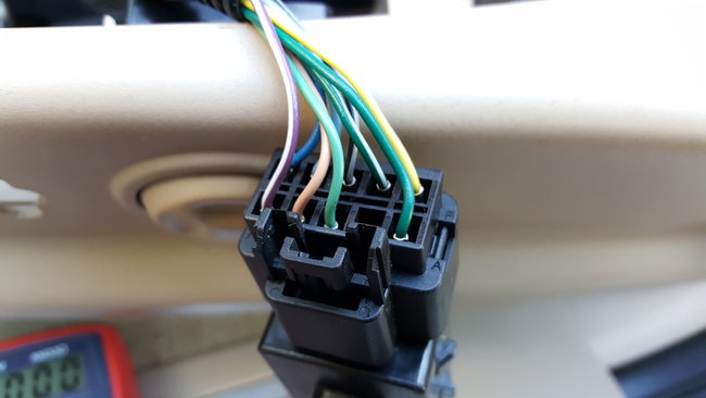

CHRIS EMERY
  • 10 POSTS
Seat Switch plug

What did you find on both wires when the switch was pressed one way? If you found 12 volts on both at the same time, you should have also found 12 volts on the black wire. Check that black wire. If you see any voltage, even if it's less than 12 volts, (but not 0 volts), there is a break in that black wire.
Sep 3, 2019 at 6:25 PM (Merged)
CHRIS EMERY
  • 10 POSTS
The current alternated between the two seat switch positions when activated. When you say black wire, do you mean the gray with black
Stripe. When I connect the purple + and gray /black (-) I get 12+. Is this correct in what you asking?

There's no purple wire on my diagram. I suppose there could be a white tracer on the black wire, but that isn't shown on my diagram.
To double-check, your test light clip lead or meter negative probe should be on ground, meaning a paint-free point on the body. This way we're taking voltage readings AT a point in the circuit, as opposed to between two points. Those are just two different ways of doing this, but we have to be sure we're both doing it the same way.
Measure the voltage on your black / white wire while you activate the switches. Do you see anything other than 0 volts at any time?

CHRIS EMERY
  • 10 POSTS
Just checking, did you get the picture I attached of the power seat plug showing the wire colors? Just want to make sure I'm working in the right spot..

CARADIODOC
  • 34,306 POSTS
I see eight wires in it, which is correct. Check where the wires go to. The wires must go to the three motors under the seat. There is another version that is for heated / climate-controlled seats. I don't know how many wires are in that plug.

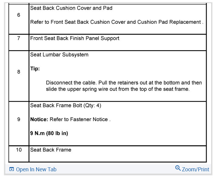

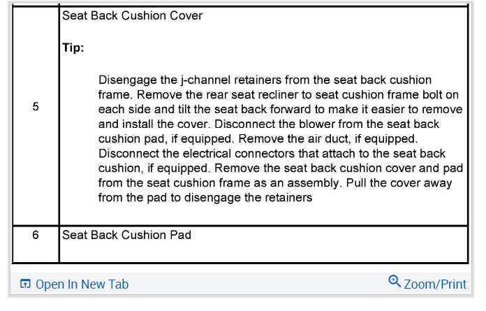

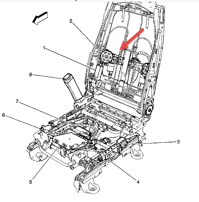

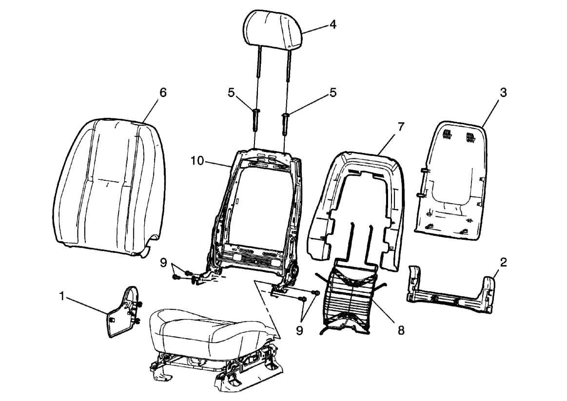

It seems every other function of seat works. When trying to apply more or less lumbar, nothing happens and lumbar just makes a motor working sound. It will move up and down but just not inflate.
Any ideas? How hard of a fix? Are there airbags in the seat which make it tricky to work on? It's a new truck for me.

either get a manual or rent one on site here for a week so you can print the instructions out probably time consuming mostly......

NCYUKONXL
Thanks for your kind reply, though that's not exactly an answer to the issue. After further searching I've found out a bit more regarding a cheap plastic piece that could have broken. Shouldn't be a surprise as its American made.

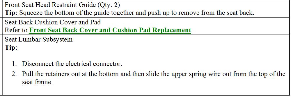

CRHENKEL
I have similar 2007 Yukon Denali driver's seat lumbar failure problem. where can I get this repair manual you mentioned. I would like to rent one for a while to research my seat failure issue.

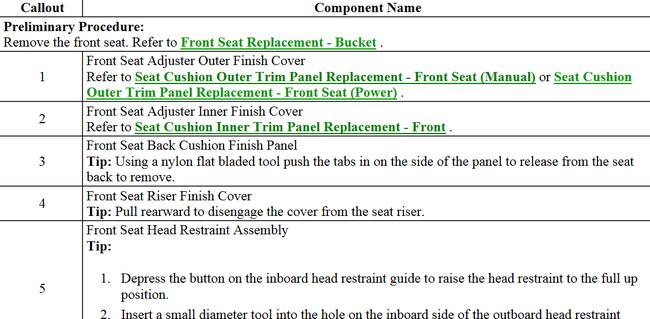

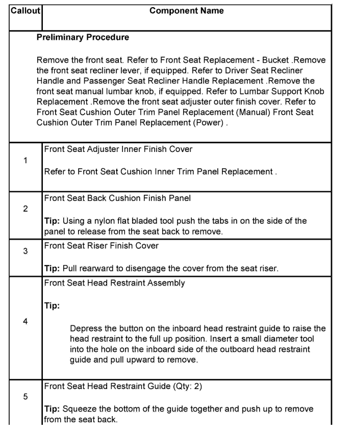

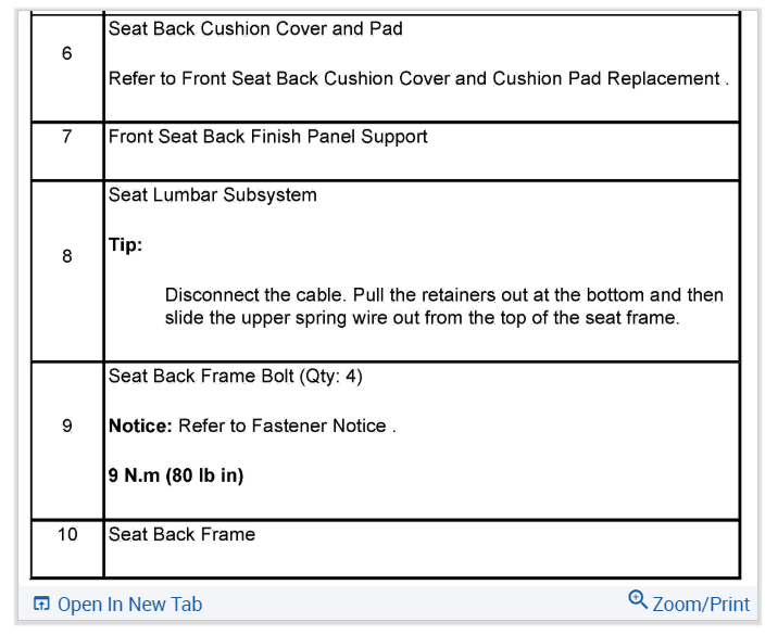

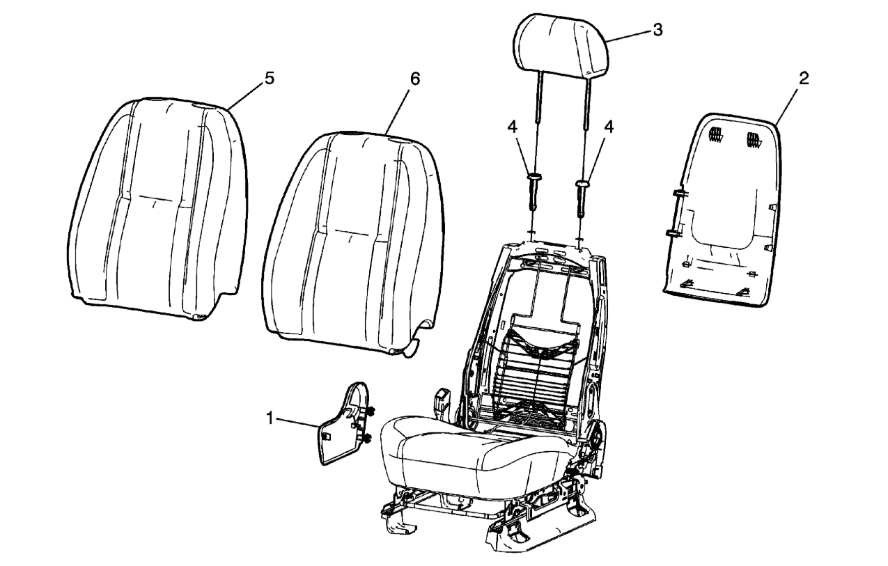

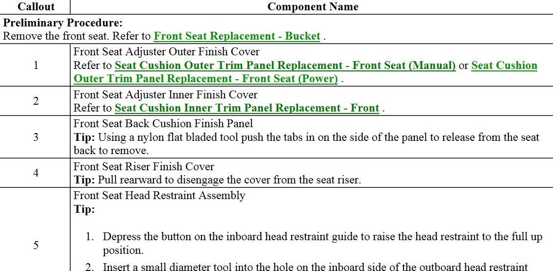

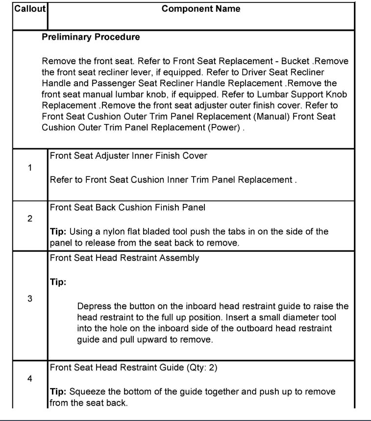

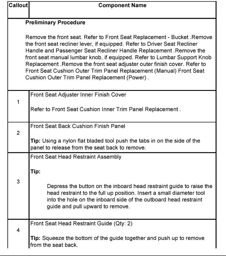

Here is the repair manual, I found more info in the diagrams below.
https://www.2carpros.com/manuals/manuals.php
