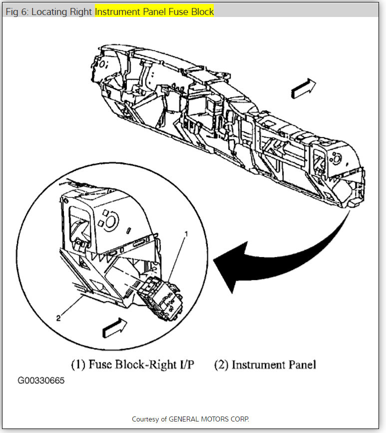

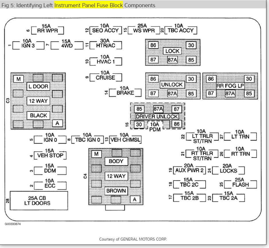

We need to check the fuses first. this guide can help with the fuse location below:
