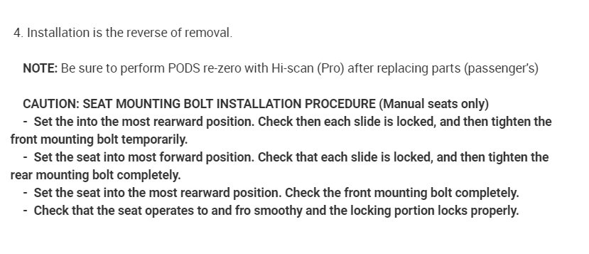

Wanted to know if I can change my driver seat form electric to manual because I can't find an electric one. will it be okay?

Hello.

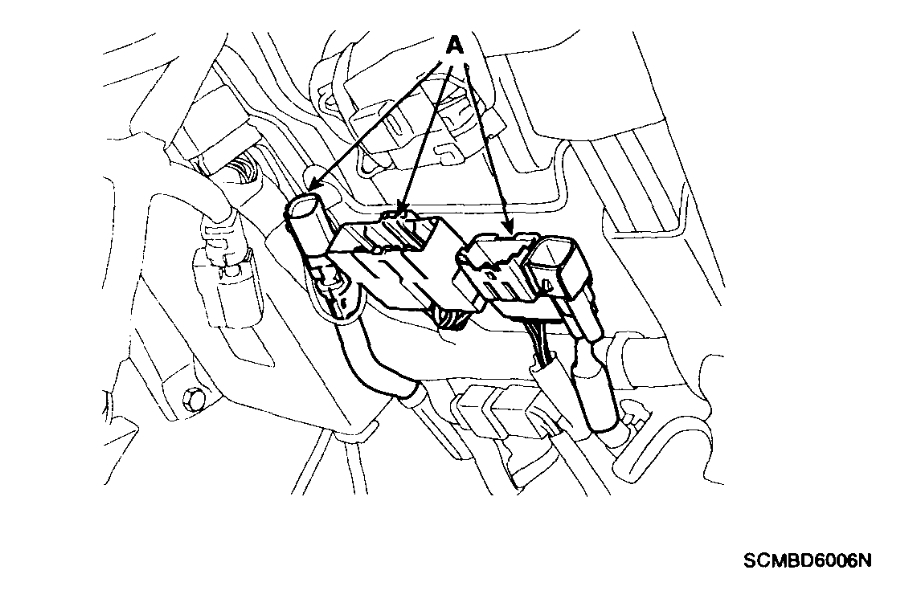

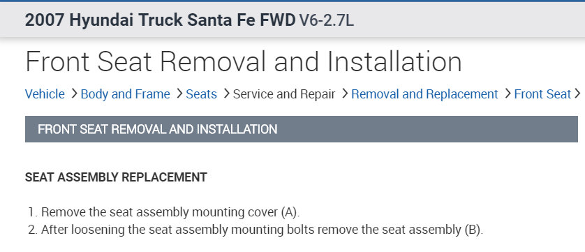

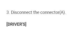

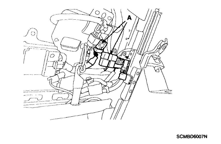

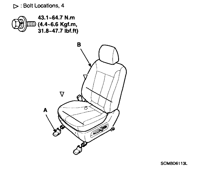

Yes, it should be fine. Have you tried looking online at Ebay's used part's store, LKQ? Anyways, I have included in the diagrams down below a guide for you on how to remove and install both of your front seats. Please go through the guide and get back to us with what you are able to find out.
Thanks,
Alex
