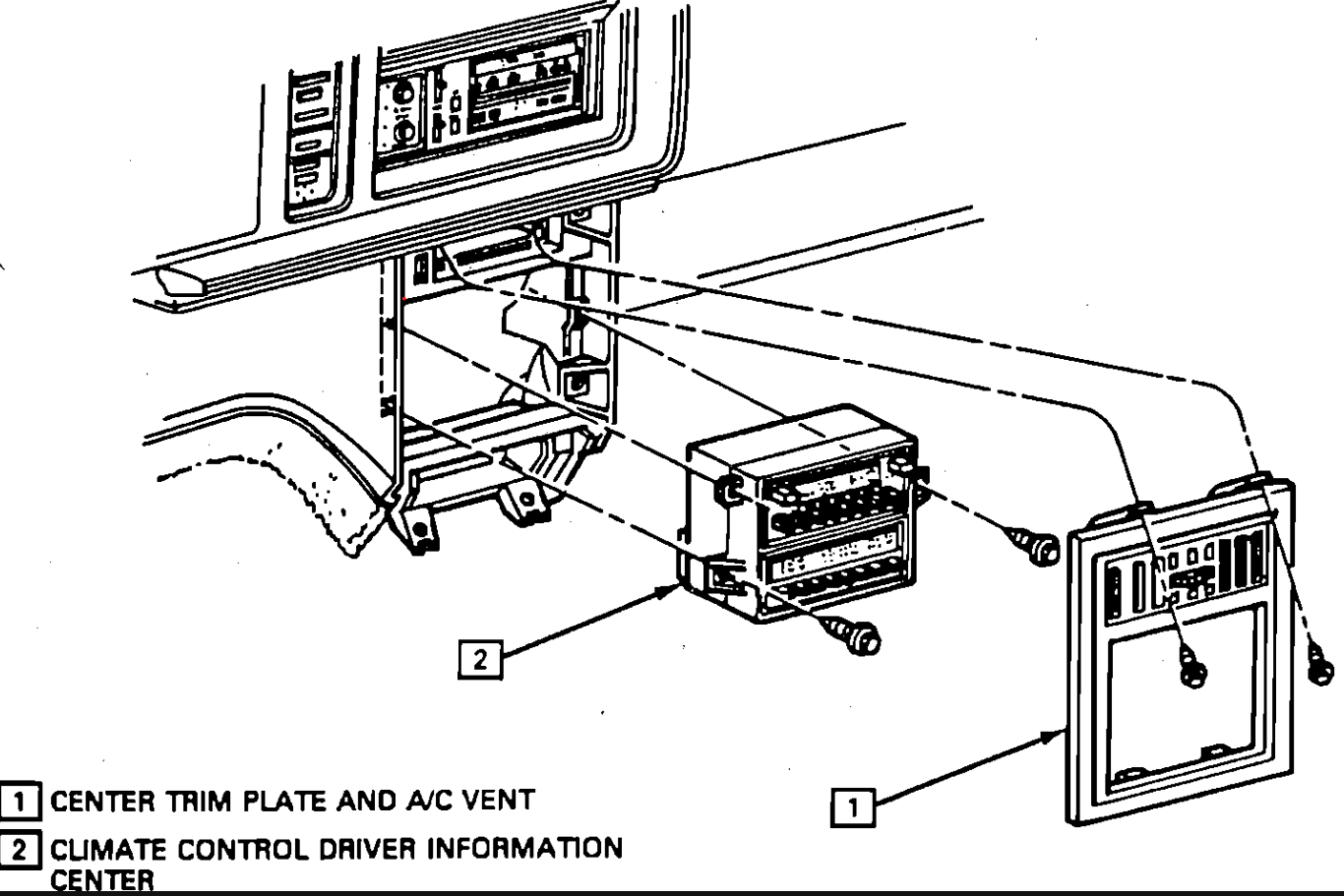

bought the car not by choice. I have it in with my mechanic and he can't get any of the dashboard lights or fan for heat/AC on and is telling me that it's the driver information center that needs to be replaced. he's telling me that there is no serial number on the "DIC" for him to get the right one". apparently there are more than one for that car" a dealership says that they can not get me the right "DIC" with the VIN. what are my options?

It is correct that simply researching a VIN number will not reveal the exact part used in your vehicle as there were several variations. Each part does have a part number designation on a white sticker with what will look like a barcode. That sticker is usually located on the back of the part which does require removal to obtain.
Back in the day dealerships would remove the faulty part and send it to the vendor and "exchange" it for a remanufactured one.
That might be your best bet at this point. There are still several vendors capable of identifying and/or remanufacturing the model you currently have but if the sticker is missing or faded and cannot be read they will need it in hand.
