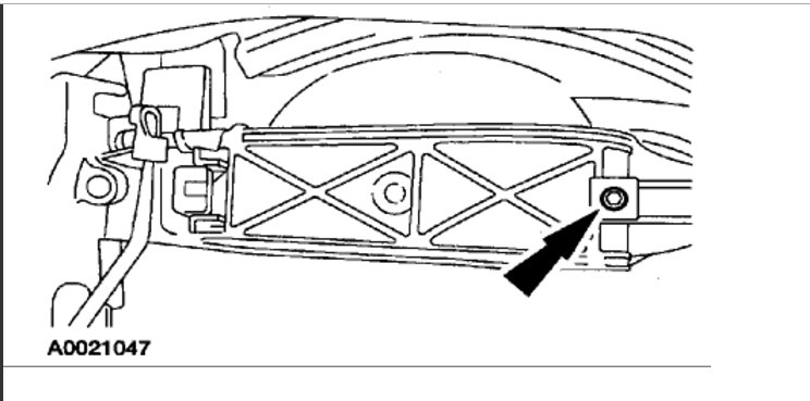

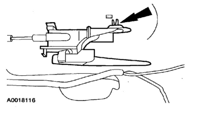

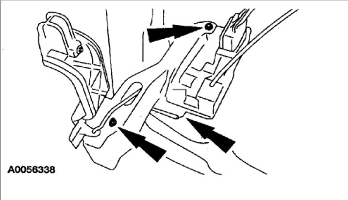

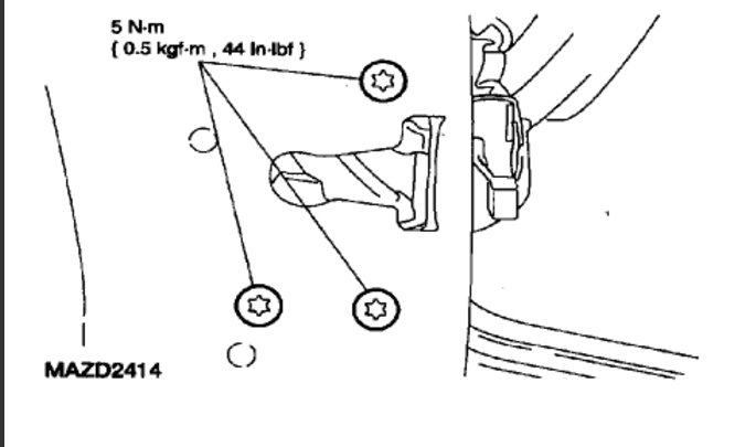

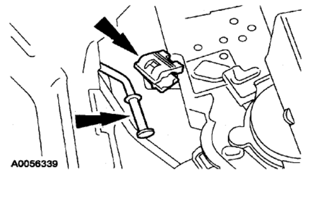

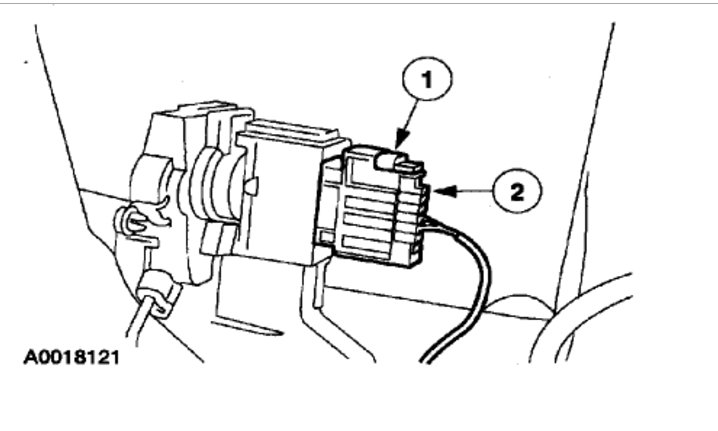

It sounds like the latch has gone bad and needs replacement. Here is a guide and some diagrams (below) to help you get the job done.
https://www.2carpros.com/articles/door-panel-removal
Let me know what happens.
