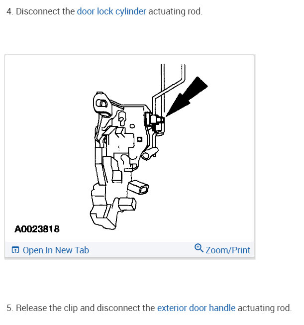

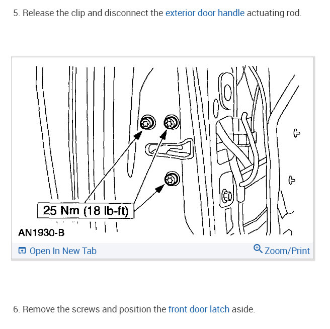

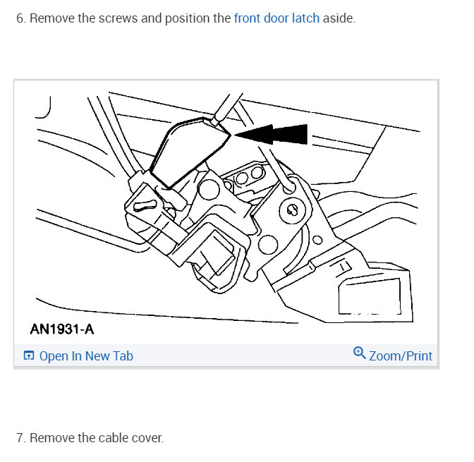

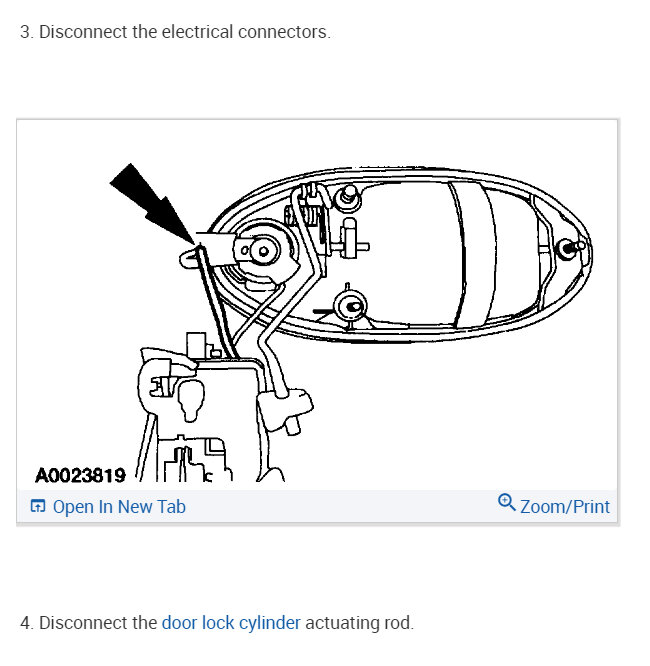

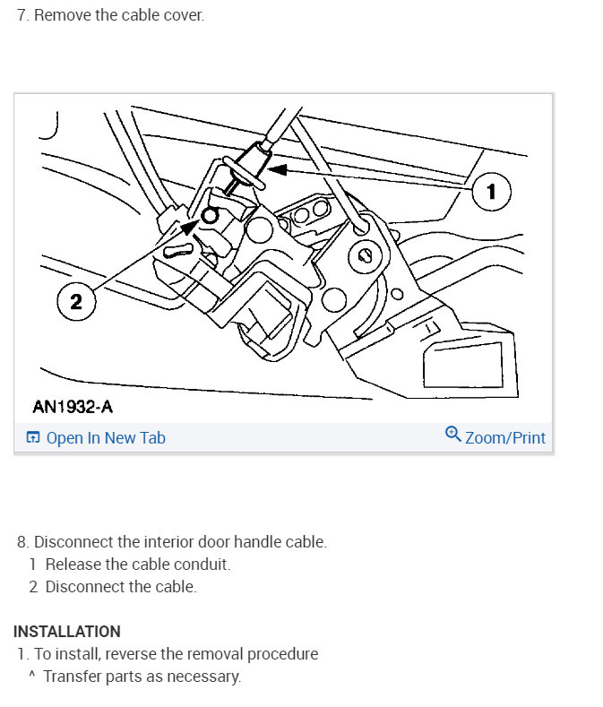

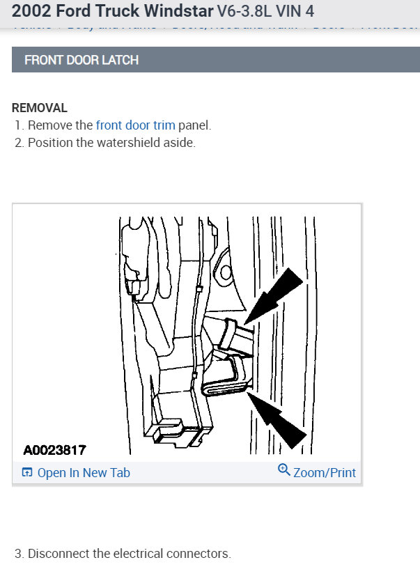

It sounds like the door latch is worn out here is how to switch it out for a new unit. Also, for the window problem please start a new thread. Check out the images (below). Let us know what happens and please upload pictures or videos of the problem so we can see what's going on.
