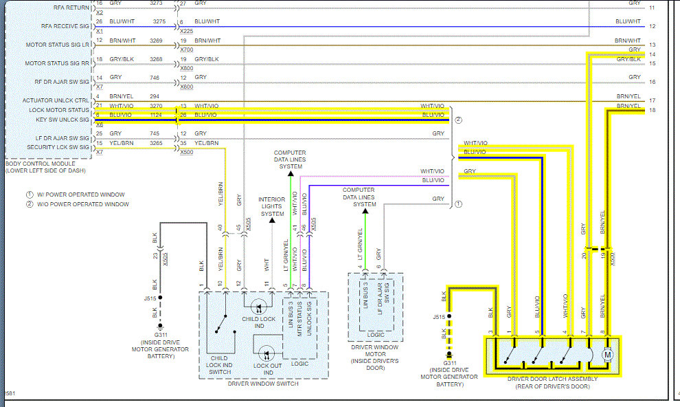

My driver door lock rod will not actuate when used by the FOB or the door switch. All other 4 doors respond when commanded by FOB and door switch.
The key is able to actuate the door lock manually, but that is the only way. I threw an actuator on there, without any change.
I took the rear door panel loose and plugged the replacement actuator into that connector and the actuator is functional.

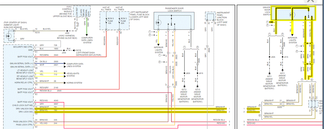

I was unable to locate any wiring diagrams online (that helped) at this point and I didnt find the fuse panel "legends" helpful.
I did only start messing with this issue this morning, so any help is appreciated.
