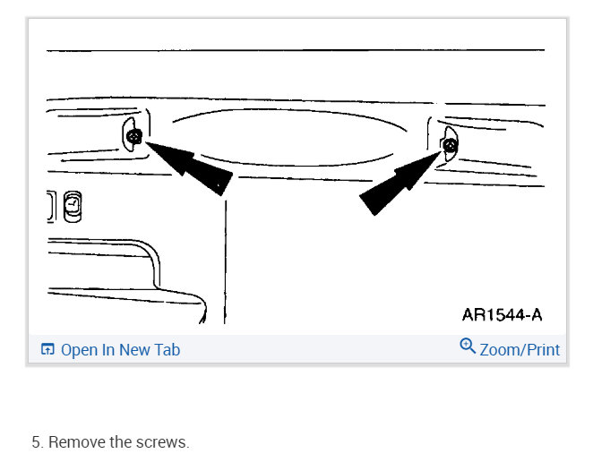

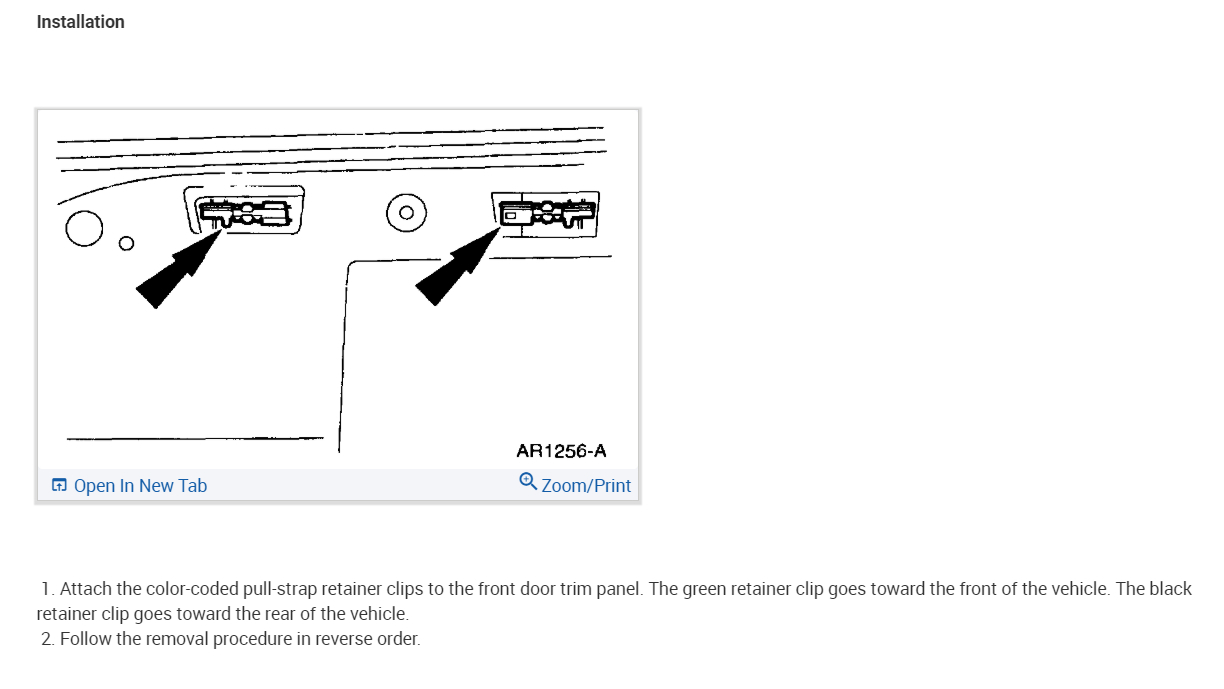

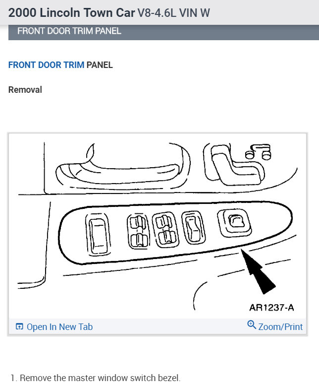

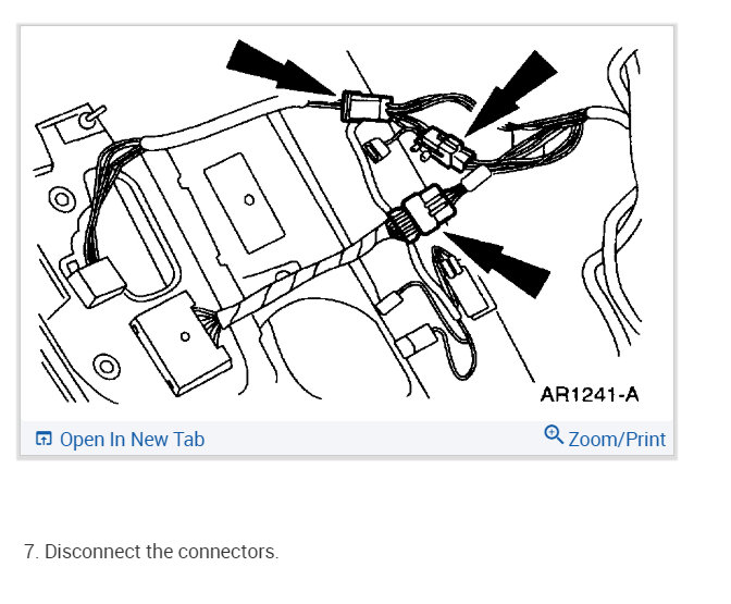

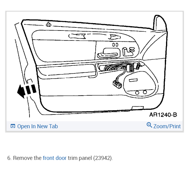

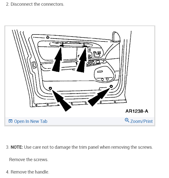

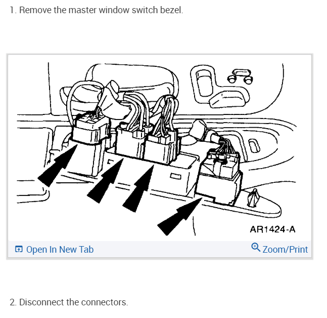

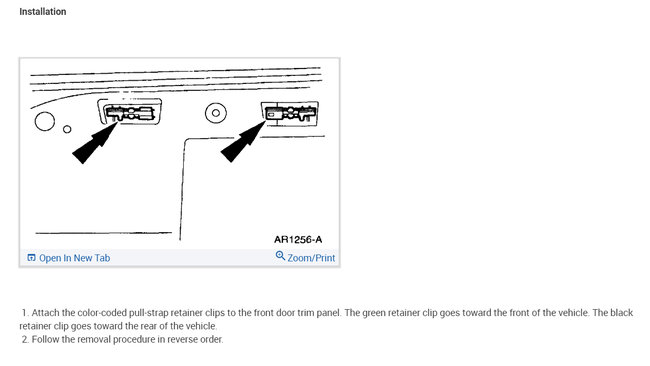

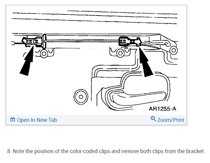

Not really, you must remove the panel to reattach the arm rest. Here is a guide to help you with diagrams below to show you how on your car:
https://www.2carpros.com/articles/door-panel-removal
Check out the diagrams (below). Please let us know if you need anything else to get the problem fixed.
