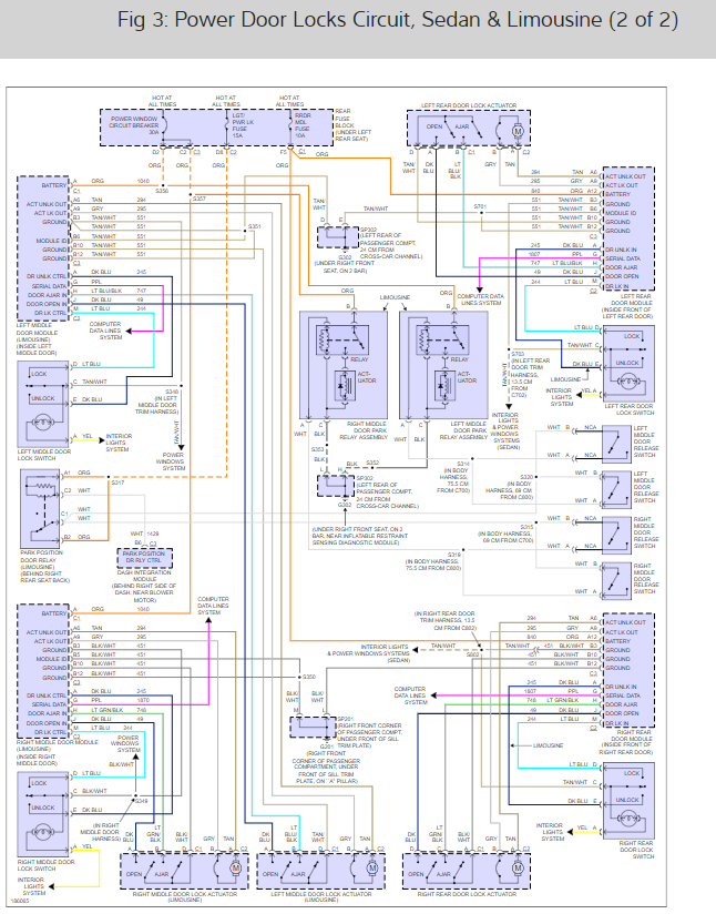

The driver side door controls do not work. If I jiggle the wires in the pass through, it occasionally will work, but will then go dead again. None of the drivers side controls - window, door lock, mirror - work. I checked the fuse and it is fine. All other electrical parts work well, and the door lock on the drivers door works fine with the fob. Do I need to replace the drivers side door module, replace the wiring harness, both, or try something else?
