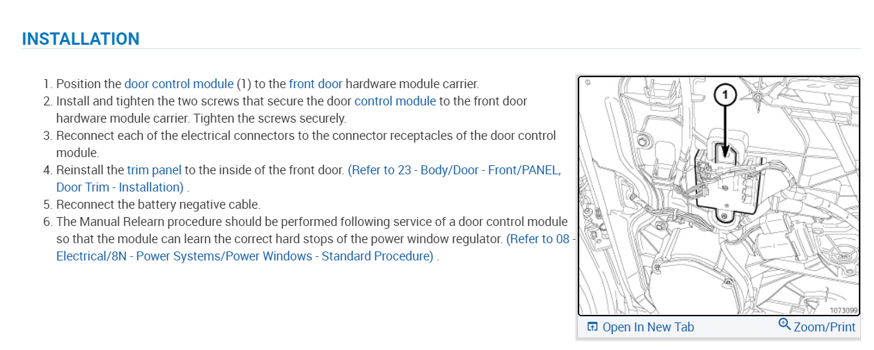

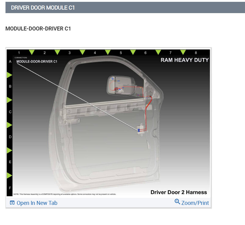

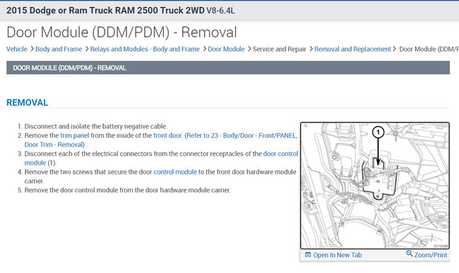

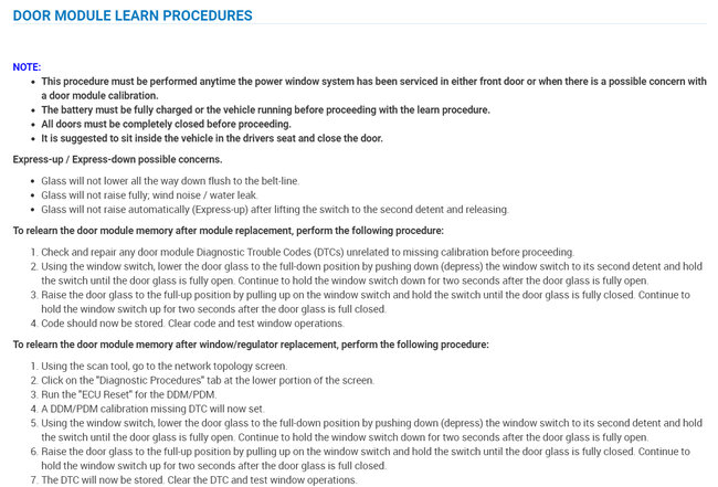

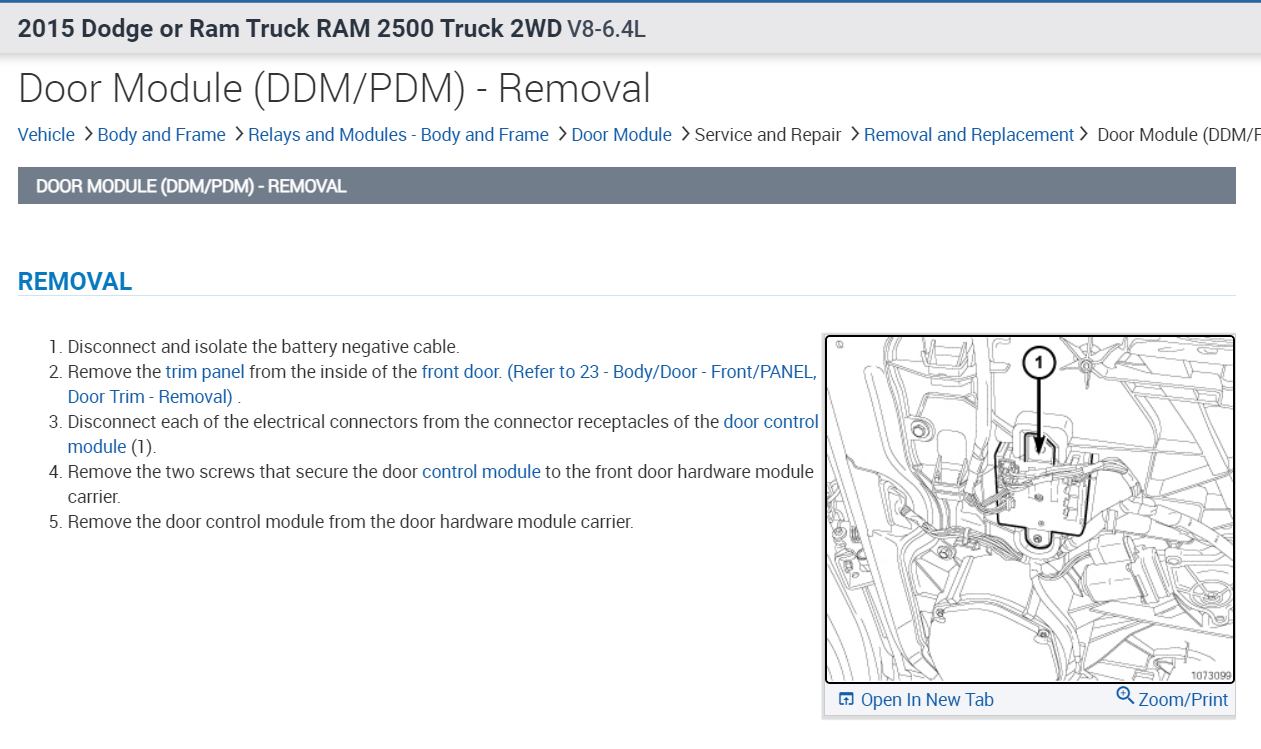

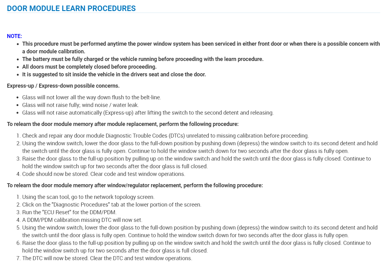

Here is the location of the DDM and how to replace it and do the relearn. Check out the images (below). Let us know what happens and please upload pictures or videos of the problem so we can see what's going on.
