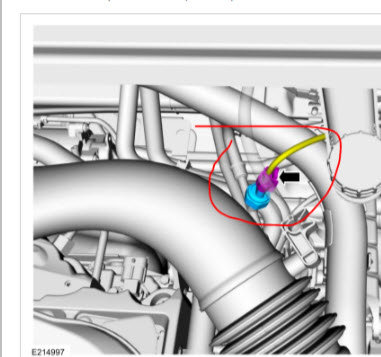

P0087, my first step is to replace the low side pressure sensor. The pressure should be cycling from 90-60 ish. When the sensor fails it will be stuck at one pressure, like 100 or 90-something. The sensor is mounted on the fuel line between the engine and firewall/bulkhead. The Ford basic part number is 9F972.
