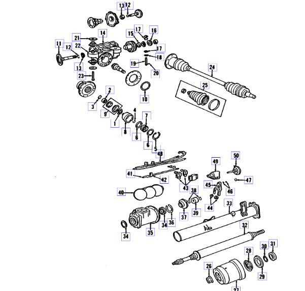

Okay, I removed the rear drive-line as well as both CV axles eliminating rear differential from equation. Van still makes a grinding noise and bangs really hard on undercarriage. When I turn the rear drive-line output shaft it makes a partial revolution 1/4-1/2 revolution and thinks.

Does it make the thunk when you turn the shaft back and forth? It does sound internal in the differential.

you will need to open the differential and see why there is too much play in the ring and pinion. it could be bearings or just worn out.
