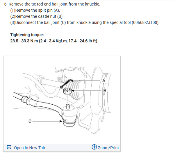

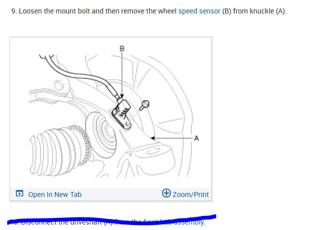

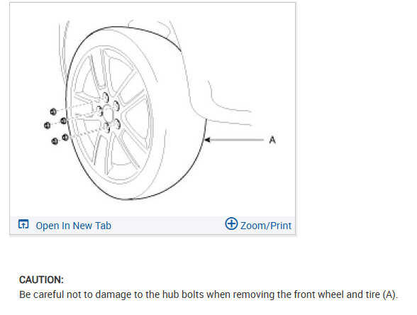

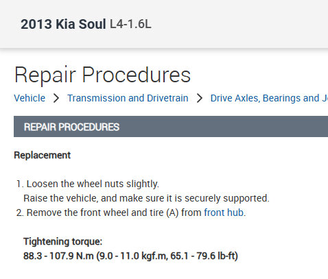

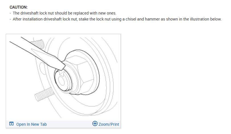

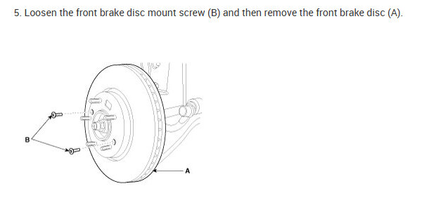

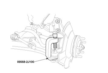

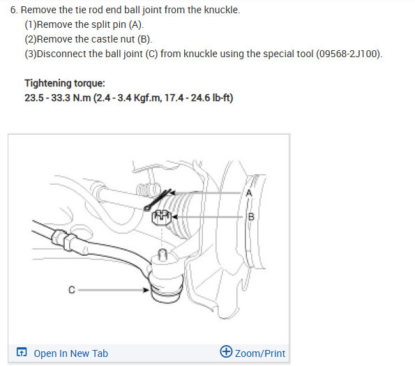

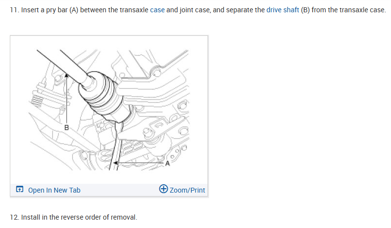

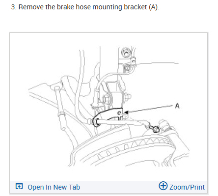

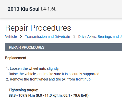

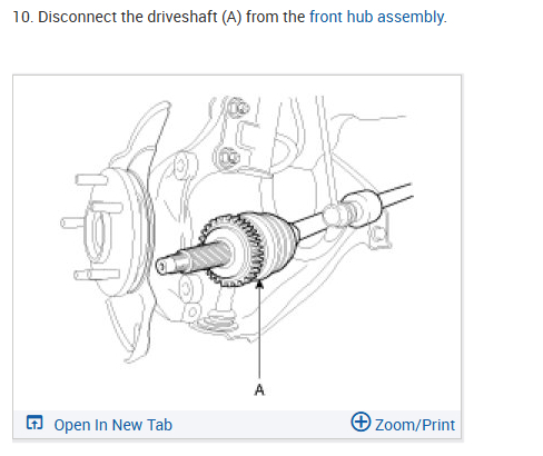

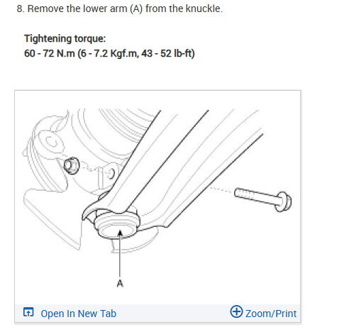

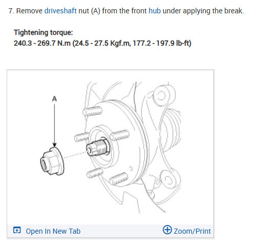

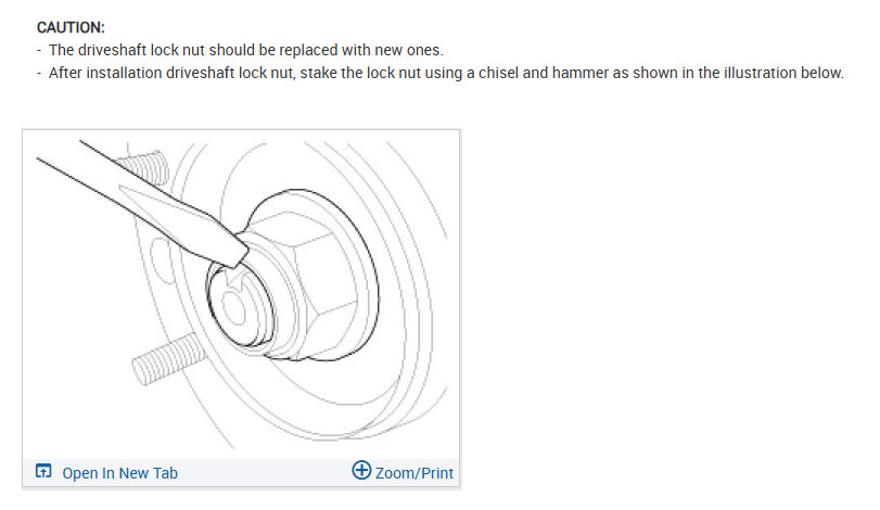

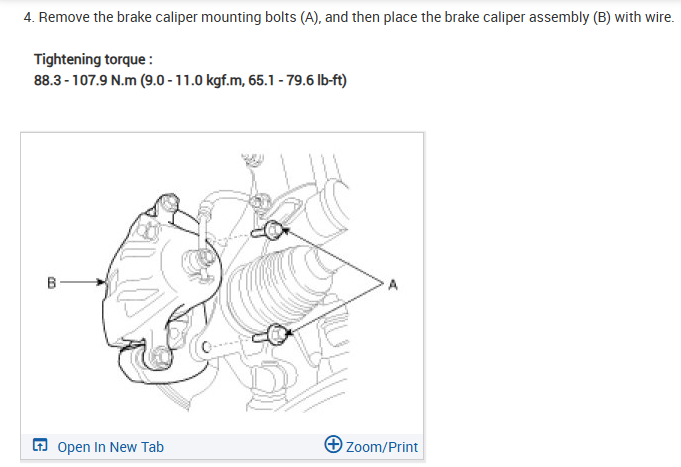

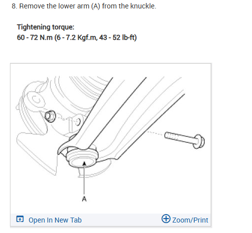

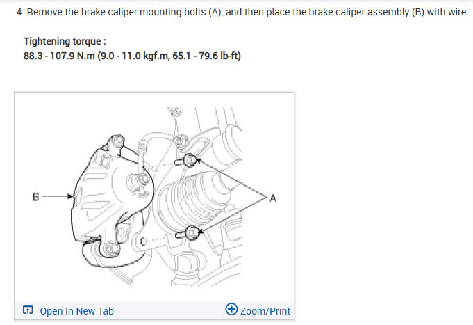

Yes, you need to remove the wheel. Then you will see the hub nut. That needs to be removed, along with a few other things, to remove the CV axle.
I attached the directions for removing the axle below. Please review them and let me know if they help or if you have questions.
See pics below.
