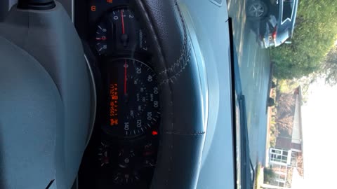

ready to drive off and car put into drive it stalls
2006 NISSAN ARMADA
184,565 MILES • V8 • 4WD • AUTOMATIC
JOVANIHERRERA0323
  • 17 POSTS
When ready to drive off and car put into drive it stalls or takes up to three or longer to kick in. i just want to fix it or if it's the transmission to get another one. someone told me it is the sensors not the transmission. it goes in reverse and park but stalls on drive.

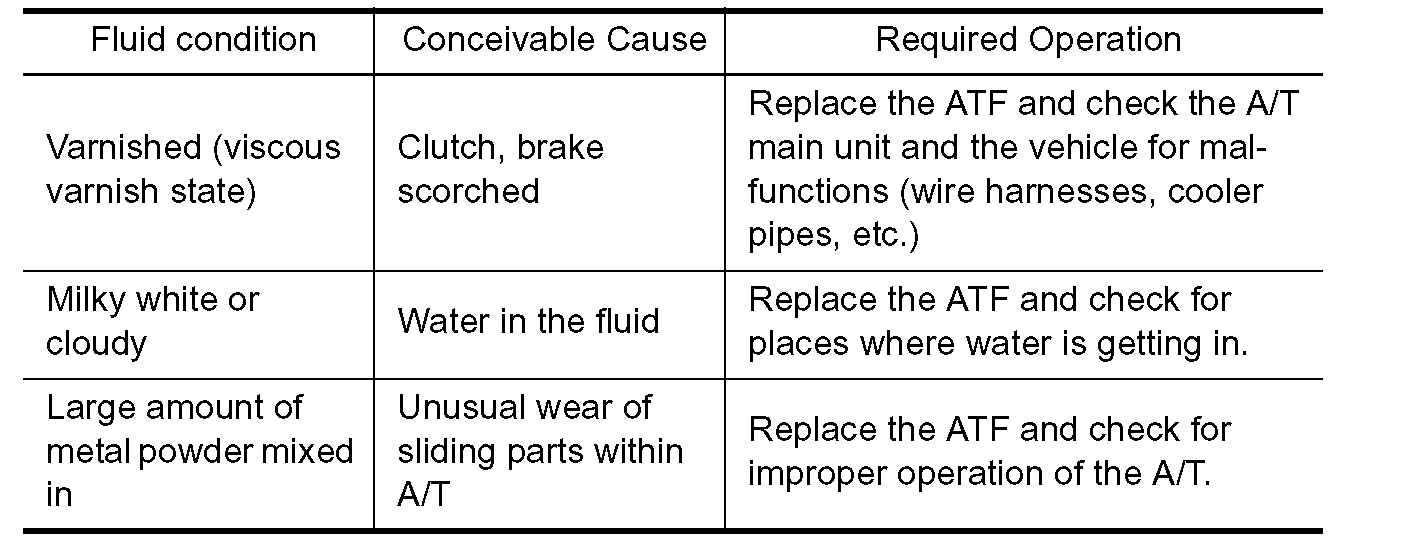

Fluid Condition Check
see pic 1
see pic 2
Inspect the fluid condition.

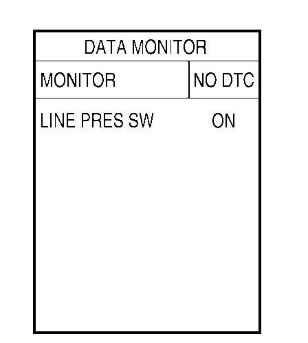

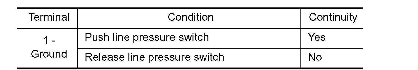

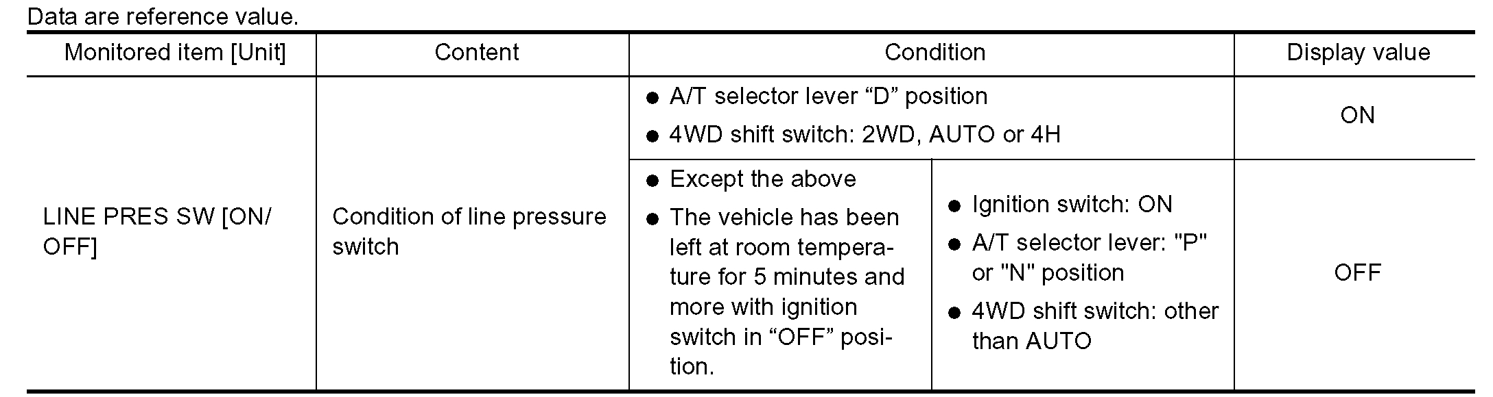

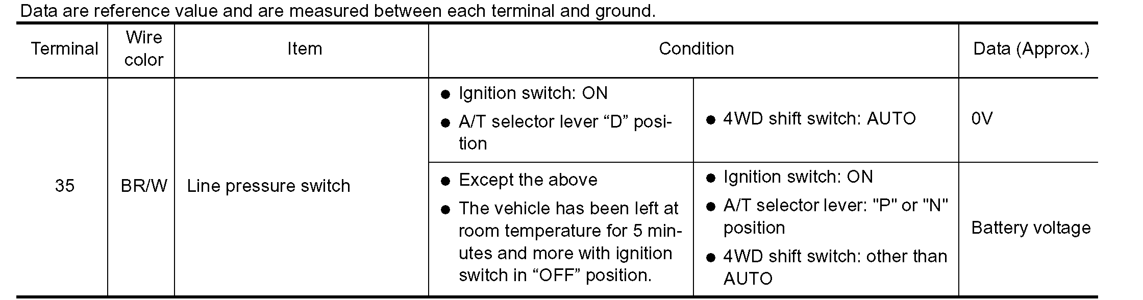

It sounds like it is related to a line pressure issue. There are a few electronics such as a line pressure switch. Based on what you are describing, it sounds like the pressure is low.
What needs to be done is a line pressure test. Here are the directions for doing it, but it is somewhat involved. Take a look through them and let me know if it is something you are comfortable doing. The attached pics correlate with the direction. It does require a scan tool and basic electrical testing equipment. Here is a link you may find helpful:
2006 Nissan-Datsun Truck Armada 4WD V8-5.6L (VK56DE)
Line Pressure Switch
Vehicle Transmission and Drivetrain Transfer Case Testing and Inspection Component Tests and General Diagnostics Line Pressure Switch
LINE PRESSURE SWITCH

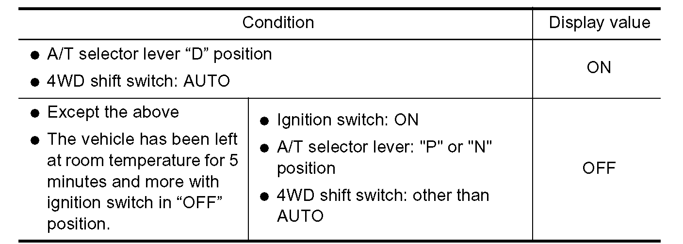

CONSULT-II REFERENCE VALUE IN DATA MONITOR MODE
pic 1
TRANSFER CONTROL UNIT TERMINALS AND REFERENCE VALUE
pic 2
CAUTION: When using a circuit tester to measure voltage for inspection, be sure not to extend forcibly any connector terminals.
DIAGNOSTIC PROCEDURE
1. CHECK LINE PRESSURE SWITCH SIGNAL
With CONSULT-II
1. Start engine.
2. Select DATA MONITOR mode for ALL MODE AWD/4WD with CONSULT-II.
pic 3
3. Read out ON/OFF switching action of LINE PRES SW while operating 4WD shift switch.
pic 4

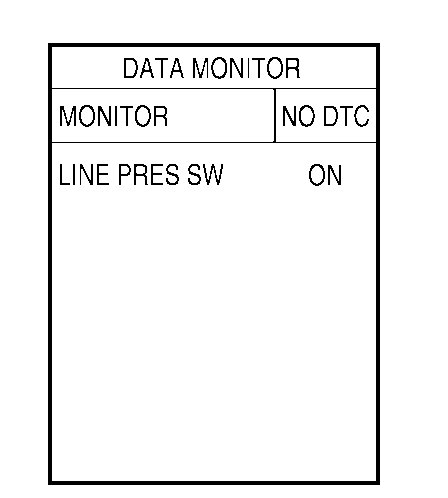

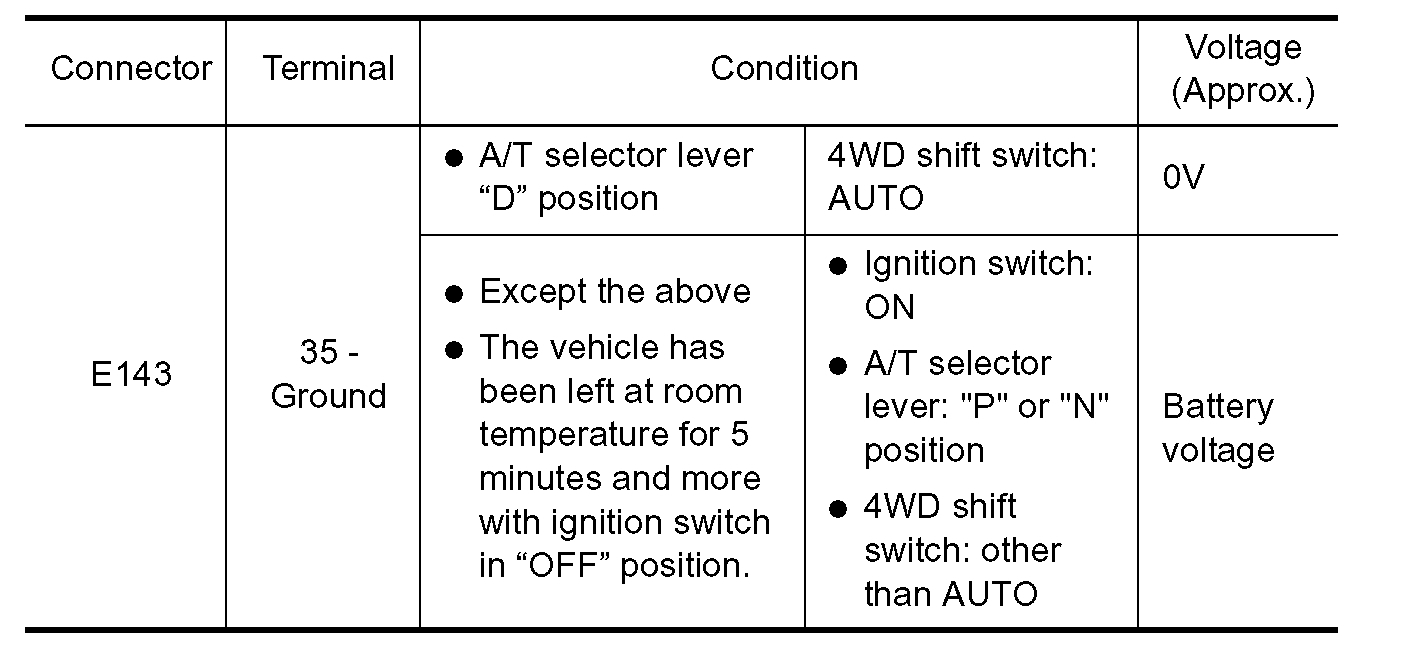

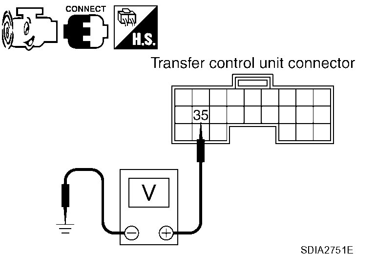

Without CONSULT-II
1. Start engine.
pic 5
2. Check voltage between transfer control unit harness connector terminals and ground.
pic 6
OK or NG

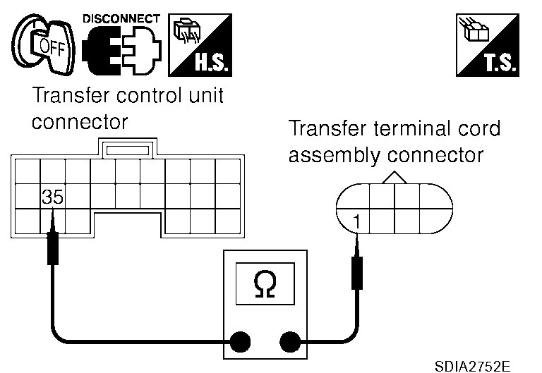

2. CHECK HARNESS BETWEEN TRANSFER CONTROL UNIT AND LINE PRESSURE SWITCH
1. Turn ignition switch OFF. (Stay for at least 5 seconds.)
2. Disconnect transfer control unit harness connector and the transfer terminal cord assembly harness connector.
pic 7
3. Check continuity between transfer control unit harness connector E143 terminal 35 and transfer terminal cord assembly harness connector F56 terminal 1.
Continuity should exist.
Also check harness for short to ground and short to power.

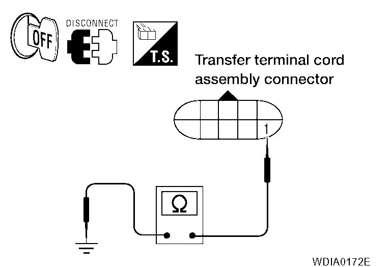

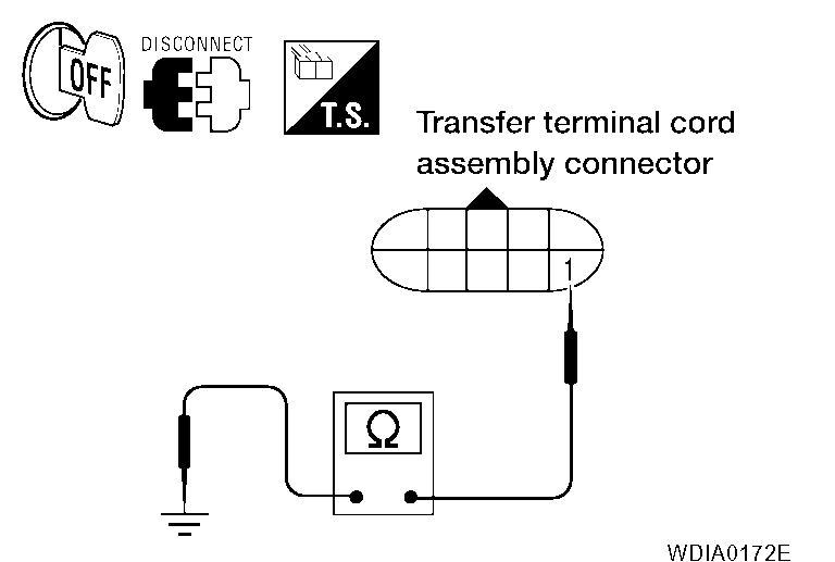

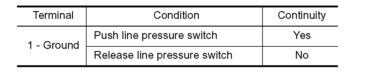

4. CHECK LINE PRESSURE SWITCH
2. Remove line pressure switch.
pic 8
3. Push and release line pressure switch and check continuity between terminal 1 and ground.
pic 9
OK or NG
OK >> GO TO 5.
NG >> Replace line pressure switch.

COMPONENT INSPECTION
pic 10
pic 11
