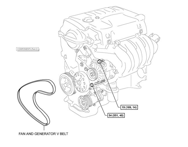

It sounds like the belt is weak causing the belt to make noise at wear out premature. Here is a guide to help you get an idea on what we are talking about. If they do not re-tension the belt after the first installation it will go bad .
https://www.2carpros.com/articles/replace-serpentine-belt

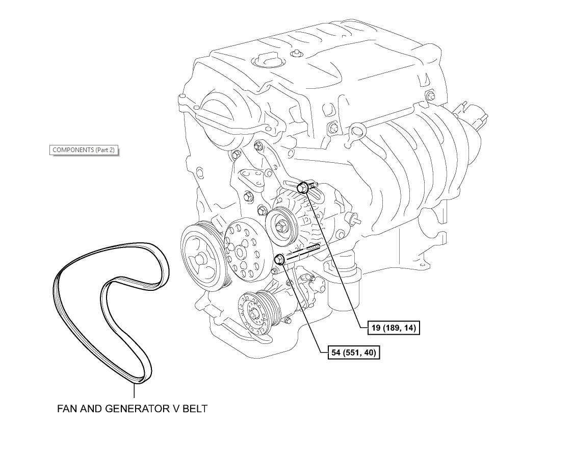

Here is a diagram (below) of what it will take on your car.
Use Bando belt, cheap belts fail quickly.
