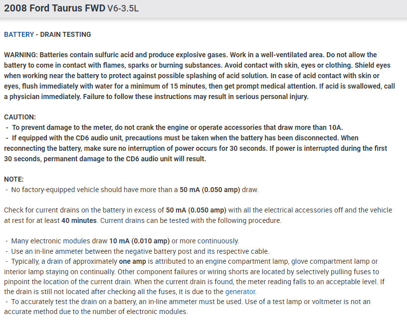

You have a parasitic drain on the battery. You need to check for the circuit that is causing the drain.
You need to remove the negative battery cable and put a voltmeter in line. Red lead on the battery post and the black lead on the cable. Set the meter to DC amps and wait for thirty minutes. Then see what reading is on the meter. It should be 50-75 milliamps.
If it is more, then remove fuses one by one until the draw drops to the specs. when it does then you know the circuit that is causing the drain.

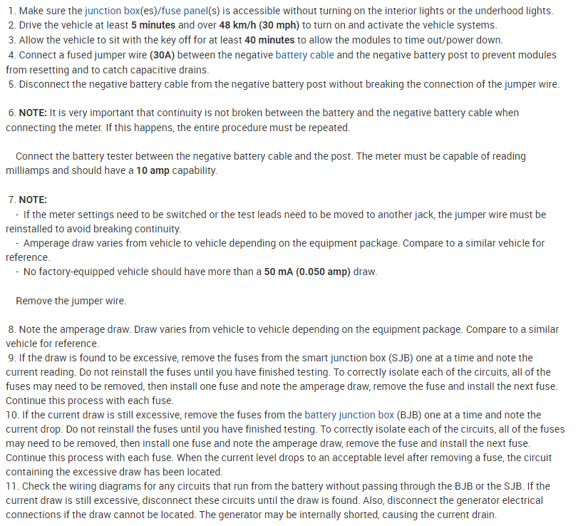

I have also attached instructions (look below) on how to do the testing.
Please follow those steps and let me know if you have any questions.

I attached a guide for you to view for the parasitic draw.
Put your amp meter in line with the negative cable and check the draw. Pull each fuse one at a time until the draw goes down to 50-75 milliamps. Then you will know the circuit that is causing the draw.

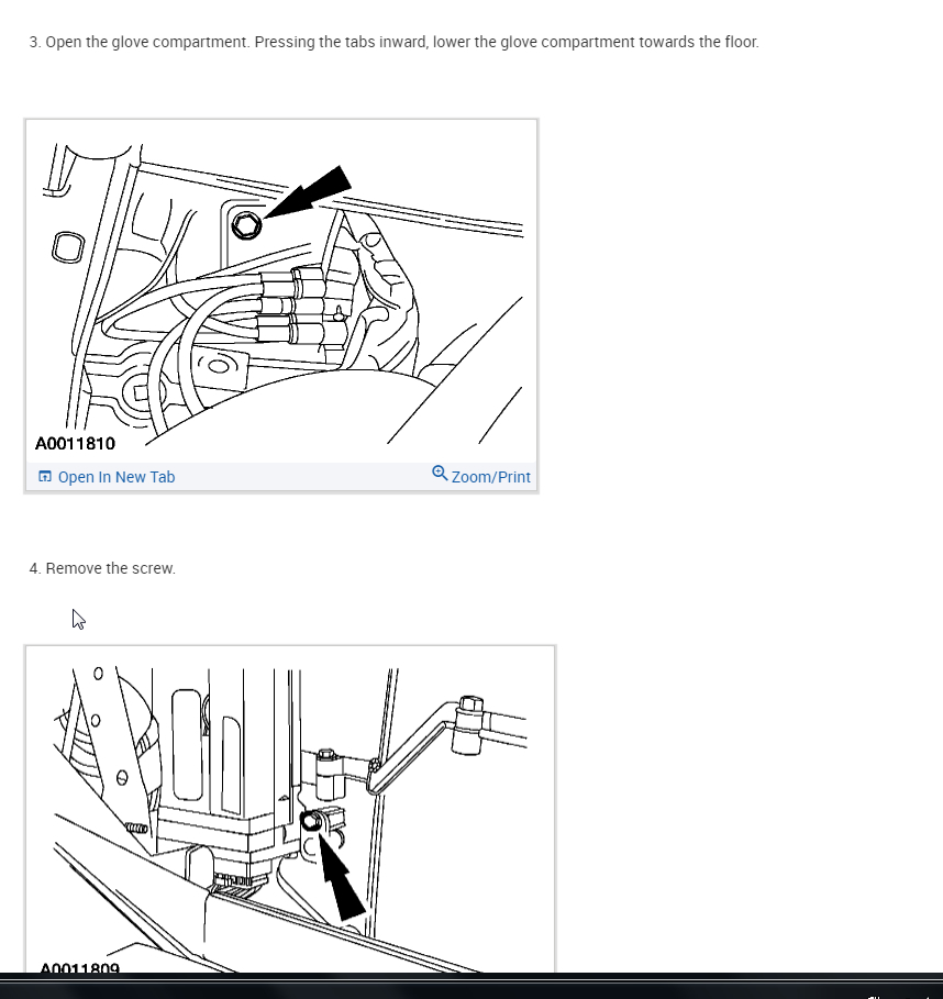

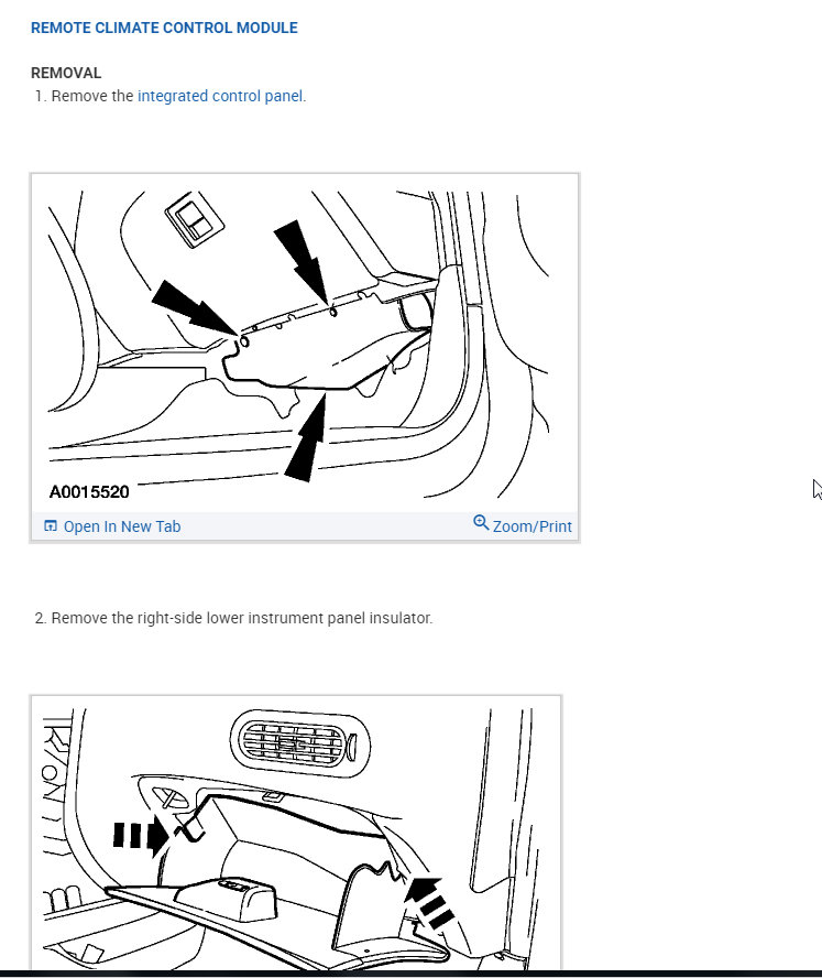

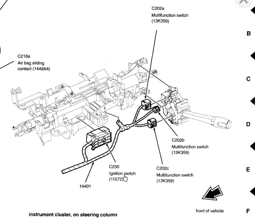

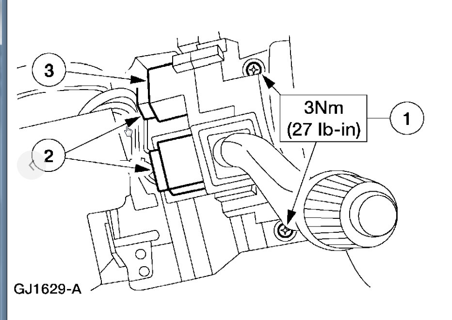

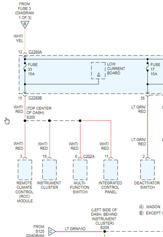

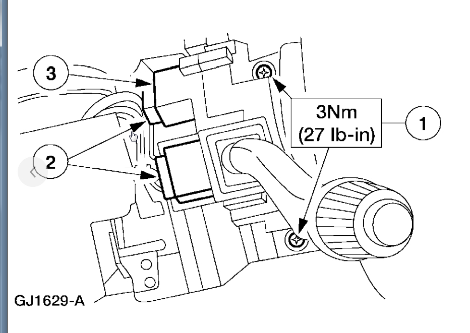

Using a test light I narrowed down the drain to fuse F2.33. The problem is that I don't have a clue where to go from here to isolate the drain. The fuse covers five circuits: Remote Climate Control module, Instrument cluster, Multi-function switch, Integrated Control Panel, and Smart Junction Box. Other than the instrument cluster, I don't even know where to look for the other four. Can you help me?
Jul 28, 2021 at 1:50 PM (Merged)

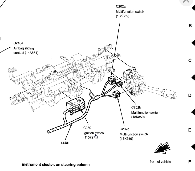

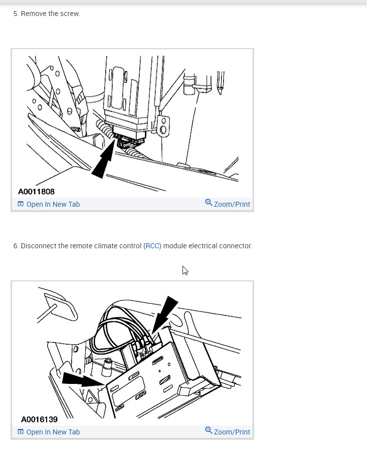

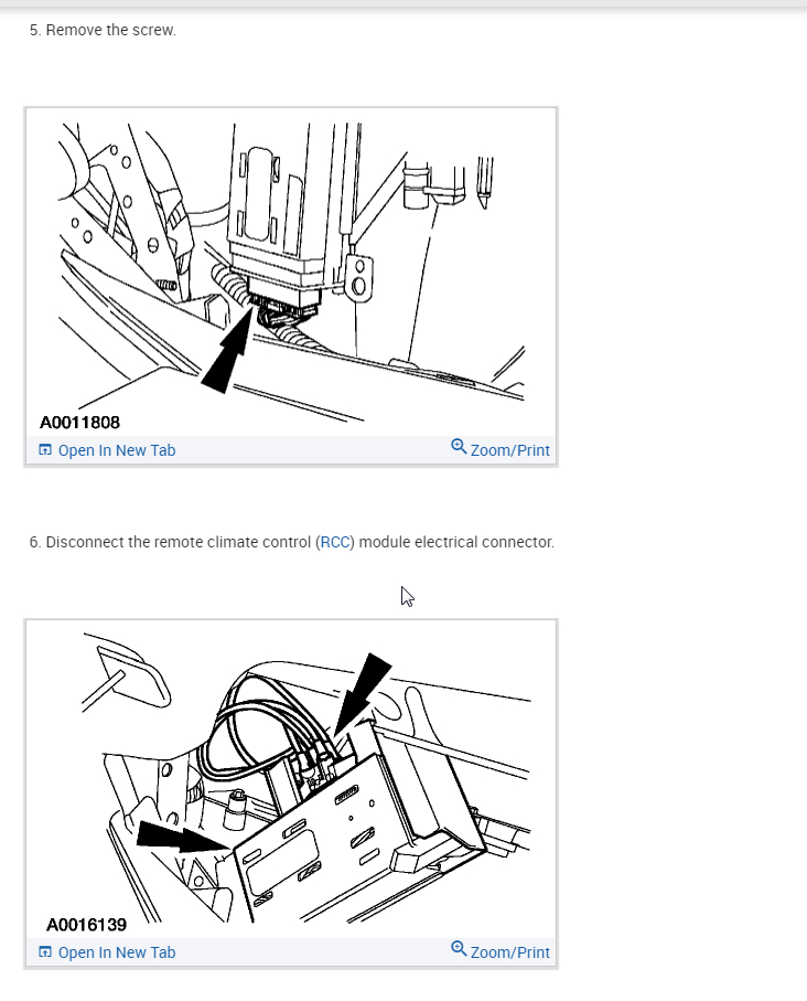

So the way to find the draw at this point is to monitor the off draw amps by hooking the meter inline with the negative battery terminal. Then you will want to go and unhook each of the components on this circuit. You are correct with each one of them.
The multifunction switch is the turn signal switch on the left hand side of the steering wheel.
The cluster is all the gauges which I think you are aware of.
The integrated control module is part of the cluster. It is its' own component but is not serviceable separate.
The junction block is where the fuse is located.
I suspect you have an issue in the cluster so I would unplug it and see if the draw goes awy. If not then you need to move on back again I would start with the cluster.
Let me now if there are questions. Thanks

Battery drain, drawing .4a (400ma) w/everything off & waiting 45mnts for electrical modules etc. to go in "sleep" mode.Isolated draw to
battery saver relay and fuse . Draw drops to .16-.18a when removing fuse.Swapped relay same results also can hear relay click on when
putting fuse back in. Ruled out dome light as culprit.Could the power window motors be causing drain even w/ ignition off? Could the GEM
behind fuse block in cabin be the problem and is there a way to test it? Trunk light is on different circuit and amp draw is normal when trunk closed. Is there other components on this circuit besides dome light and power windows? Thank you in advance for any guidance in resolving
this issue
Jul 28, 2021 at 1:51 PM (Merged)
400 milliamps is not bad draw considering all the items needing battery power.
