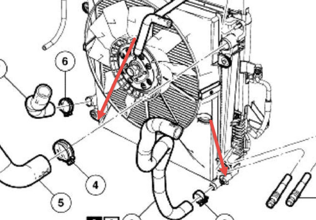

I cannot seem to find the drain plug on the radiator.

they do not show a good picture of a drain cock on radiator and Ford supplies the same thing in their manuals. see picture if you cannot find it pull lower radiator hose. Check out the diagrams (Below). Please let us know if you need anything else to get the problem fixed.
