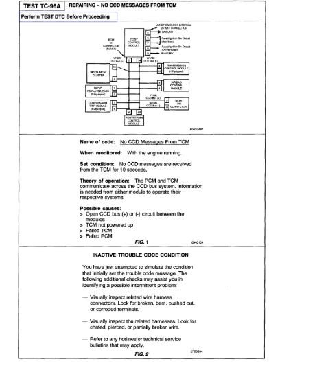

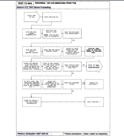

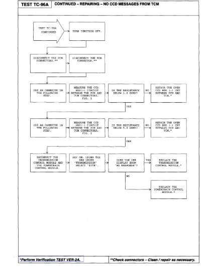

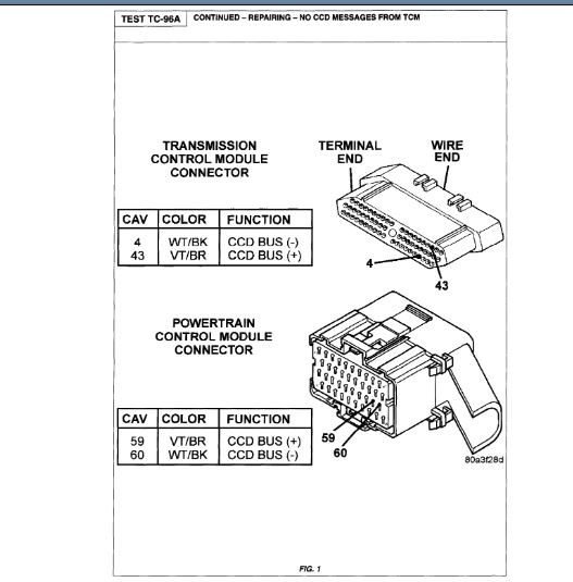

I found the 1698 code but there is no 1776 code. Can you verify that code?
The 1698 is a serial data code for communication between the ECM and the TCM.
