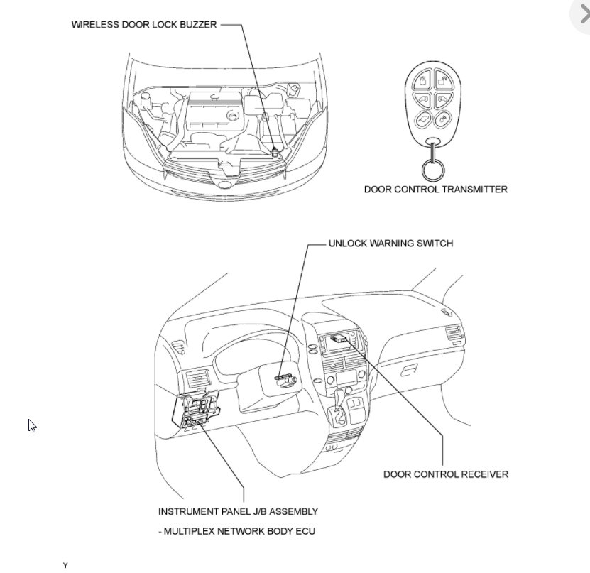

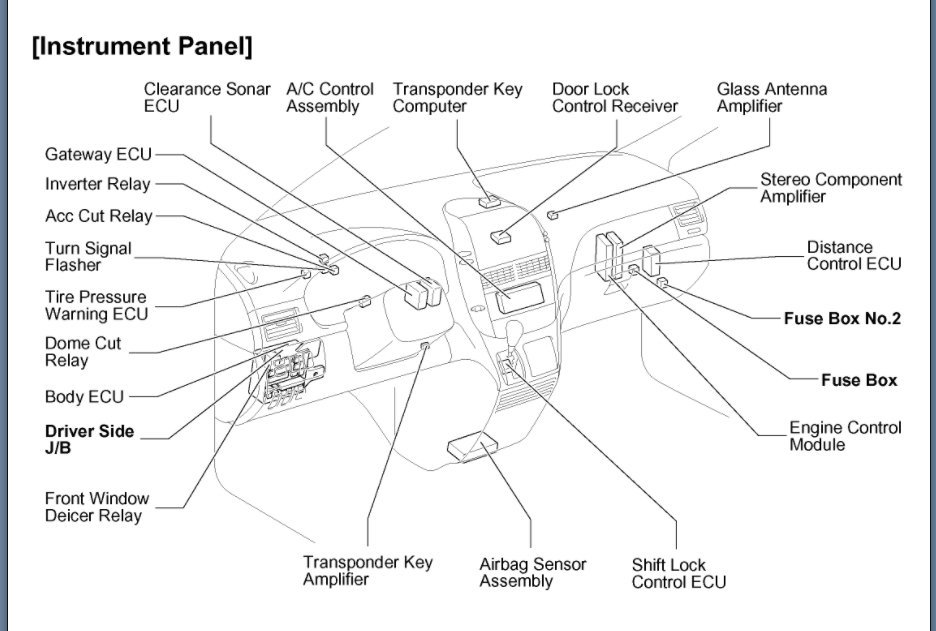

I need to know where the door lock receiver is under dash
2008 TOYOTA SIENNA
103,940 MILES • 3.5L • 6 CYL • 2WD • AUTOMATIC
JABEZ1
  • 11 POSTS
I need to know where the door lock receiver is under dash. Also, i took it to a dealer it's going to cost around $1,300.00 to get a new door lock control receiver installed. can i just unplug the receiver? will that cause any other problem other than not having electric door locks? i can get one from eBay under $100.00, it will have to be programmed at dealer. i can live without electric door locks. Part # is 89741-AE010. thanks. also, i have a remote start on van the lock and unlock works fine with that remote.
Dec 22, 2020 at 6:12 PM

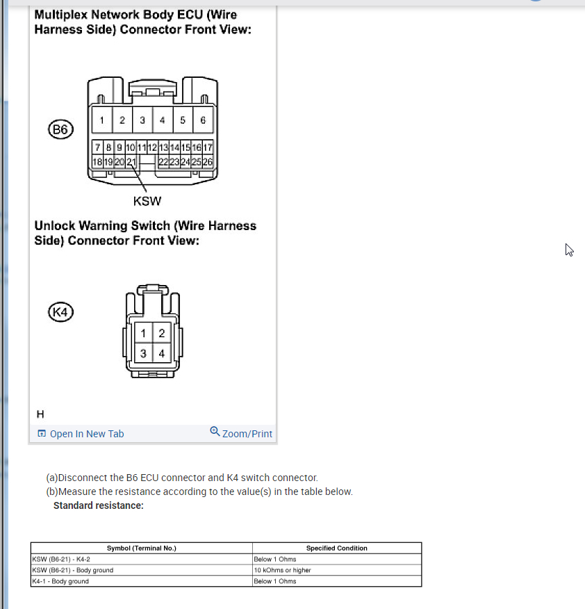

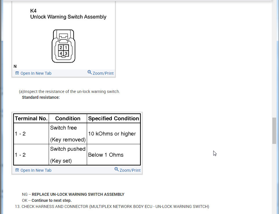

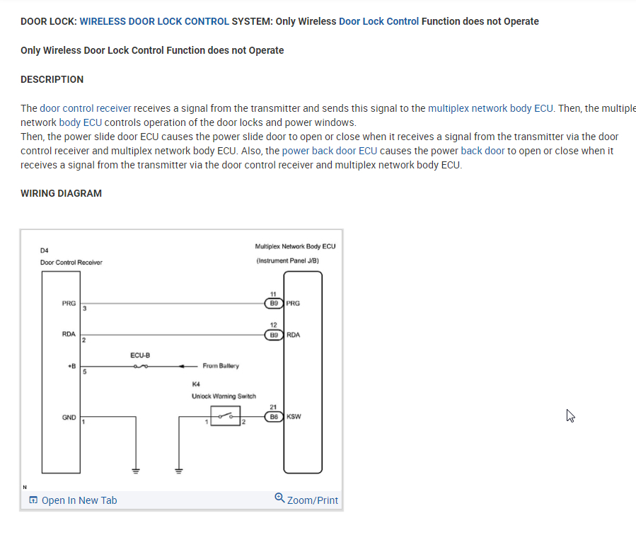

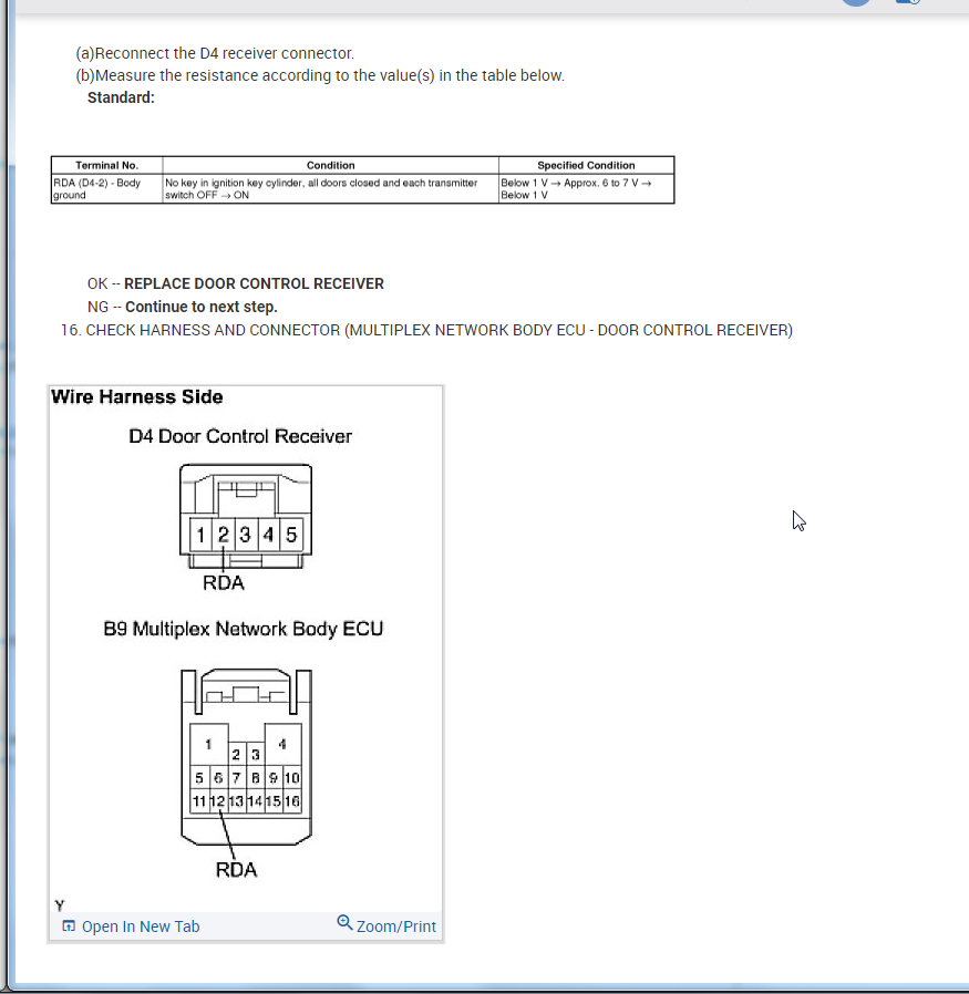

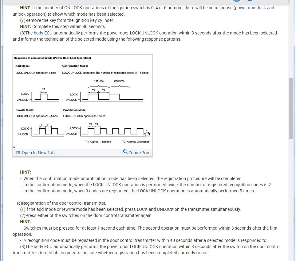

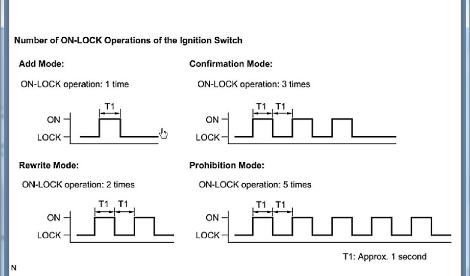

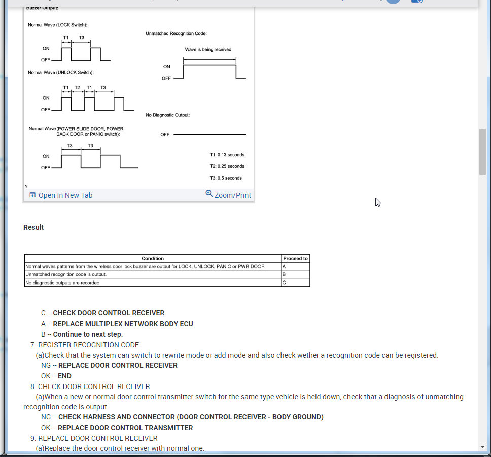

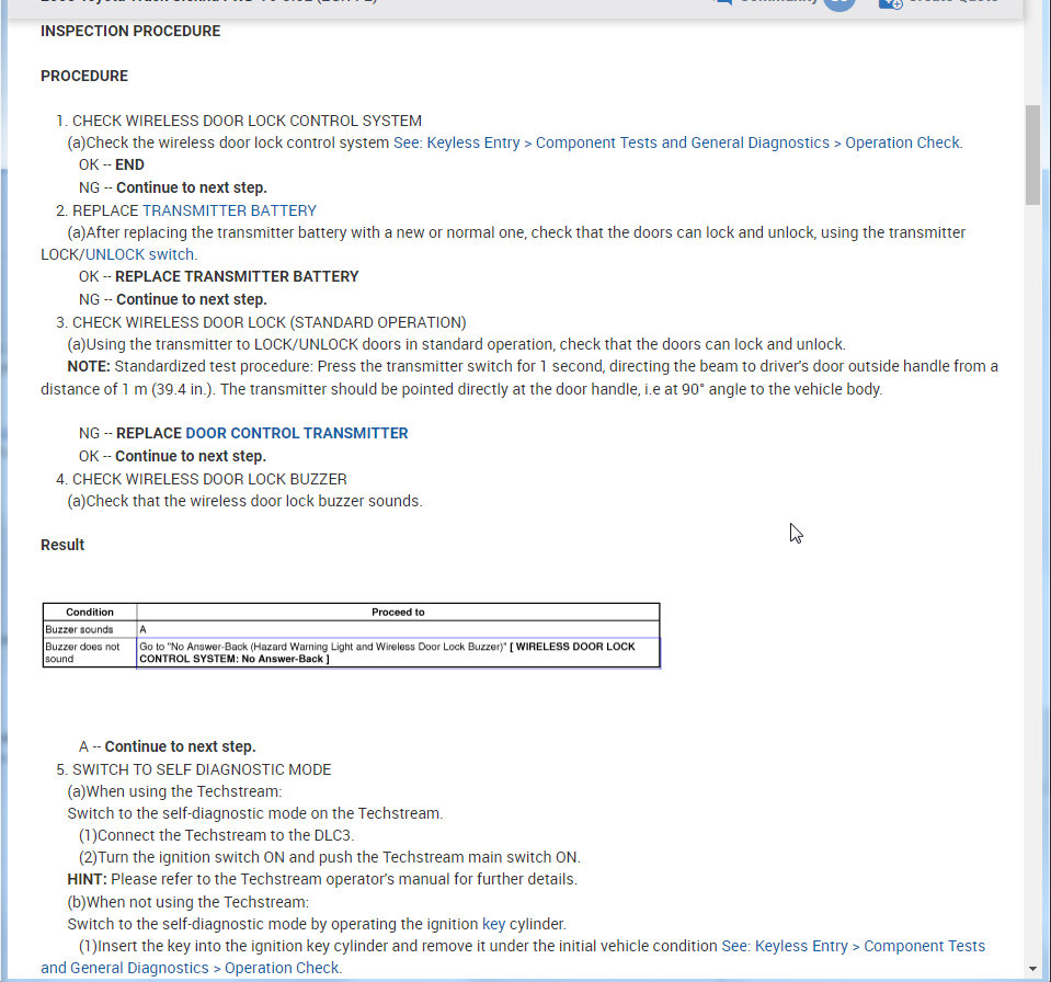

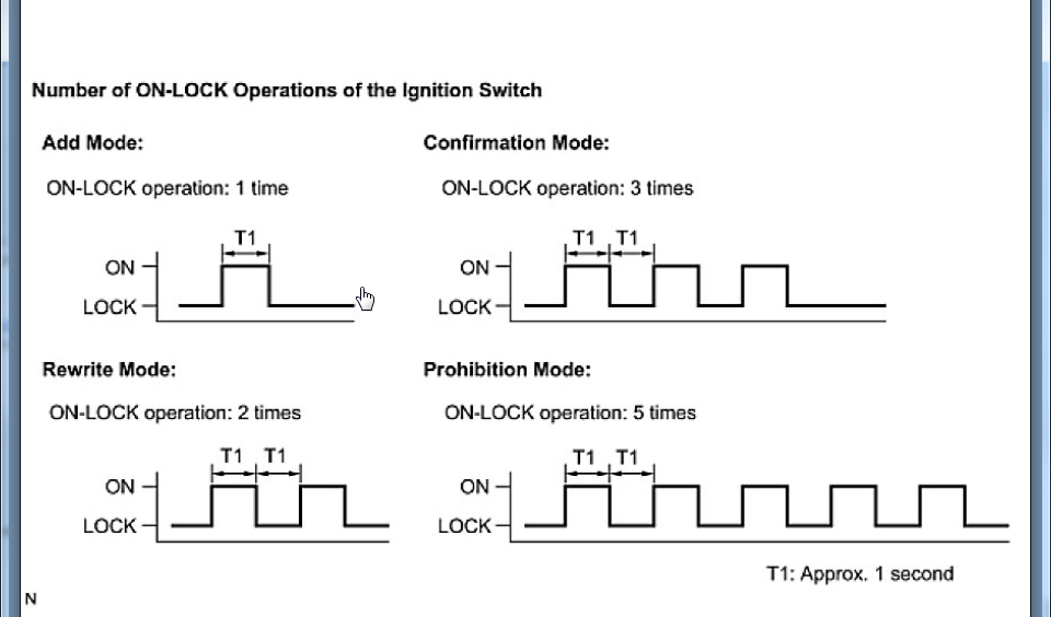

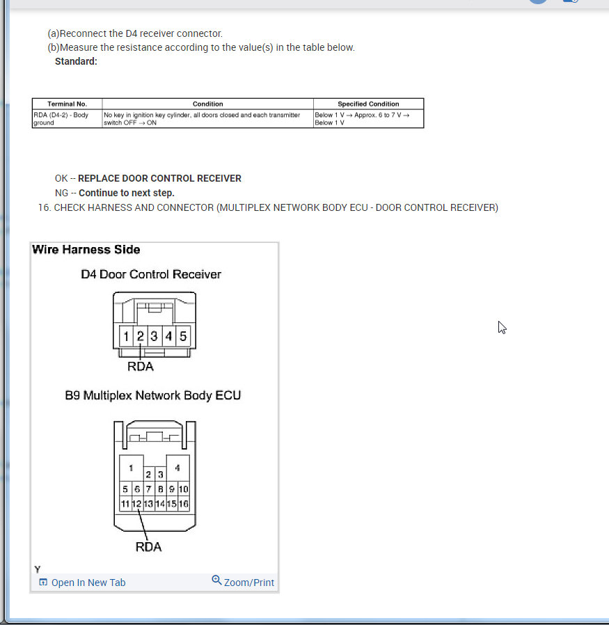

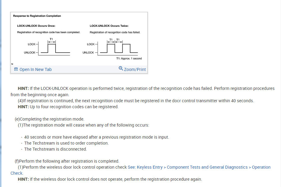

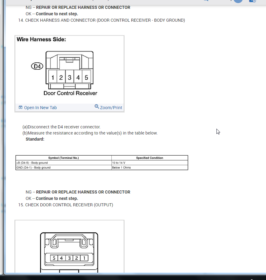

I am attaching the location below on the location. However, I am also attaching the testing of this system if you would like to confirm this is the issue however it sounds like you have a pretty good idea that this is the issue.

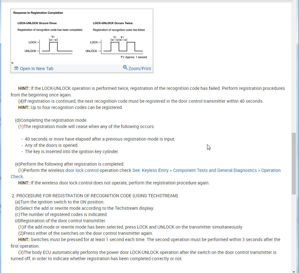

The manual does not specifically state that you have to program it and they do not give a process for the replacement procedure, so I cannot confirm this for you. I have not replaced one of these parts before so I am not sure. However, in most cases the receiver does have to be programmed so that it recognizes the key that is inserted as being correct.

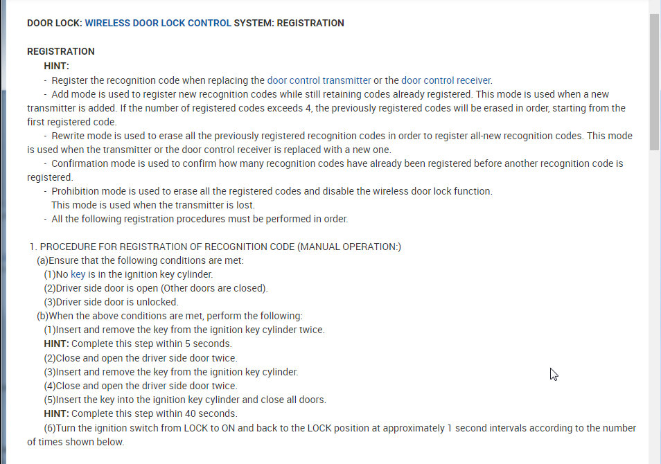

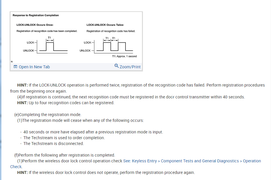

I am attaching also, what I am looking at to say this which is the registration process for this entire keyless system and it does not list this module.
Let me know what questions you have. Thanks

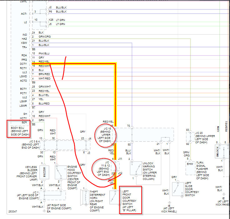

Okay. With that information this is possibly a body controller because the door switches are a direct input to the body computer. Then the body computer tell the cluster to turn the light on.
So what we need to do is go to the body computer and test the inputs from the sensors to see if they are getting voltage. These are simple open closed switches. So if there is voltage on the circuit at the body computer then the switch is closed telling the BCM that the door is open. This is not a typical voltage test because the switch closes to provide ground so if you test this by putting one lead on the wire and the other on the ground then you will get voltage and think the switch is the issue. So you need to use a test light or a voltmeter and put one lead on battery positive and the other on the wire because you want to see if the switch is providing ground when the door is closed.

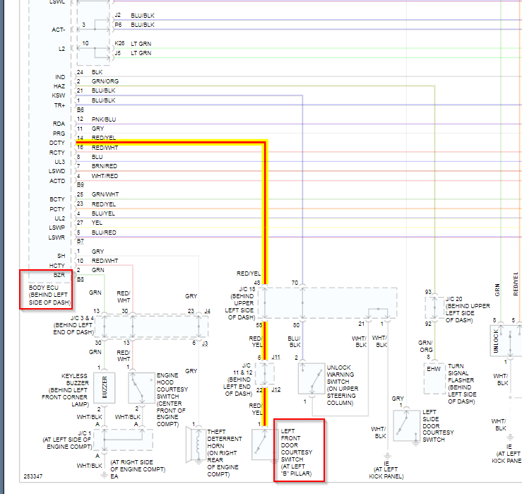

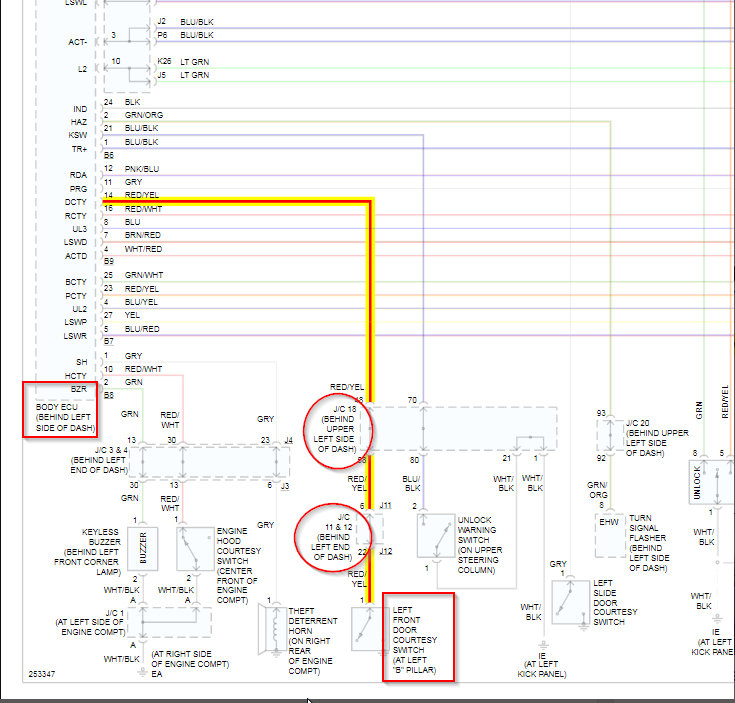

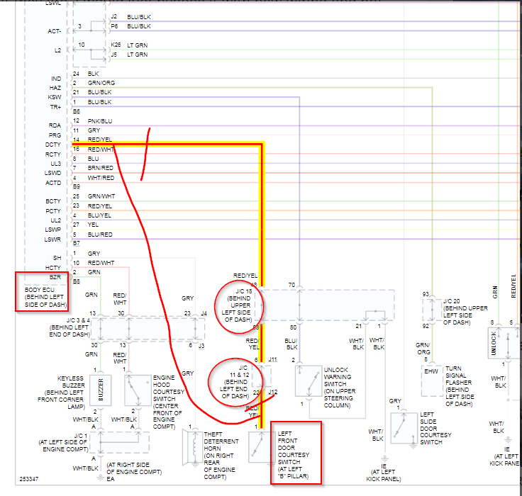

So the way to test this would be to test the voltage on the circuit below by putting your meter or test light on battery positive and then the other end on the terminal at the BCM. There should be voltage there only when the door is open as that is when the circuit is grounded.
The junction blocks are circled and if when the door is open there is no voltage then you have an open circuit somewhere. It could be one of these junction blocks but we need to test voltage going in and out and I bet they did not test it correctly as these are just pass through parts and are not common to fail. Even if they are, I would just bypass it with new wiring and not replace the entire component as it is not needed.

I am not sure I know which fuse panel you are talking about. I was talking about the two junction boxes or panels that are circled. They are like inline connectors and don't have fuses. If it were me, I would just take a wire and cut this wire at both ends and run a new wire from the BCM to the door switch. Even if you just run it straight to it just to test it. If the light goes out then you can route the wire properly. Does that make sense?
Jan 7, 2021 at 6:57 PM

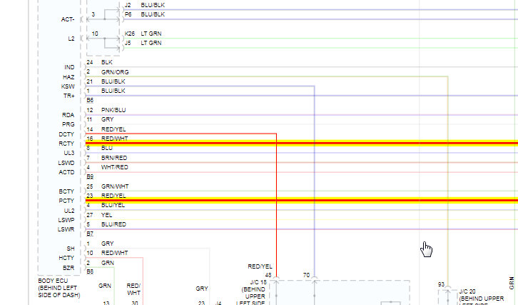

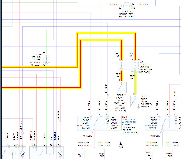

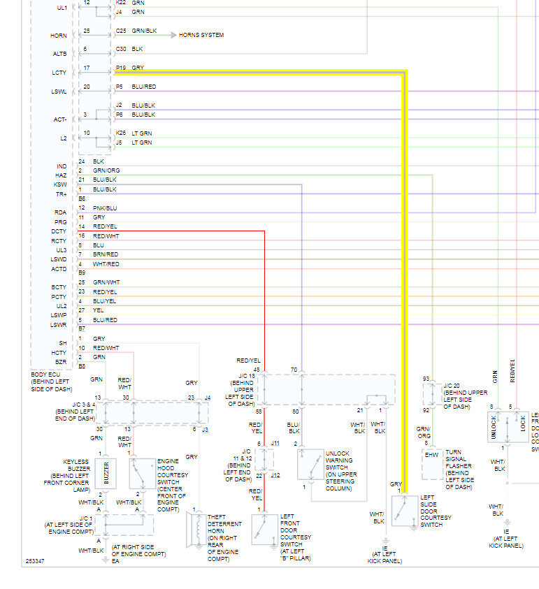

If your short is somewhere on the yellow highlighted line in the last attachment then you would be eliminating it because you are cutting that wire at both ends and then running a new one. Maybe we are talking about two different things. Sorry.
Jan 9, 2021 at 4:53 PM
