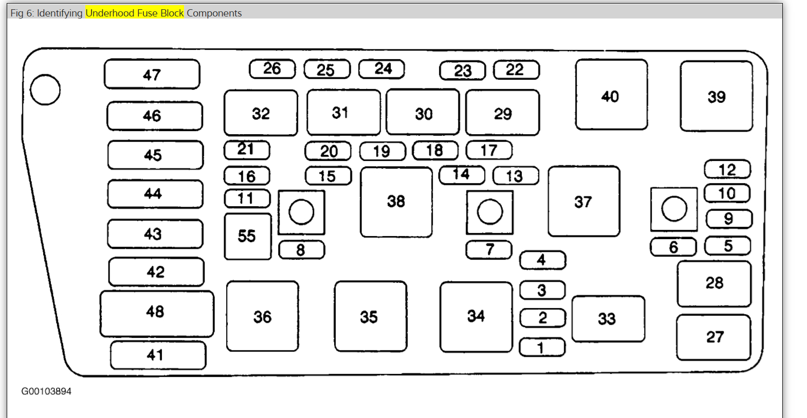

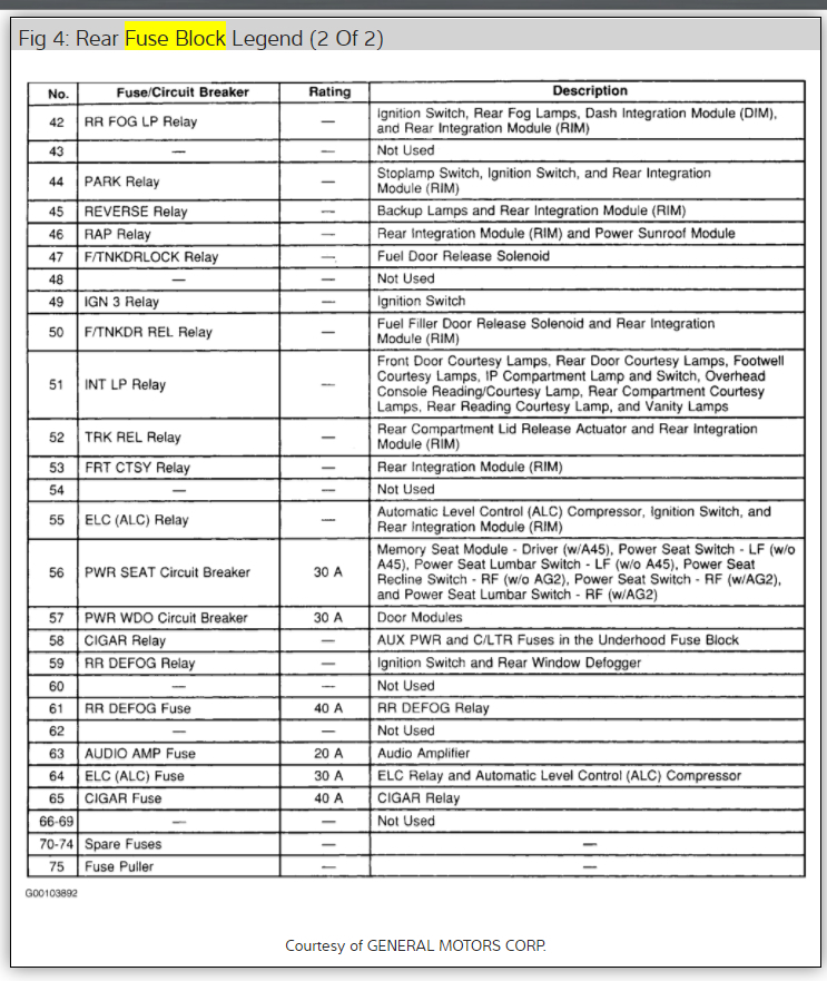

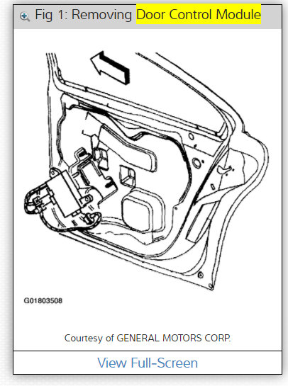

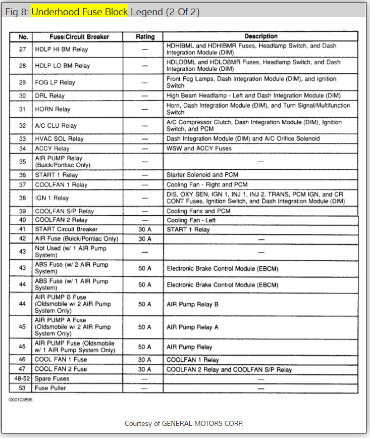

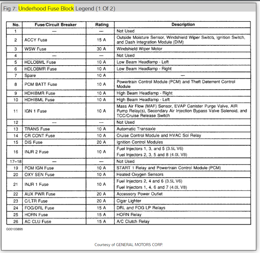

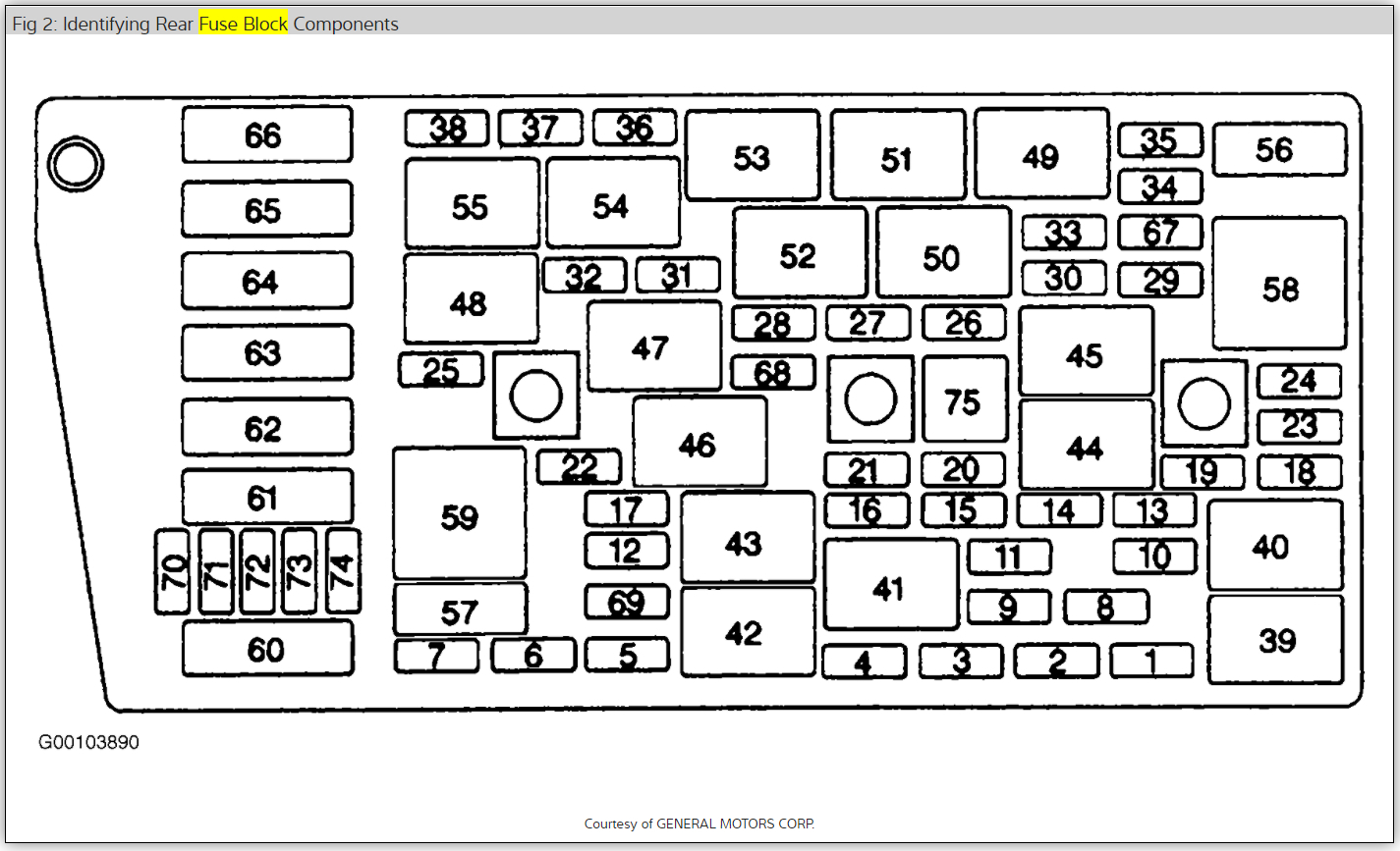

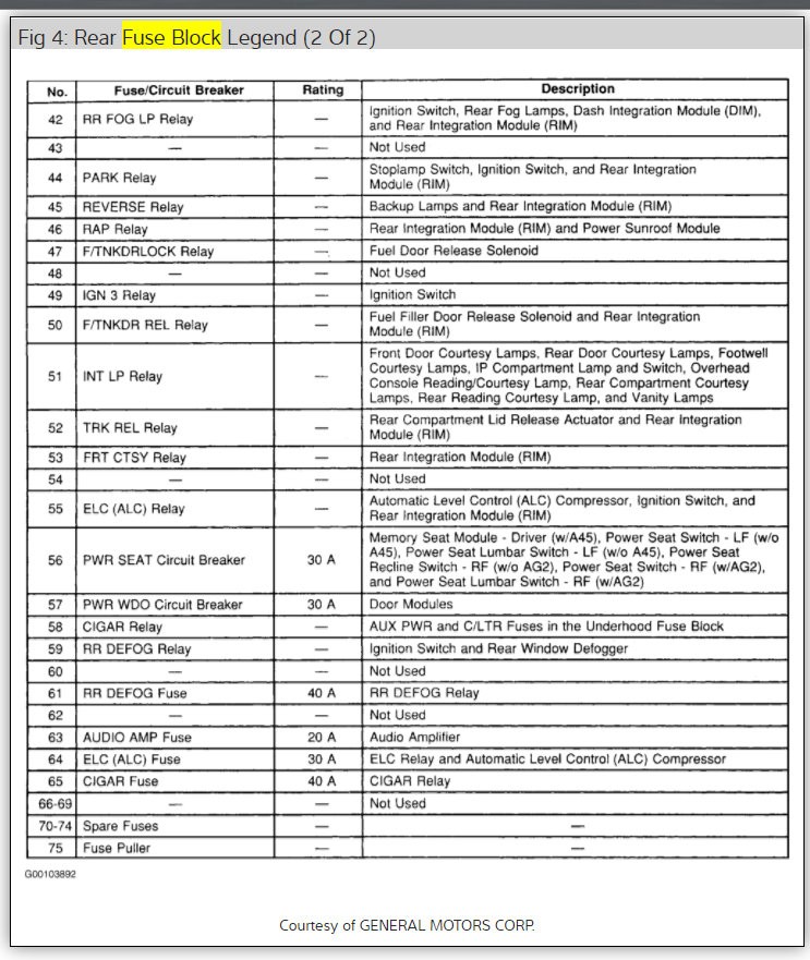

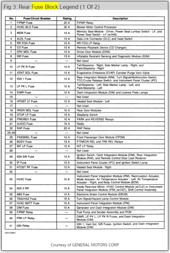

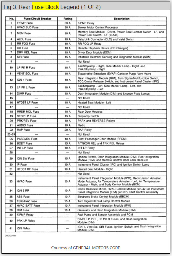

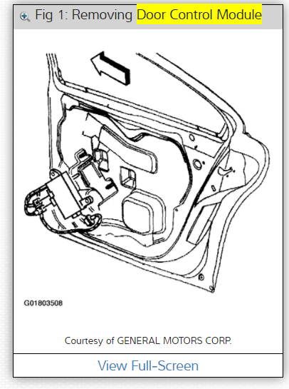

This sounds like a problem with the passengers side door module but to be sure lets take a second and check the system fuses. here is a guide to help show you how to check the fuses. See where the system is losing power my bet is the door module

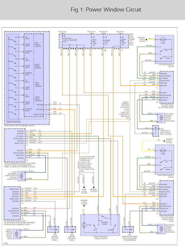

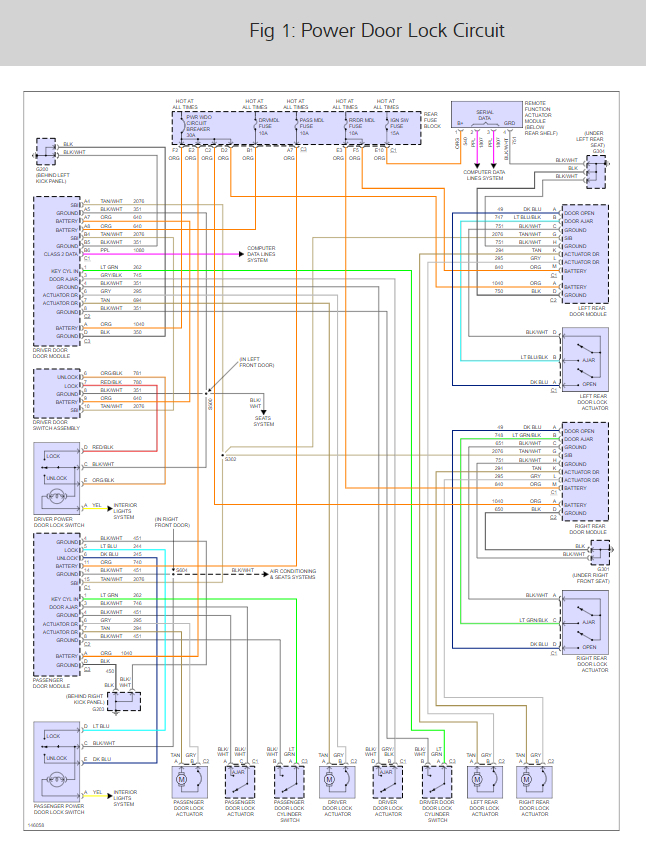

Here are the window and door lock wiring diagrams so you can see how the system works.
Check out the diagrams (below).
