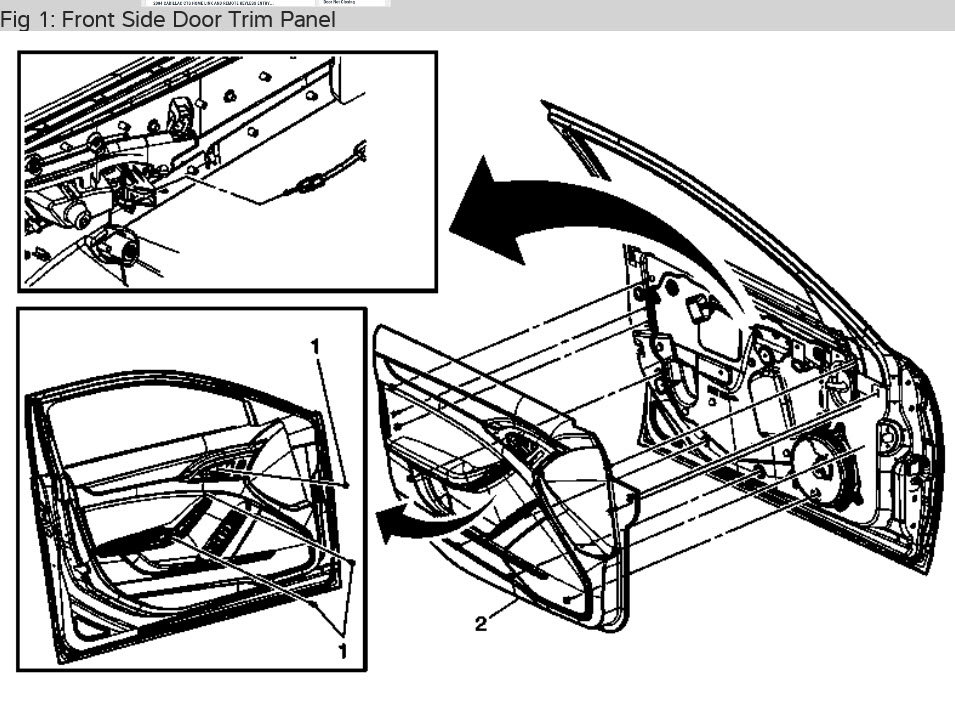

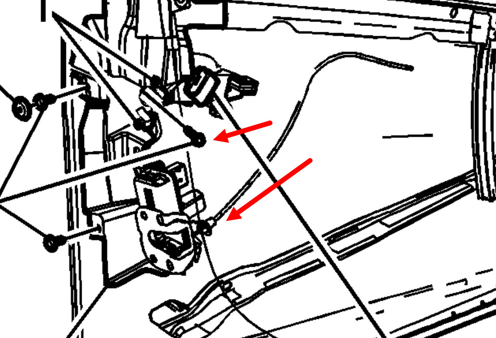

you will have to pull door panel off as you probably broke a clip on door rod or the cable has come off or broken. to open door see picture.

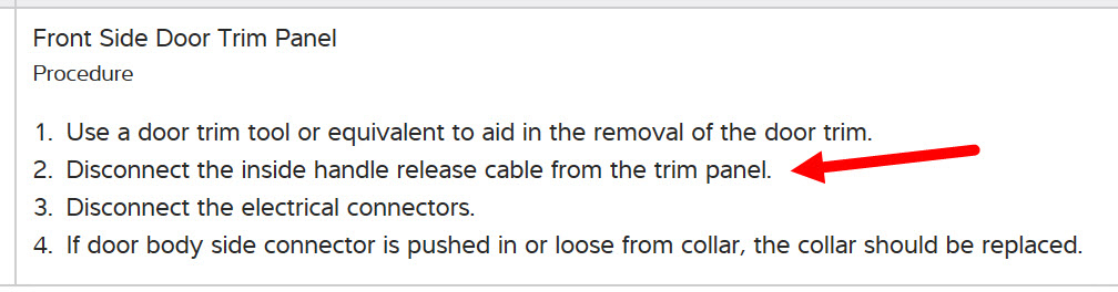

it is not easy because of not much room, see pictures. you might check number two in instructions and see if cable is already released and pull on cable to see if door will open.
