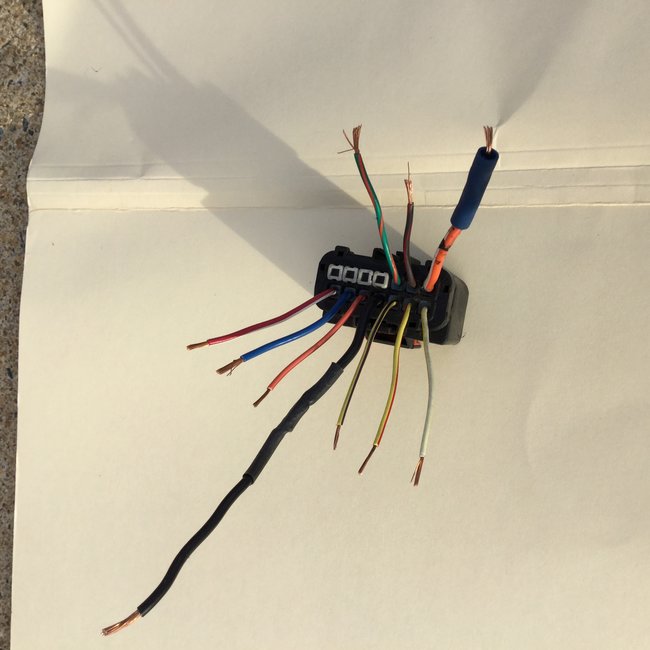

Same decade old problem with door wring breaks. Obtained a donor chassis harness to door, made corrections to broken wires I could meter. Extended the connector into the door, protected wiring with a loom. Driver door sometimes only lock itself, operates from passenger door and fob, same condition with a second extra door module. Cleaned up battery terminals, cycled engine functions. Suspect a wire but cannot correctly identify which color or plug position. Included a picture of original chassis door plug. Thanks,

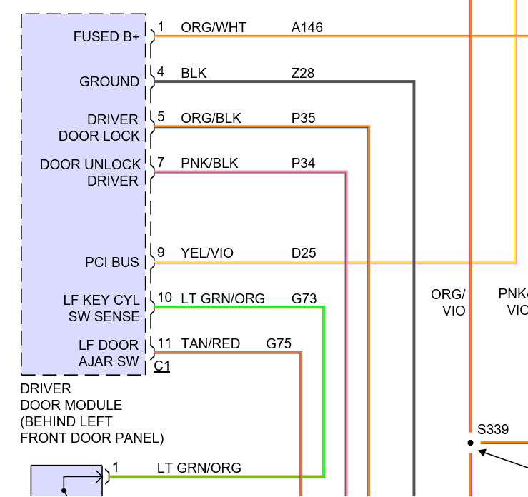

see picture. I show seven wires for Jeep 2004, yours may be for mirror, but with this diagram you should be able to see which wire is where as they are color coded.

It is helpful at the door itself, but that functions OK, the interface to the other door are sporadic. I somewhat suspect a possible broken wire, can I assume the same drivers door lock/unlock entends to the balance of doors? And that would indicate two wires ocasionally working? I made a wire match table from plug to plug. Most were the same colors. Let me check continuity in a failed condition for those wires to see what is ocurring. Thank you so much. Love a challenge,but like to see them end well.

from what you described in question was you wanted wiring harness to driver door or at least that is what I assumed did you want something different?

The chassis portion of the harness, which plugs into to door harness was what i was after.with what you sent I can "make the connection" hopefully by matching wires on the mating connectors. The big problem is the wire break in the door jamb from constant bending. I was replacing the wiring and reducing the bending by creating wire space an less restriction to movement. Something difficult to comprehend with modules, is how the passenger side lock/unlock function can operate the drivers door, while the driver door cannot perform this on the rest of the doors apparently on the same wires (as i can discern) if i have any broken wires remaining. I will have to get to a failure mode, open the door panel and trace wires from the color code provided to the point where i reconnected to the main vehicle harness, to verify wiring. After that, I'm agian lost if continuity exists. I can work from the diagram you provided, unless you have the chassis diagram at the driver's door connection. The pic i sent was the plug and wire colors of that harness. Apologize this is so confusing, been chasing this for a while. Dealerships are not of much help as service writers are not technicians and they do not let you explain needs to the person doing the work. I tend to use independents due to this.

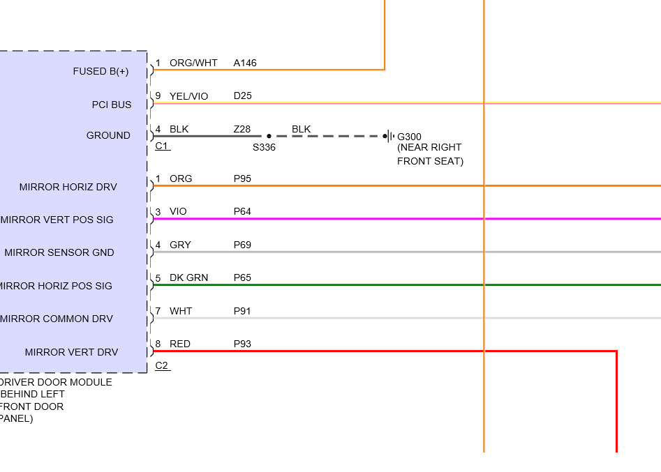

what I sent was for power door locks but this one is for power mirrors so if you have windows that are power they may all lead to same and you SHOULD let us know which is whichlike if yo uhave windows, mirrors etc as they may go to same module but are all broken down separately in manuals. At least in ours so as to not be confusing. so this one is for mirrors.as you will see goes to door module.

I do have mirrors, it is a separete wire from the door mirror to the door control module, of course however the pax door mirror is also controlled throught the drivers door module so the wiring exists. As I continue I will update on either resolution or failure. Thanks
