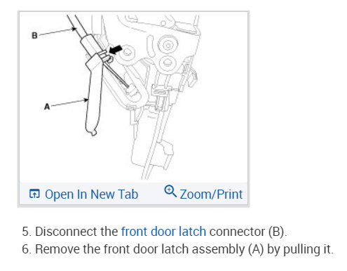

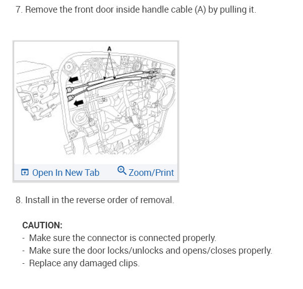

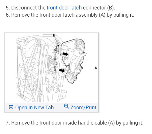

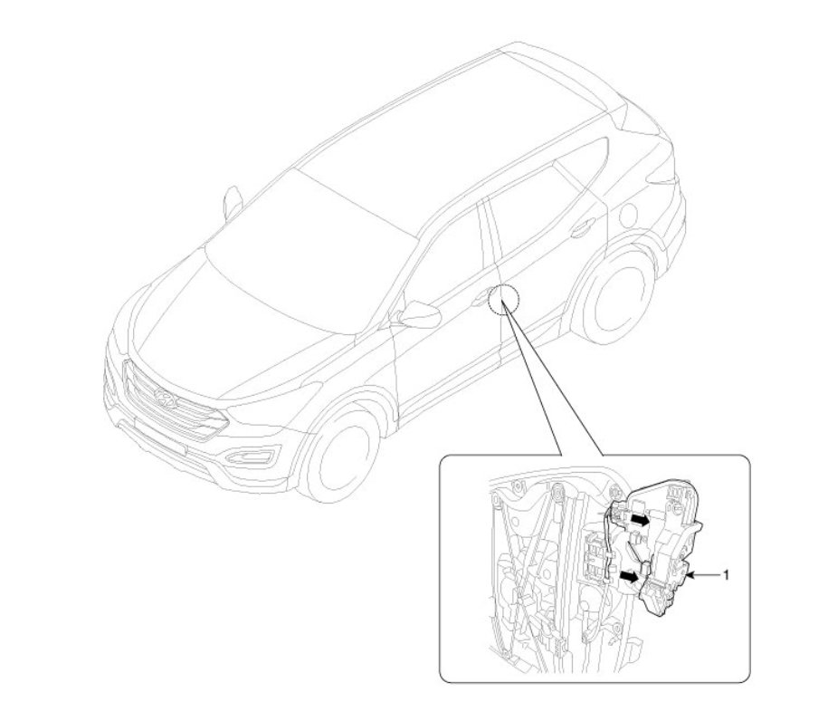

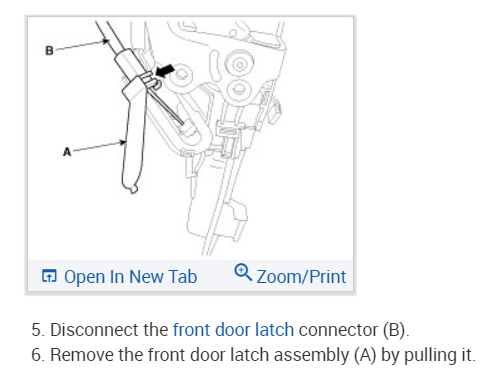

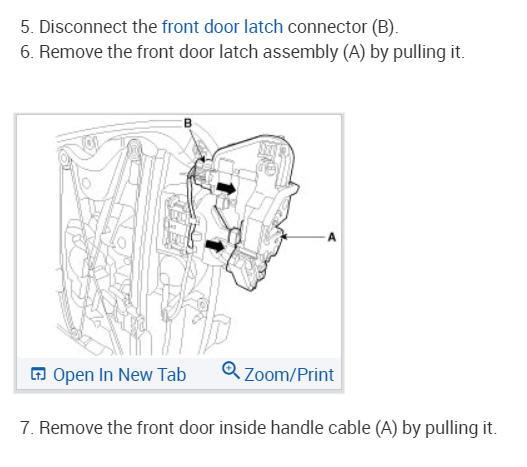

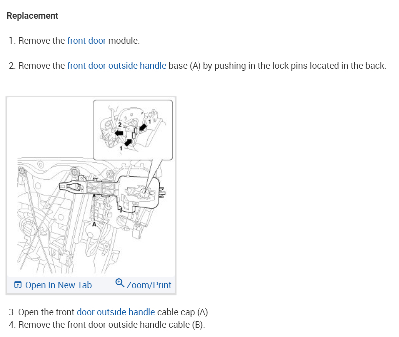

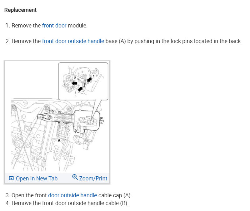

Your vehicle has what is called door control modules. Within the door latch there is a switch that tells the door module if the door is open or closed. On older vehicles there was an actual door ajar switch but your vehicle doesn't show a separate switch which means it is in the latch.
Unfortunately we need to find out which door this is. Does you icon in the dash happen to show each individual door being opened and closed? I don't have the detail on that in the manual. If it has the individual doors on the symbol then with all the doors closed, which one is it showing still opened? Maybe just get a picture of the icon in the dash and we can go from there.
