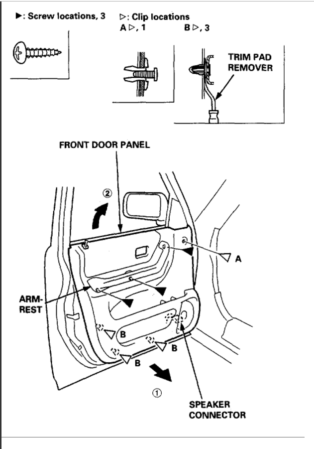

How do you remove the door panel on my car?
Aug 6, 2017 at 7:08 AM
CERTIFIED EXPERT
53,854 POSTS

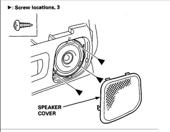

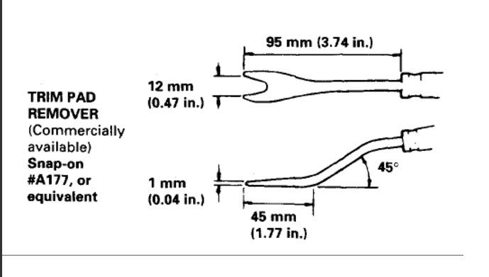

It is not too bad. Here is a guide and some diagrams (below) that will help you get the job done:
https://www.2carpros.com/articles/door-panel-removal
