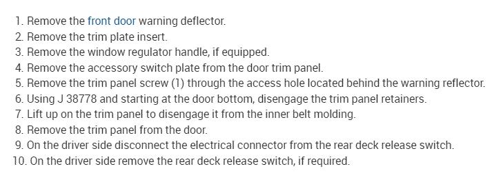

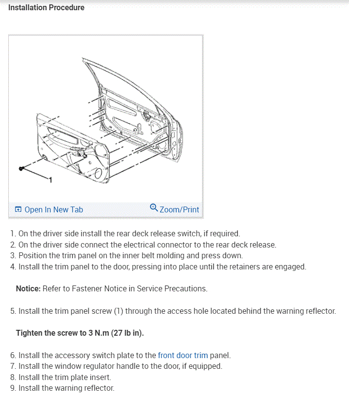

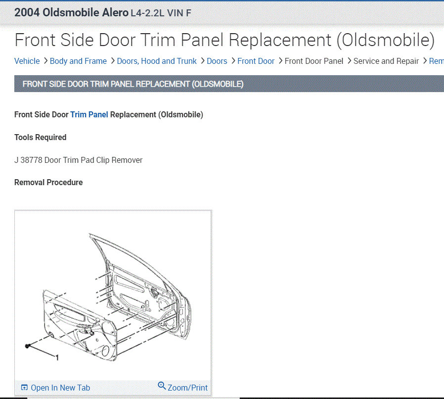

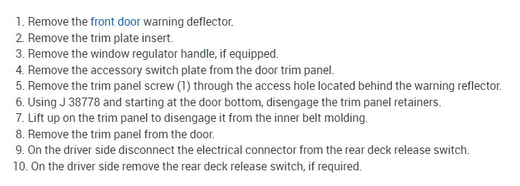

If you look below, I attached the directions for the removal and replacement of the front door panel. There is one screw behind the reflector on the panel and several plastic clips that hold it in place. If you don't have a plastic fastener removal tool, you may want to get one. Otherwise, you may end up with a lot of broken clips.
Take care and Happy New Year,
See pics below.
