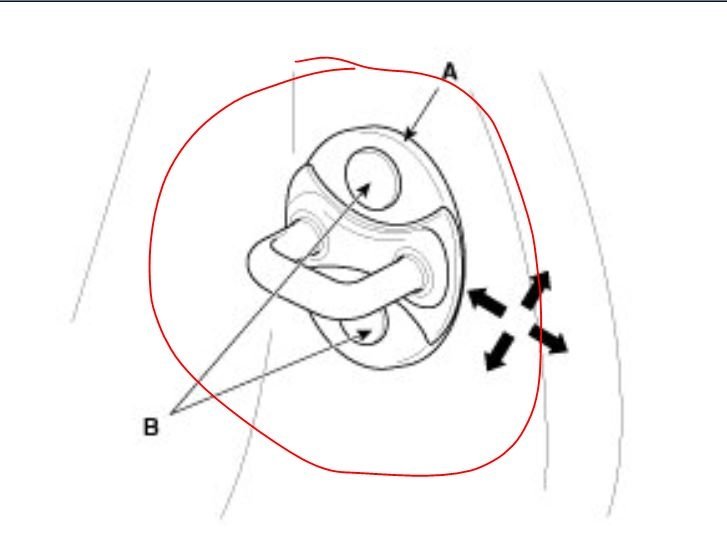

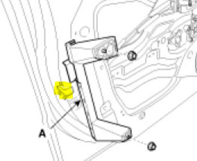

I attached two pics below. The first is the best I could find to indicate where the door latch is located. The second is the striker where the latch attaches to. What I want you to do is check of the latch in the door (pic 1) is already in the closed position. If it is, it will hit the striker and not close.
If you find that it is, pull the door handle to the open position and take a screw driver or something to move the latch back to the open position.
If you have already tried this (I'm not sure what you meant by the screwdriver trick) let me know.

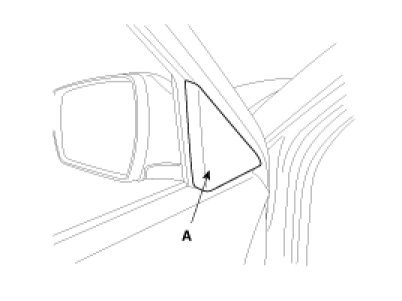

1. Remove the quadrant inner cover (A).
pic 1

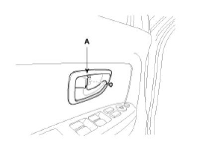

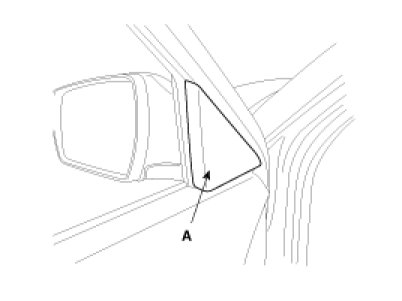

2. After loosening the mounting screw, then remove the inside handle cover (A).
pic 2

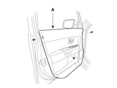

3. Loosen the door trim (A) mounting screws.
4. Release the clips that hold the door trim.
pic 3

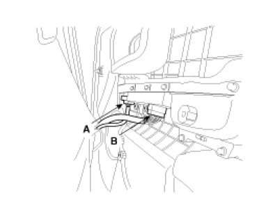

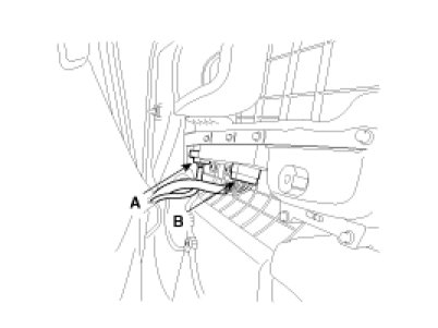

5. Disconnect the connectors (A) and (B).
pic 4

Do this and let me know what is found. There will be steel linkage between the handles and the latch assembly. Check to see if anything is disconnected or damaged.
