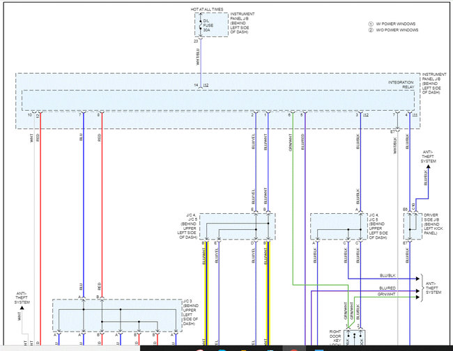

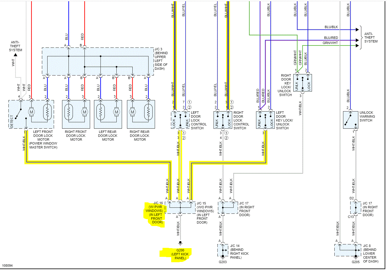

I need a little more information. First, the door lock actuator motors are powered directly. When you select lock or unlock, the switch itself provides a ground path to actuate the motor.
If you look at the pics below, it shows the wiring schematic for the door locks. Also, it shows the ground location for the main driver's door switch. Note this switch is related to both door locks and windows.
With that being said, since you are having trouble with both windows and locks, I suspect the switch has failed. However, before jumping to conclusions, I need you to check the ground (black wire with white tracer), behind the left kick panel. I have a feeling it has failed.
Do this and let me know what you find.
See pics below.
