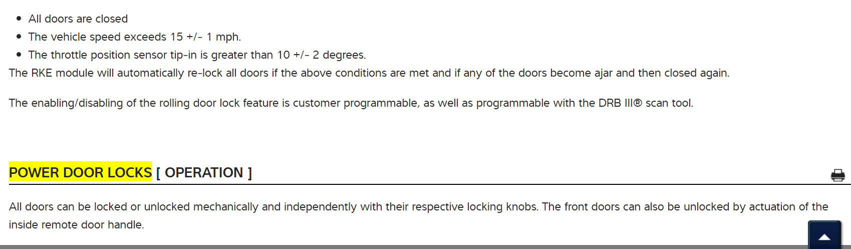

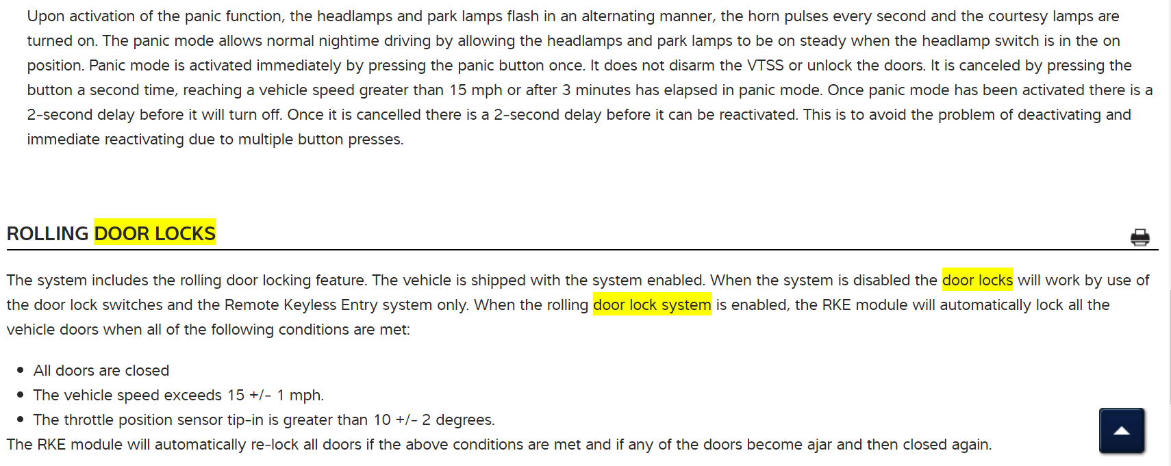

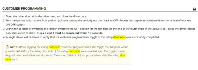

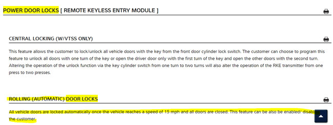

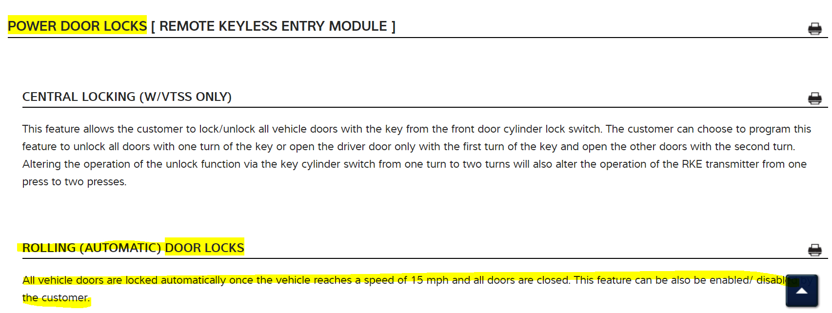

Not really a problem but I'm used to the doors locking once your going with the car and you get up to 15 or 20 miles an hour. Just wondering if they're supposed to look automatically on this car or not. I just recently bought this vast. Thanks in advance.

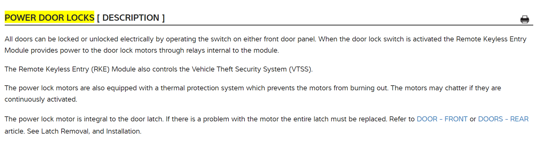

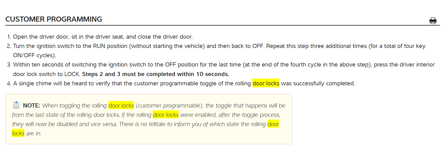

I have included the information that you you requested in the diagrams down below. Please go through this information and tell us how things turn out. Please, if you should have any other vehicle related questions, do no hesitate to ask. That is what we are here for.
