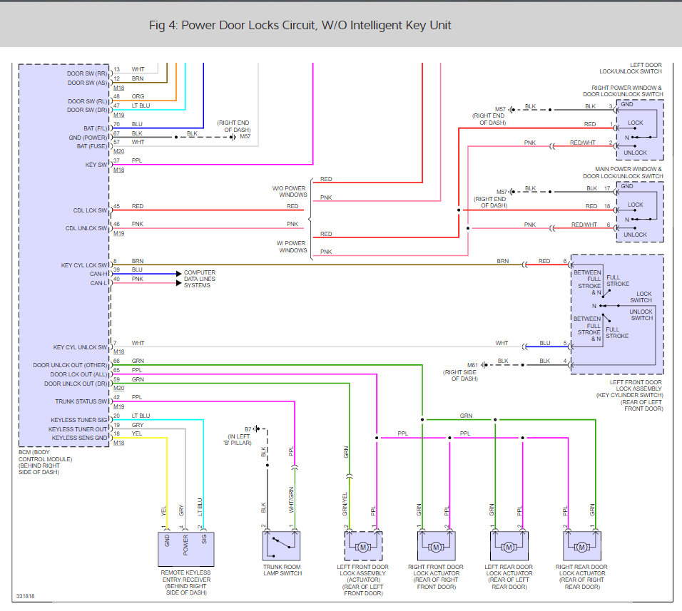

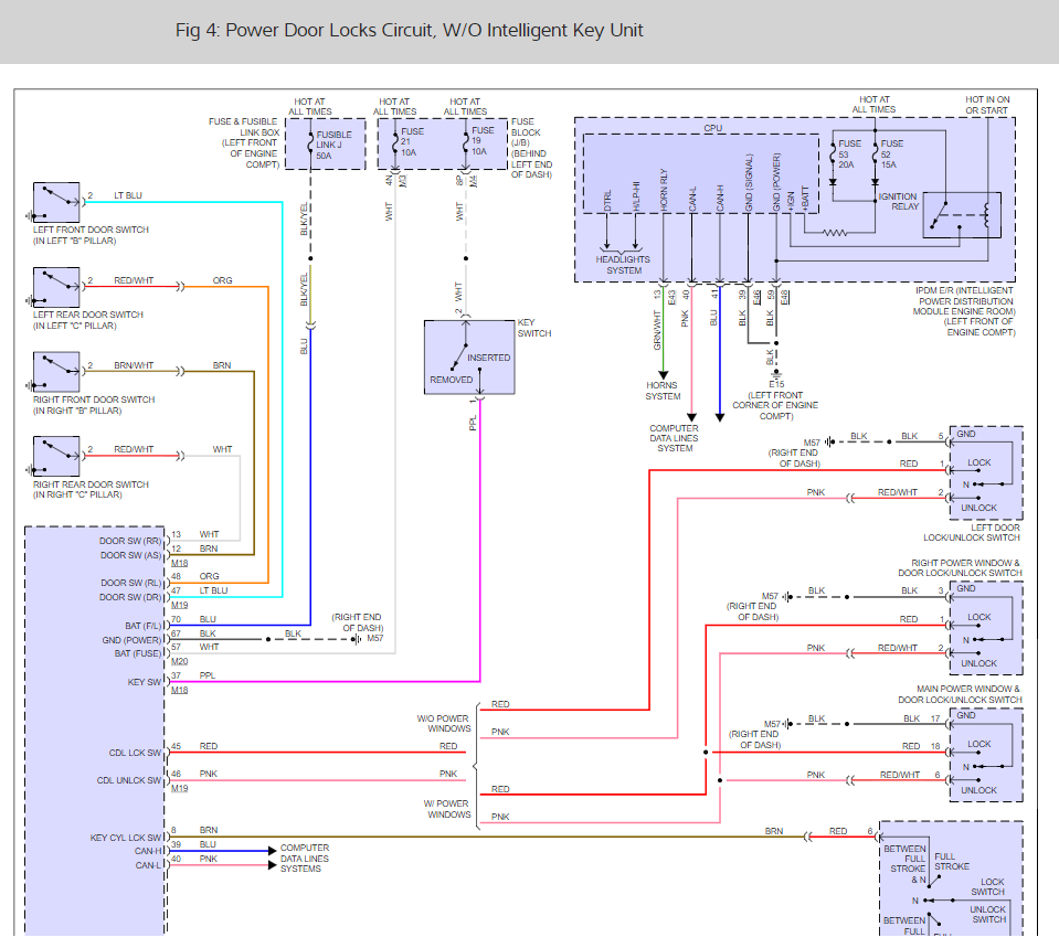

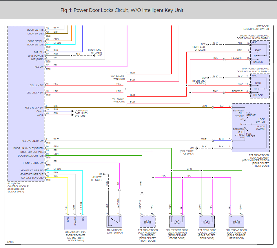

The driver side door lock quit work with the key fob but works with the key. Now all of a sudden the driver side rear door lock is doing the same thing. Could this be the actuators or is there a fuse that controls these?
