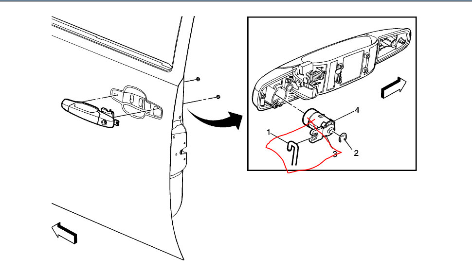

If you are unable to lock it with the key or power lock actuator, it sounds like we have a linkage issue. See pic 1.
When you try locking it, do you hear a click? When you try to lock it from the inside of the truck manually, is there any resistance in the manual lock?
