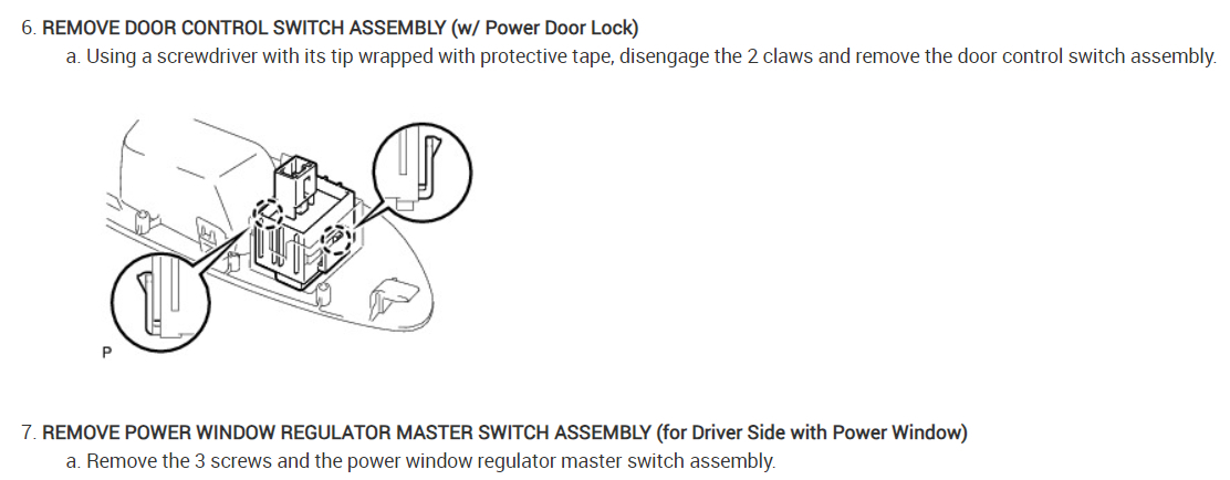

Thank you, the smart key door lock system is involved. It has a body ECU and a certification module; this is why I wanted to do a CAN scan but since the switch seems to be having an issue you might want to swap it out to see what happens. I would get the switch from Amazon so you can return it if it does not make a difference.
Here is one for $35.00:
https://amzn.to/4fRoDKq

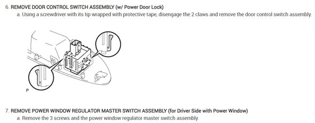

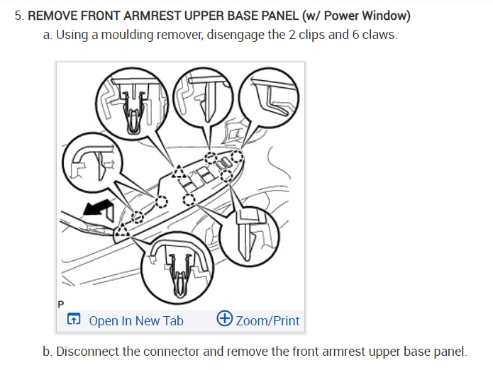

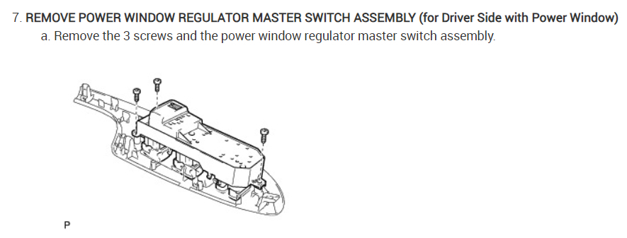

Here is how to change the master window switch out. Check out the images (below). Let us know how it goes.
Aug 21, 2024 at 8:57 AM

Okay, thanks, I’ll give that a try. but just wanted to ask wouldn’t it make a difference it a disconnect and in theory it should stop the problem, wouldn’t it? Because I’ve disconnected the driver side switch, and it still does the same thing so I’m kind of believing that’s not the problem.
Aug 21, 2024 at 9:16 AM

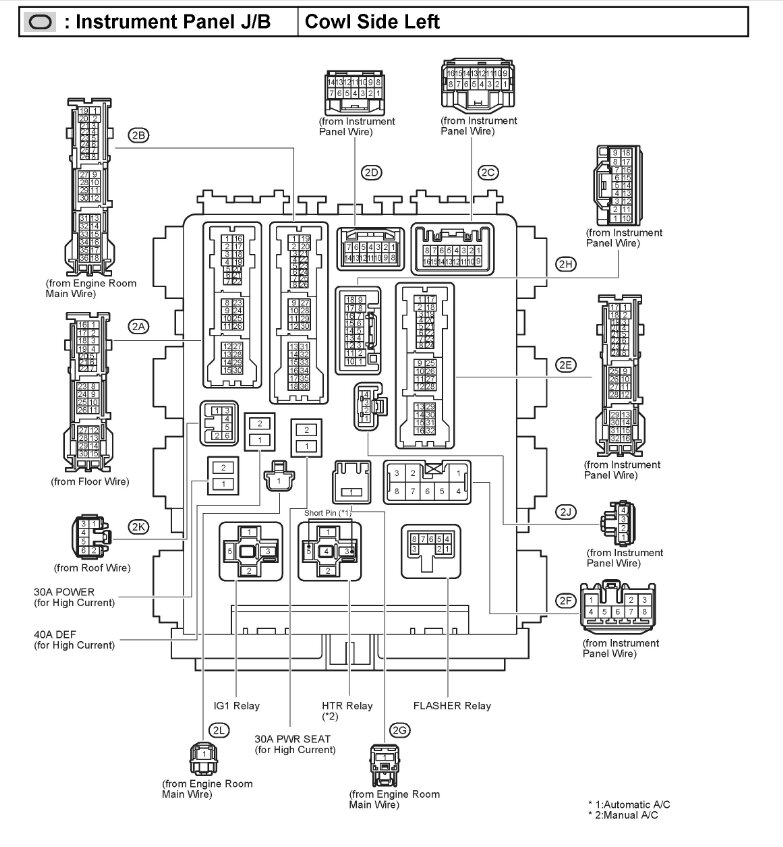

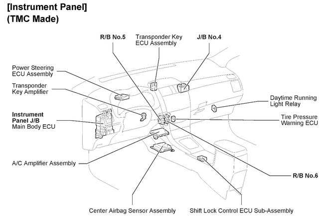

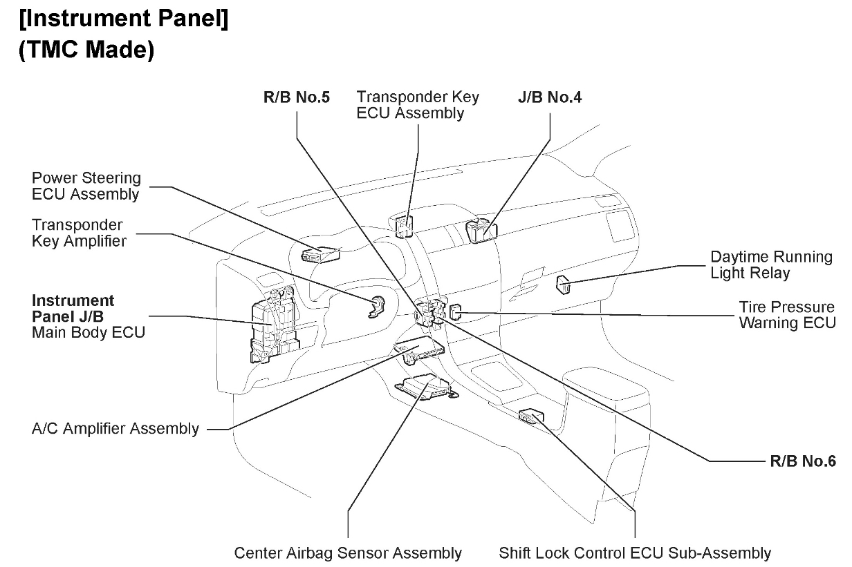

Okay, that is telling us the body ECU could be bad, that is why I wanted to do the CAN scan. Here is the location and how to replace it in case a code comes up for it. The only other thing I can think of is one of the latches is bad, you might want to disconnect the latches one at a time as well, I would start with the driver's door.

Yes, i disconnected all the actuators one at a time and I still seem to have the issues if i replace the body ECU is there any programming I have to do or just swap the parts and that’s it?
Aug 22, 2024 at 1:32 PM
I believe it needs to be programmed as all other cars do, you can get a preprogrammed unit by searching Google or Ebay.
