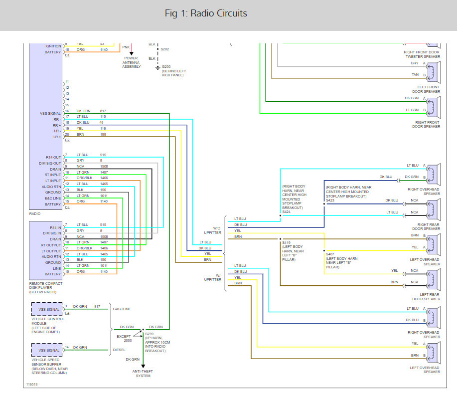

Stock amplifier loses power when door lock button is pressed. I bought the replay that is needed, but do not know where it is located.
Sep 20, 2018 at 7:50 PM
CERTIFIED EXPERT
53,854 POSTS

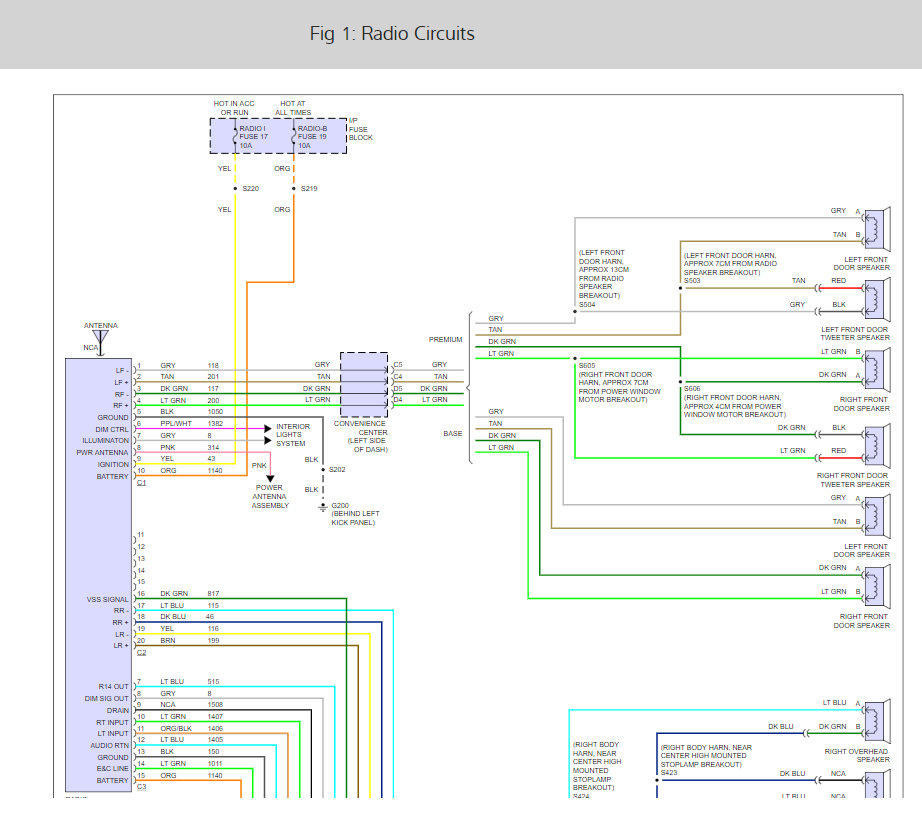

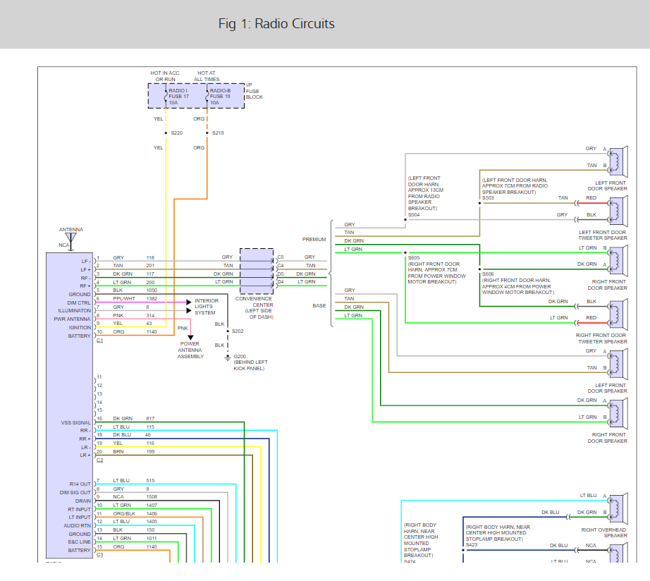

I do not see a relay in the system, but I do see the convenience center and VSS inputs. Here is a wiring diagram for the radio so you can see how the system works. This guide can help as well.
