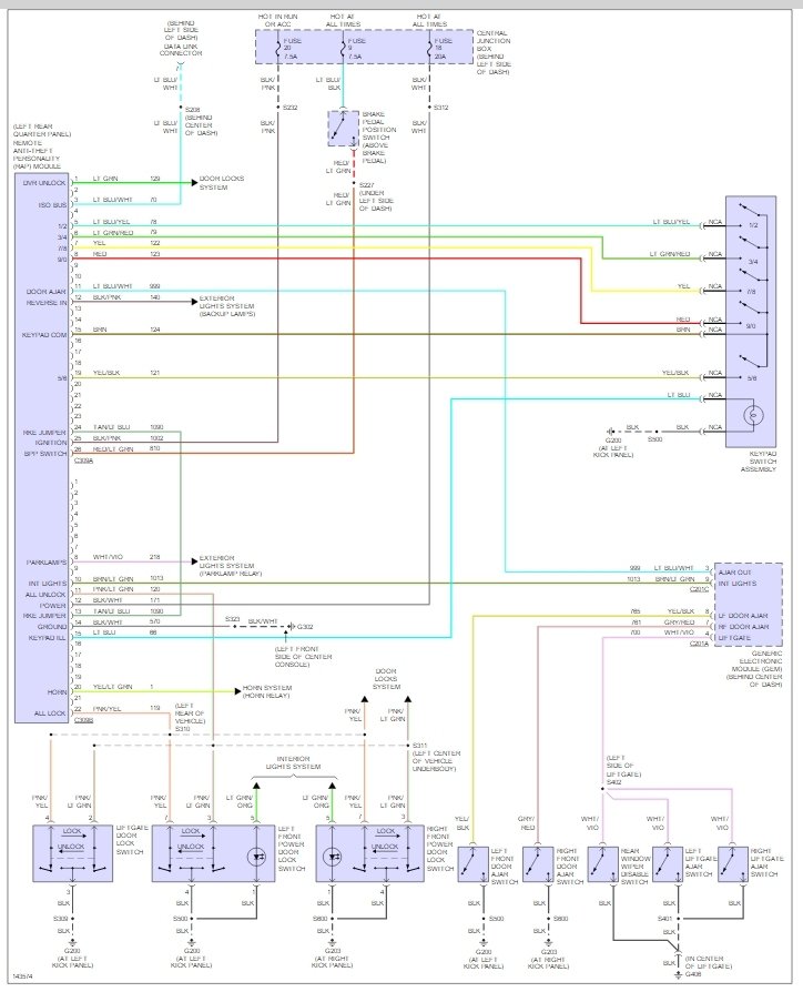

When I push on keyless door lock or unlock the door locks turn on off over and over won't stop till I pull fuse out

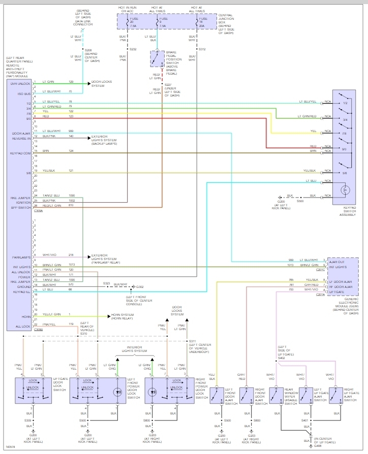

This is a anti theft computer module problem which is common with these vehicles, here is the location and wiring diagram to help, please let me know what you find out
