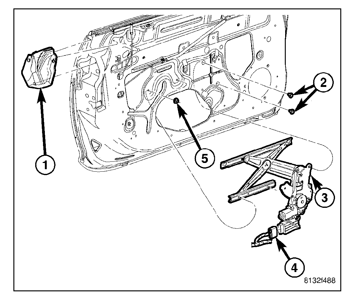

Here are the directions from Alldata. The attached pics correlate with the directions.
Note: These directions include both the convertible and coupe models.

CONVERTIBLE
NOTE: For power window motor installation procedures.
pic 2
1. Move window regulator into position in door and engage bolt heads into key hole slots in door inner panel.
2. Install stabilizer channel to door panel.
3. Install nuts to stabilizer channel.
4. Tighten rear and front nuts of roller channel.
5. Install bolts attaching window regulator base plate to door inner panel.
6. Tighten top forward bolt, bottom rearward bolt, top rearward and then bottom forward bolt attaching window regulator base plate.
7. Install nuts (5) attaching regulator lift channel to door glass.
8. Connect wire connector (4) to power window motor.
9. Verify glass fit and operation. Adjust door glass, if necessary.
10. Install door water dam and trim panel.

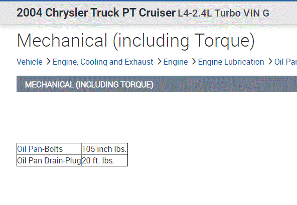

How about the oil drain plug? Couldn't I just mark it and return it to the mark so it's the same as it was?
Dec 5, 2020 at 8:53 PM
No. If you mark it, you can realign the mark but won't know if the tightness is correct. It may require one more turn or one less turn.
I do have the torque specs for the oil pan drain plug. See pic 1. (20 Ft. Lbs)
Let me know if this helps.
