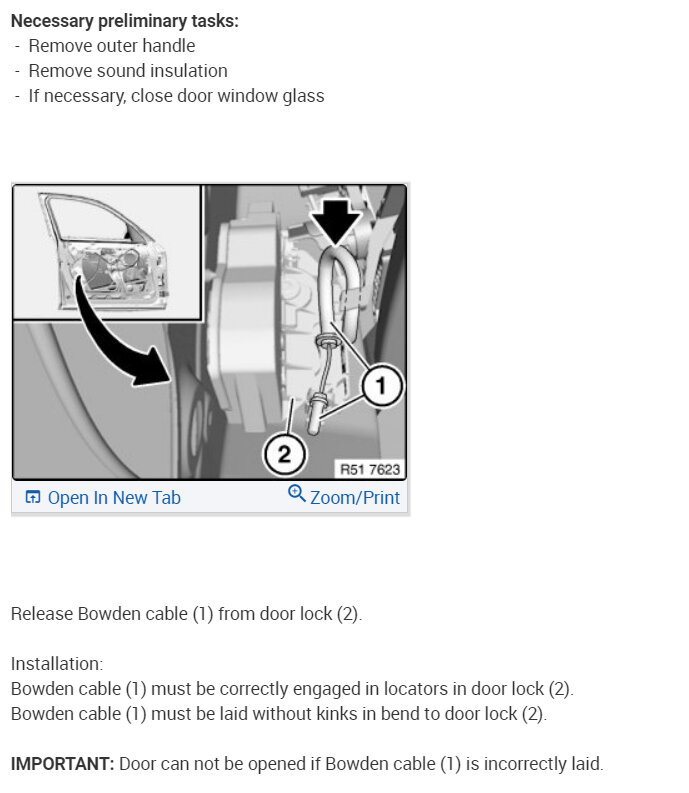

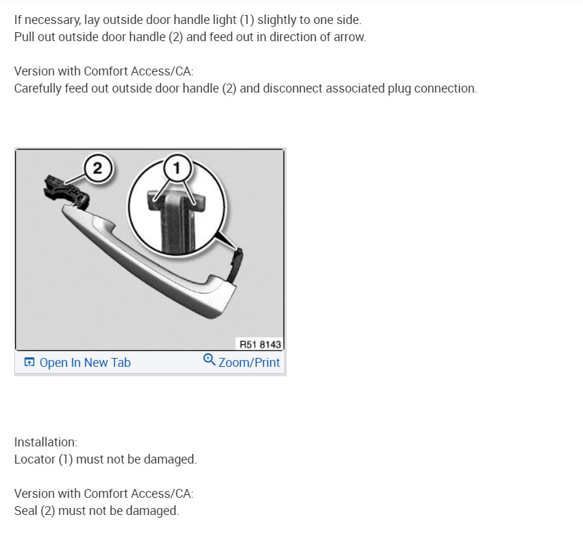

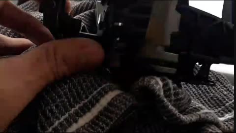

Pulled a bit too hard on my door handle it seems. I have had it happen before but usually a soft tap would fix it. Now it really doesn't want to move.
By the way, it's a BMW116i, I chose 118i because there was no other option.
