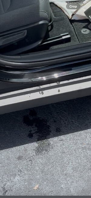

Brand new car had it 2 weeks. Noticed when opening the door water dripped out. It has been raining every day and since it last rained this was the first time I had opened my car door and water dripped out. Interior dry just droplets dripped on sill and ground. Only noticed this after the car has sat after a heavy rain. Is this normal?
Jul 6, 2025 at 7:55 PM
STEVE W.
  • 15,113 POSTS
Those would be the door drains, and they should actually drain out faster. Normally they would be more open. If you get down and look up under the door you will see the drain slots in the panel. I would take a small nylon brush and clean them out to improve how it drains.

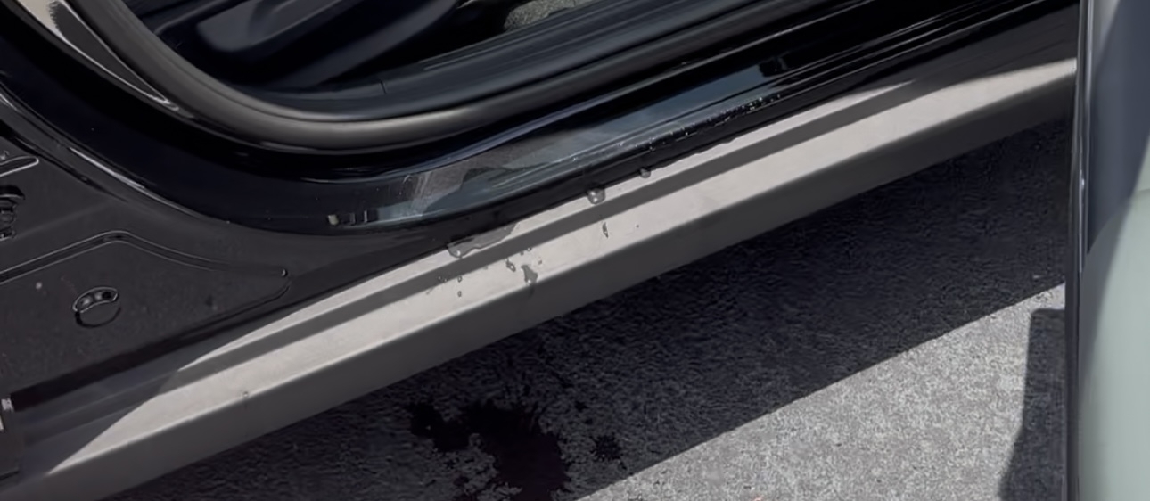

Here’s a better close up. Also, the car is brand new so I’m not sure if it’s a design thing. I haven’t been in my car for a few days, so it was sitting and when I went out, I opened the door, and a few droplets came out and that was it wasn’t continuous.
Jul 6, 2025 at 8:07 PM

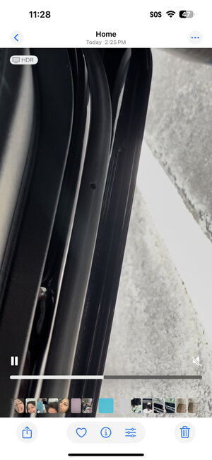

Here’sa picture of one of the weeping holes.
Jul 6, 2025 at 8:28 PM
STEVE W.
  • 15,113 POSTS
The outer door seals around the glass on the doors leak a bit by design, if they were very tight it would scratch the glass so they use a felt type material that does let some water through. When it rains some water can get into the door shell and then it drips out the lower door drains. Completely normal. Really nothing to worry about, but if you take it back to the dealer they will likely run a brush through the drains and send you home. As long as the water drains to the outside like that it's fine and after a few months of you using the car and the seals and doors getting better seated and all the build chemicals and sealers getting settled it will likely stop. Now if you were in heavy rain or wind whipped rain that can make it worse because it forces the water in. Then it might take a couple days for it all to get out. When you would worry would be if it rained hard and when you moved the door you heard water slosh in it, then the drains are completely blocked. Have seen a couple cars that way. The one had 4" of water inside it! Cleared the drains and it never had an issue after that.

That is great, no salt slows the rust to a crawl even then I would probably coat it if you tend to keep cars for a long time. Where I am they use the most salt of any state in the US and more than many other countries as well. You can practically hear the metal rusting away. The average life of a vehicle is about 12 years before they are rotted so bad they are unsafe. I've watched vehicles get crushed from rust that the owners were still paying off!
Really discourages you to buy new. As for yours, totally normal for them to leak after a rain, even a heavy dew can make them drip. When you get a big rain and they don't leak, then worry. Where you might see that is if you drive a lot of dirt roads or have a lot of trees that have the fuzzy pollen that blows around and sticks, but normally if you wash it at least once a year or so it will clean out the drains.

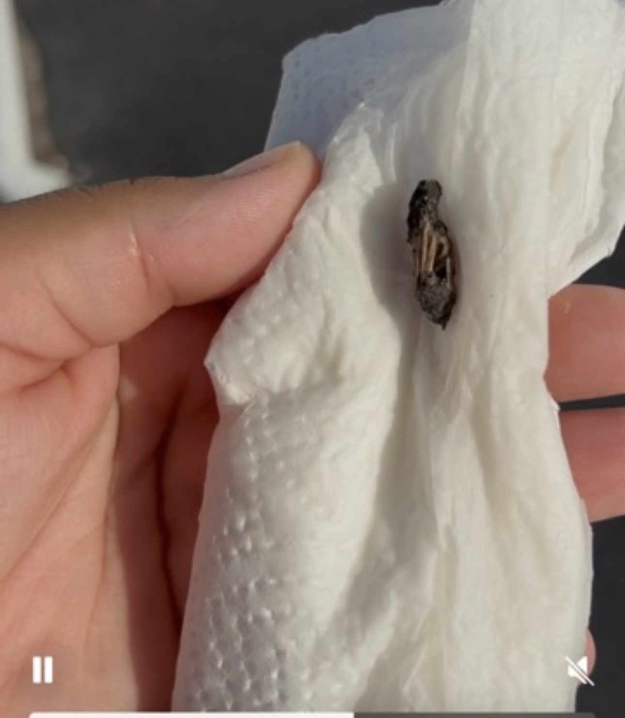

Found this on my car it’s paper thin and brownish black what is it?

Looks like a discarded cocoon, look in the trees around where you drive for a bagworm nest, they leave ones like that when they hatch. Questions are handled on a first come first serve basis. If a new one pops up someone grabs it.

Oh ok so it’s not a rodent or anything? I was worried when I saw it on the hood of the car. There have been a lot of landscapers around lately cutting grass and trees I wonder if it debris was blown and landed on the car? It was super thin didn’t feel like a dropping
Aug 3, 2025 at 8:26 AM

Here’s another picture
Aug 3, 2025 at 8:28 AM
ALYLAROSA485
  • 142 POSTS
It’s the little dot I’m pointing to
ALYLAROSA485
  • 142 POSTS
Also I don’t know if this is helpful in any way but I have been having a mourning dove constantly resting on the car so wasn’t sure if that was something from a dove like maybe their poo or something.

Probably blew in from the work around you. Just give it a good bath and a nice coat of wax and that would help with anything sticking to it. Just don't use my vehicles as an example, I haven't wash or waxed a vehicle I own in a very, very long time. Usually they rot away underneath long before the paint fades around here. Poo would be solid, not just a husk.
