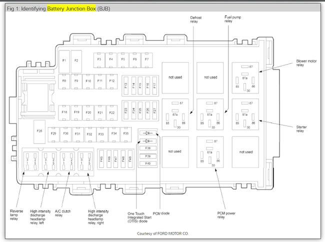

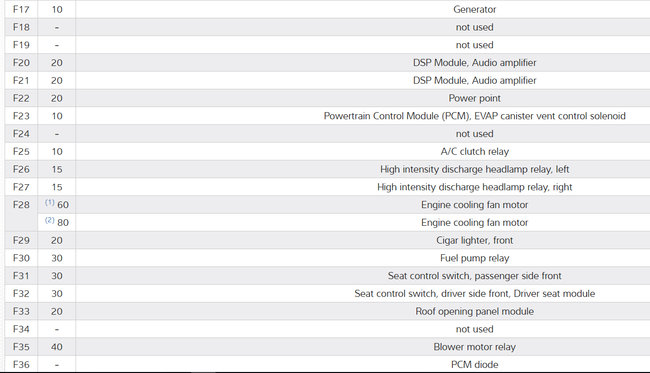

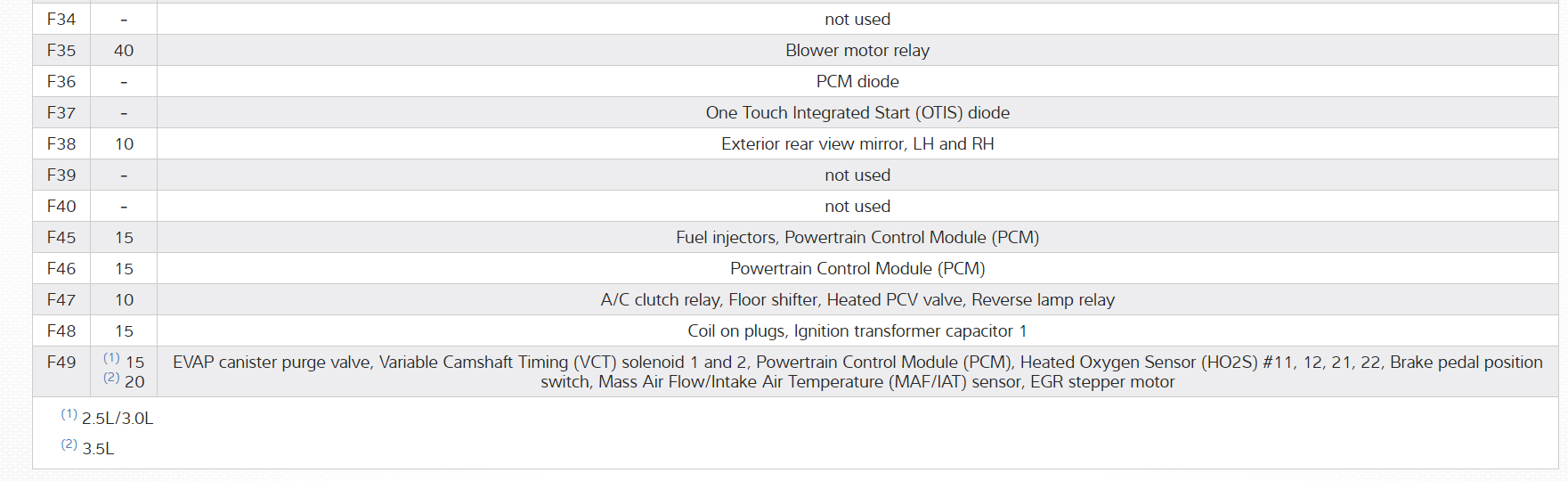

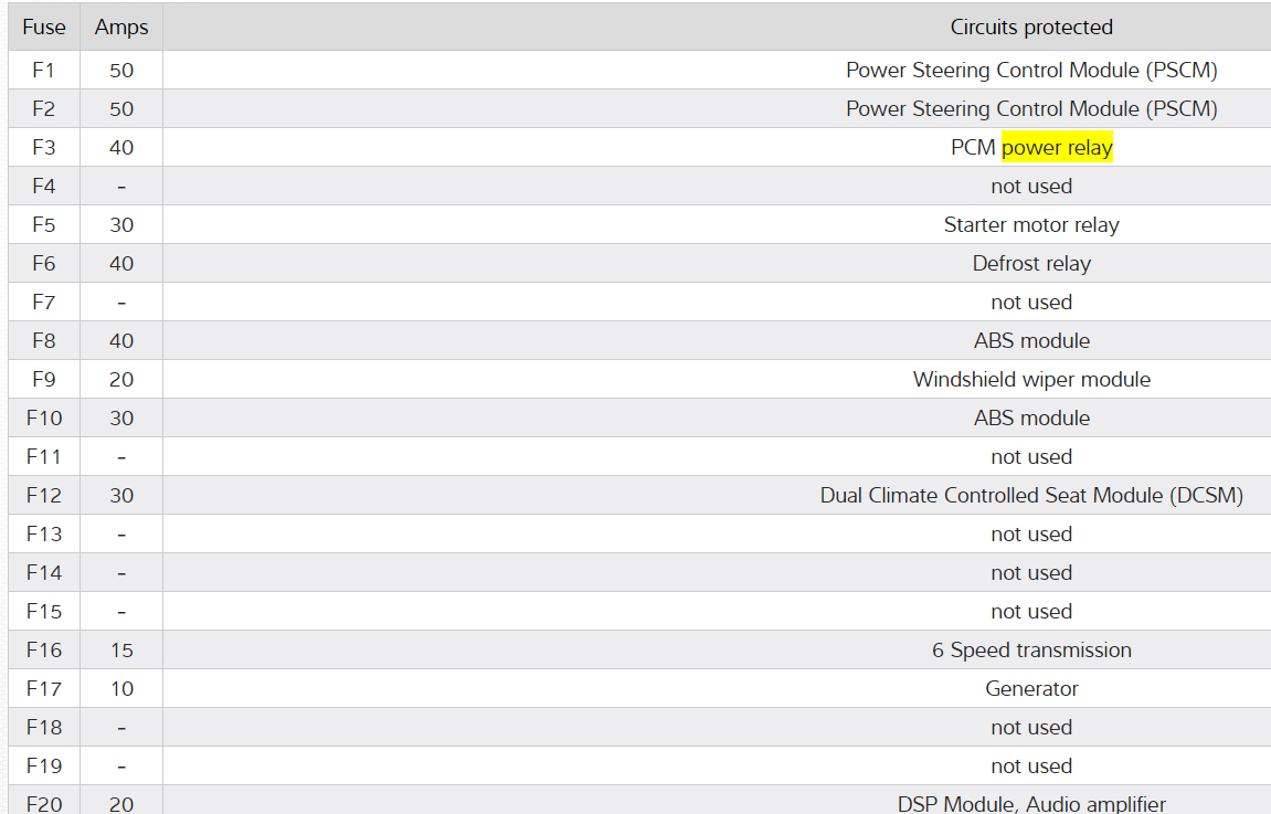

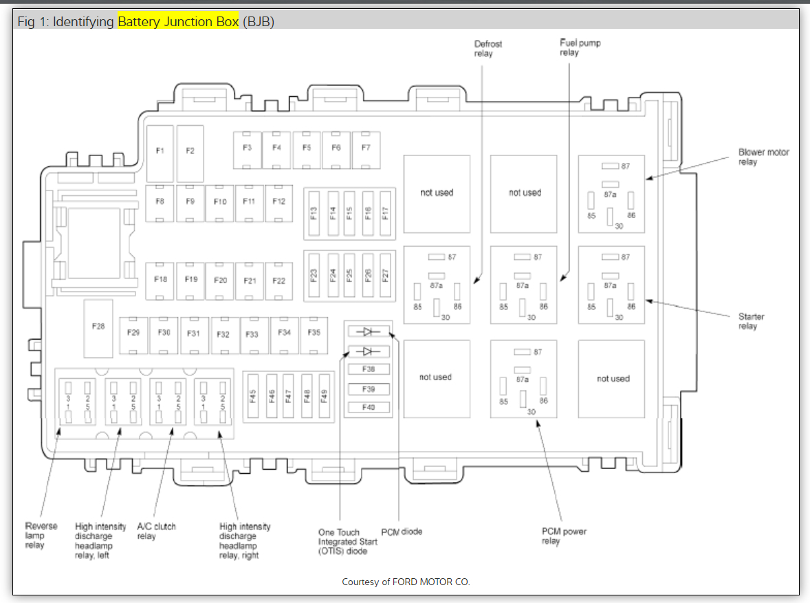

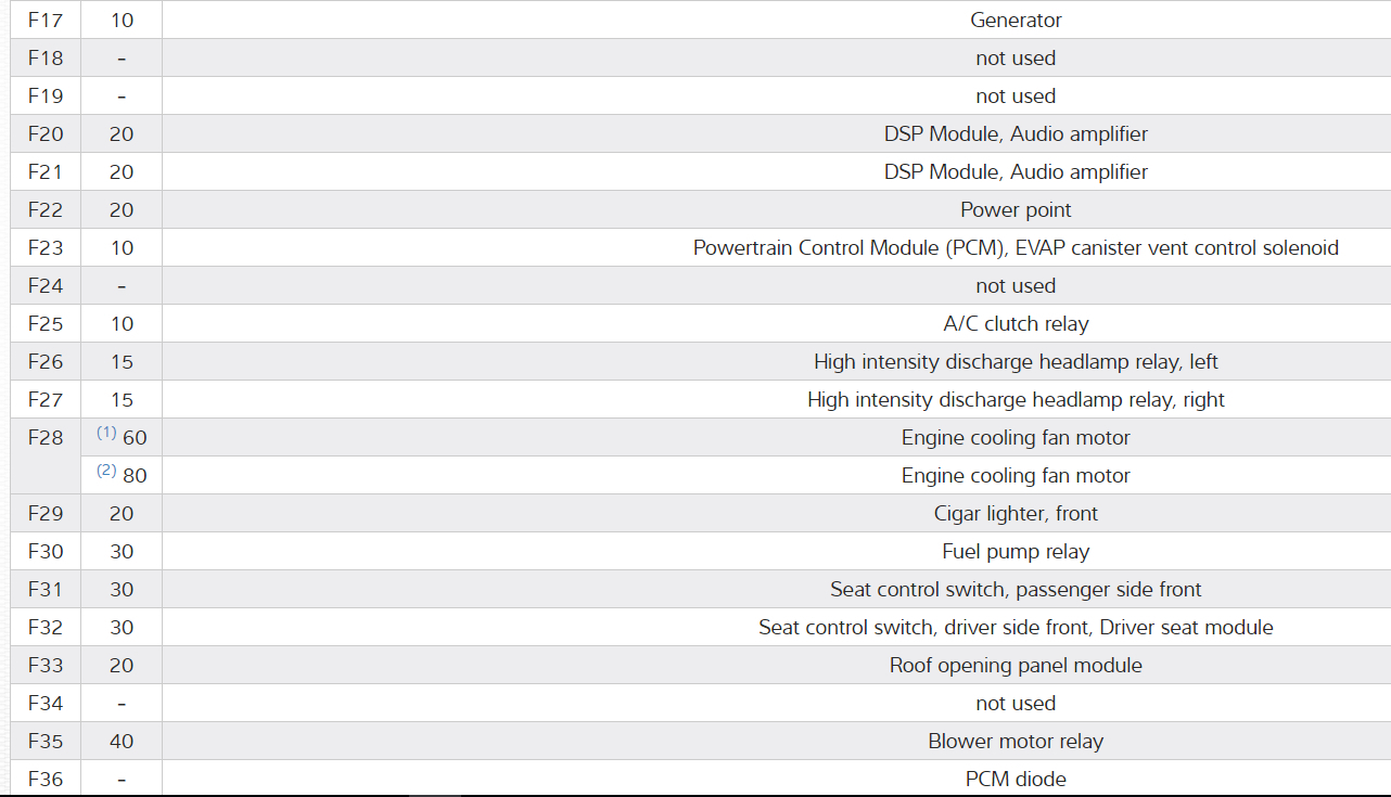

There is a fuse #f17. can we check to see if there is power present with the key on? Here is a guide and the location of the fuse below:
