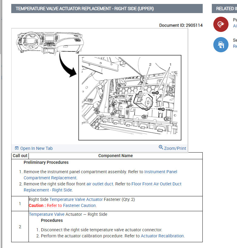

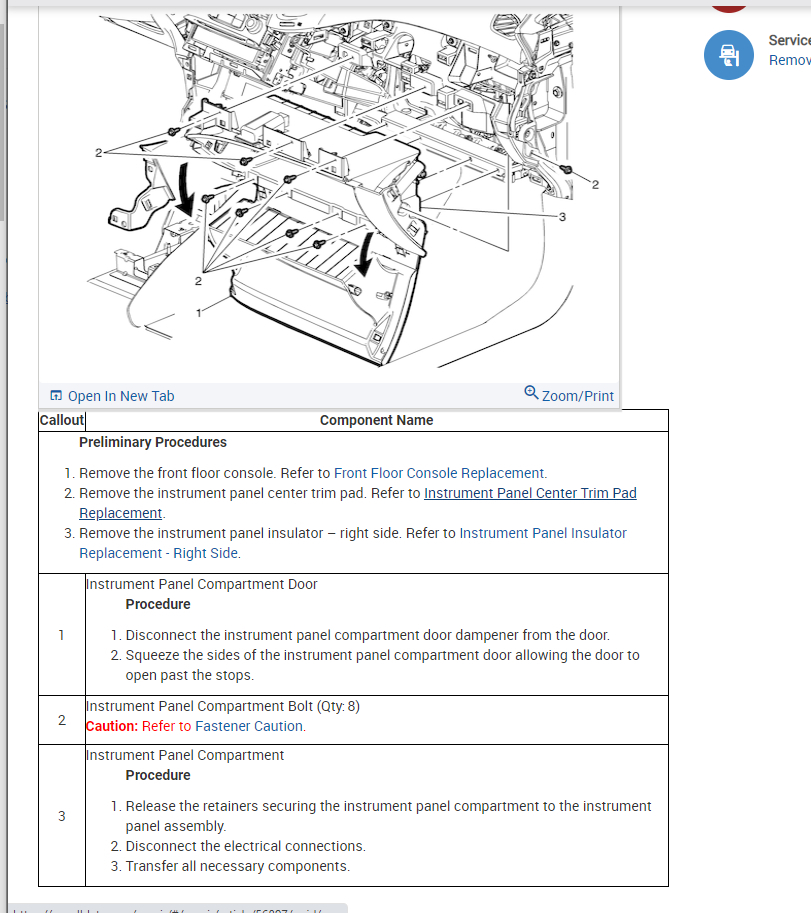

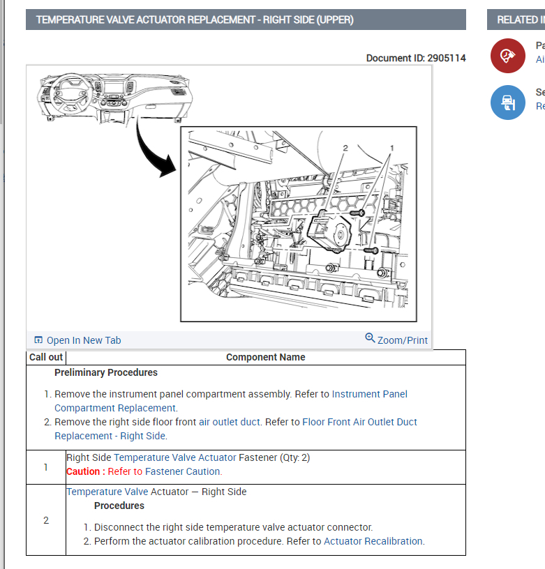

You are right. They are slightly different so here is the info that you need:
First this is a video of replacing one that just has some good info.
https://youtu.be/tY6M92fA2ug
Please see the info below on how to remove both blend doors if you have dual zone system. If you do not then you only have the right side blend door.
I also included the all the subcomponents that need to be removed.
Please run through this material and let us know what other info you need.

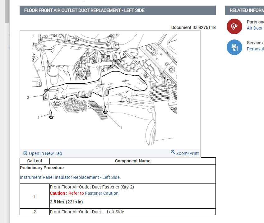

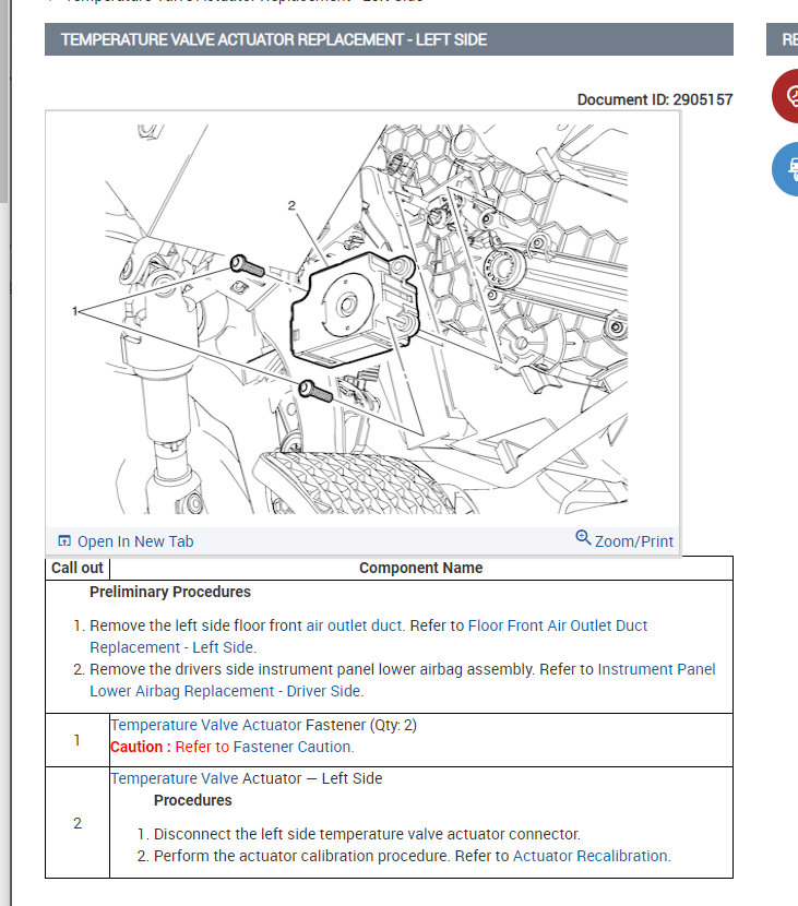

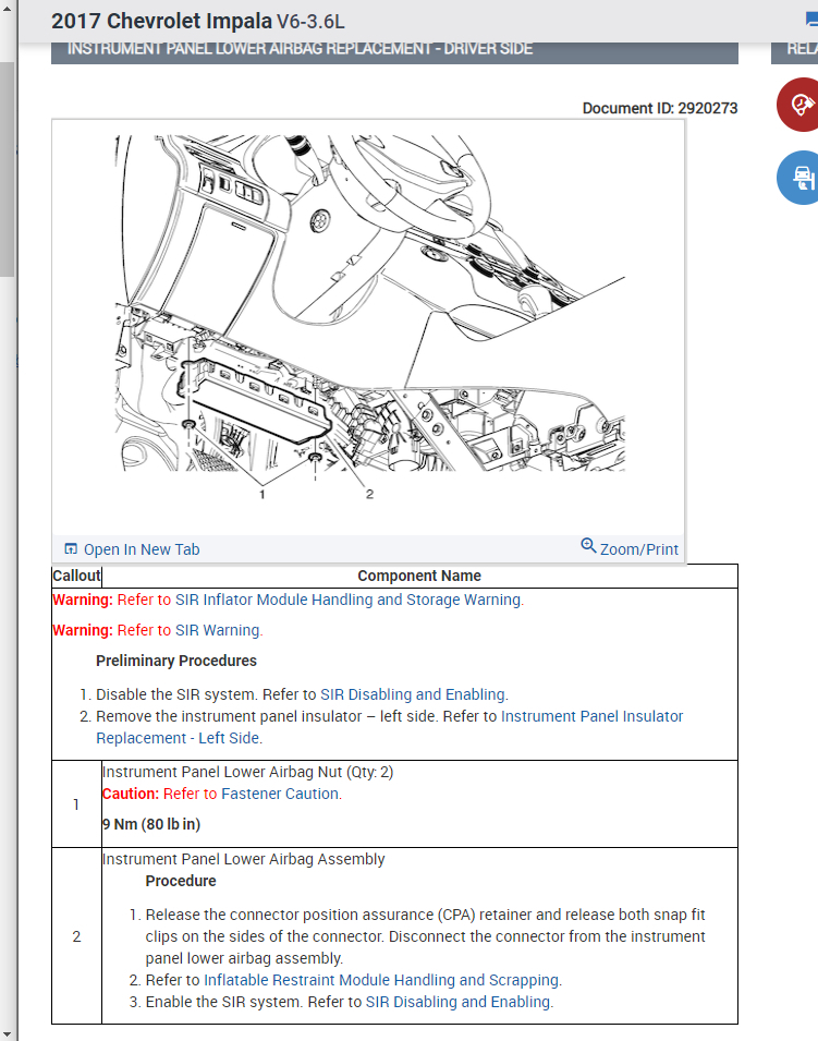

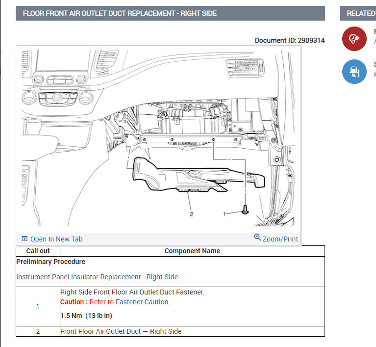

Sorry the video did not help but please use the instructions from the manual that I attached below the previous post. The video has some good info that will apply but that is why I provided the process from the manual that includes each of the steps that you need in order to access both actuators.
If you look at the first attachment you will see that step one states to remove the floor duct, and the next attachment is the process for this and then so on with each step.
Please run through this and let us know if you still have questions.
Thanks
