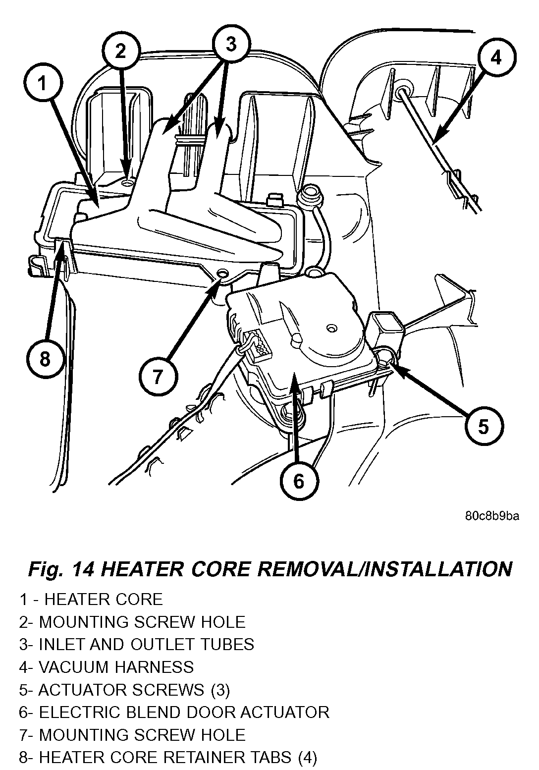

It is located at the top of the top of the HVAC housing. It is electric. Here are the directions. However, before you do this, check something. With the engine warm, running, and the heater on high, feel both heater core hoses to confirm both are hot. If they are, then it is most likely the actuator. If one is hot and the other isn't, the core may be plugged.
Here are the directions as listed from Alldata. There are other components which are actuated by vacuum. However, these directions indicate the blend air door actuator to be electric. The attached picture correlates with the directions

Fig.14 Heater Core Removal/Installation
Pic 1
3. Remove the screws that secure the blend door actuator to the top of the HVAC housing..
4. Remove the blend door actuator.
