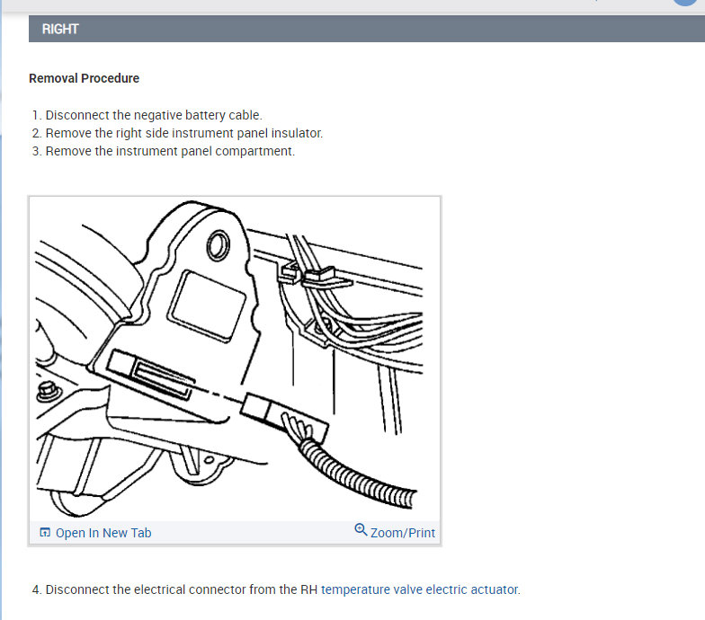

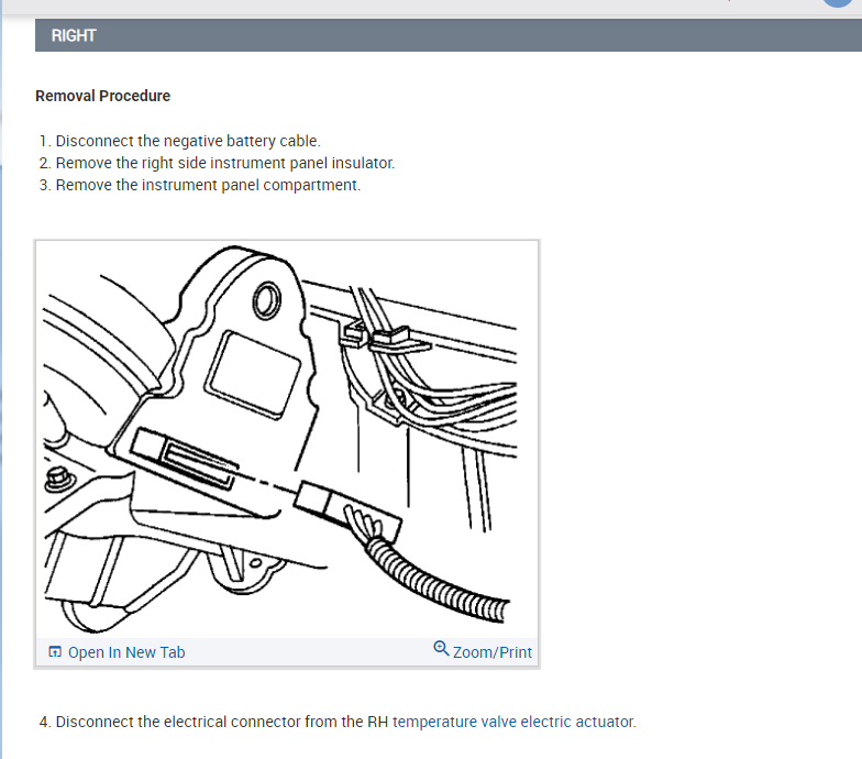

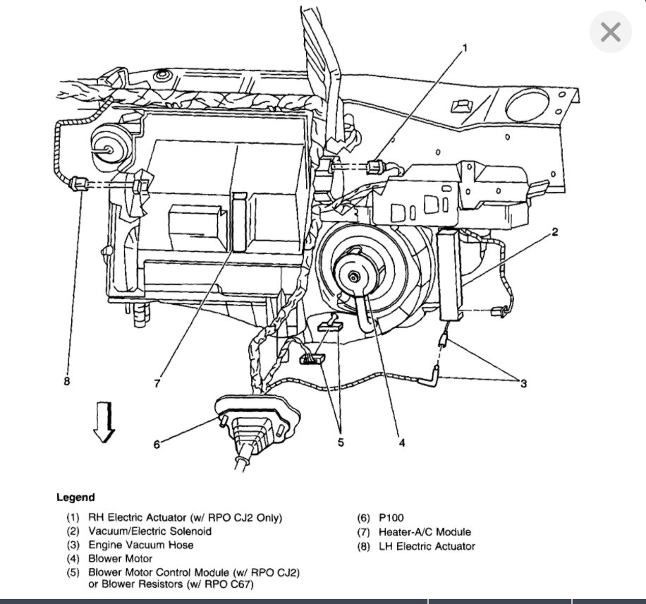

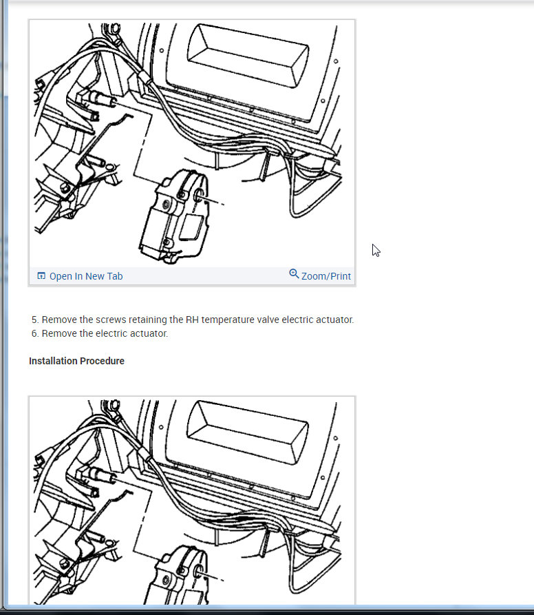

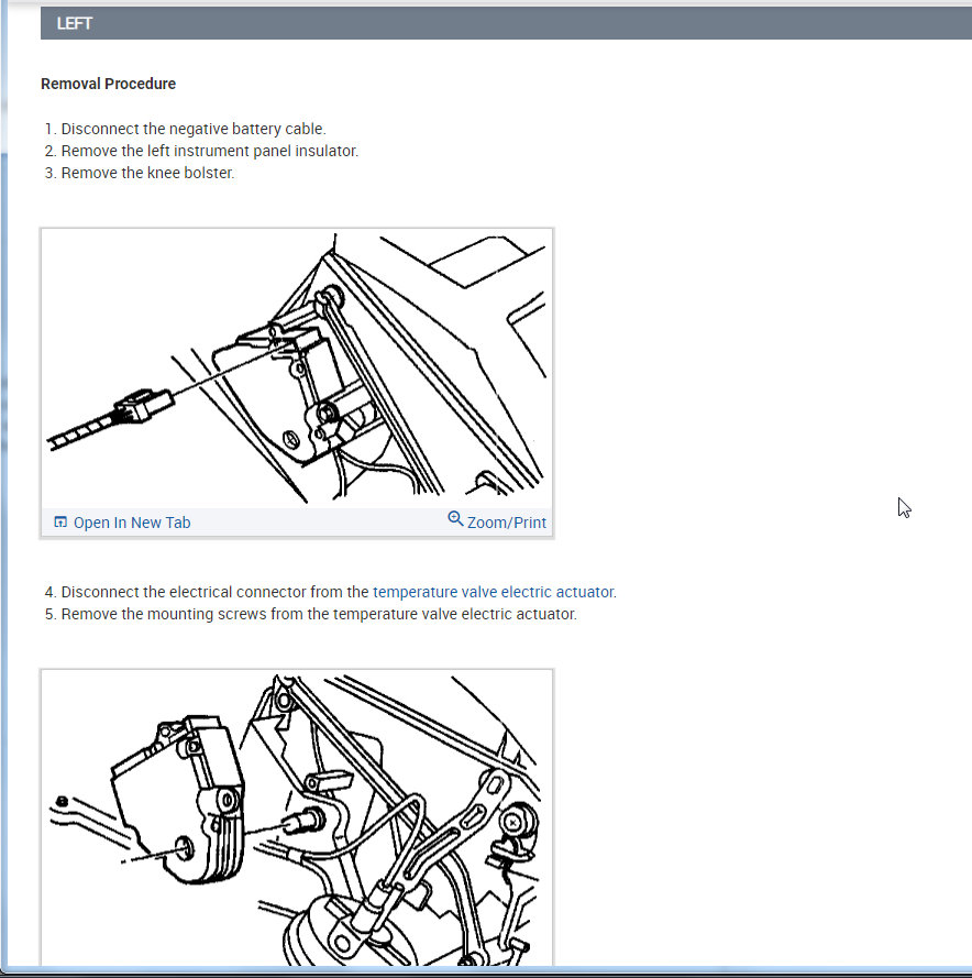

Looking for the location of the door blend actuators. I have duel climate control, so there should be one on the drivers side which I can't seem to locate! I did locate the right side under the glove box.
