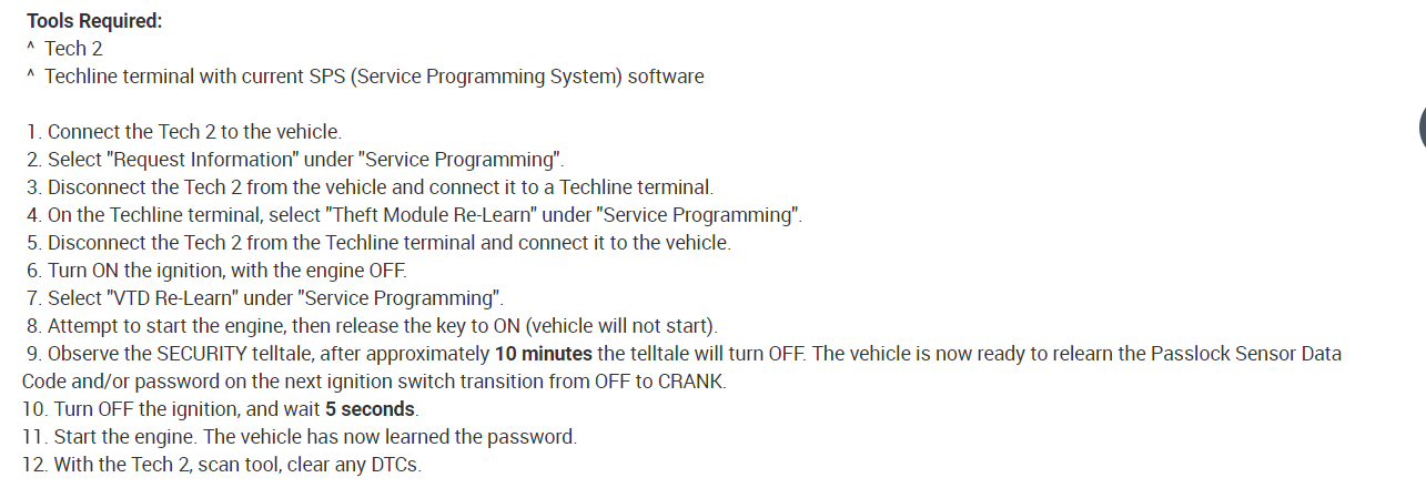

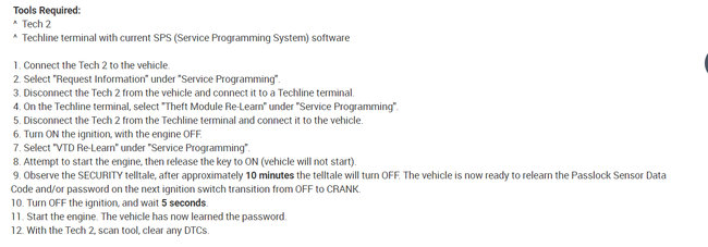

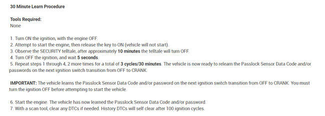

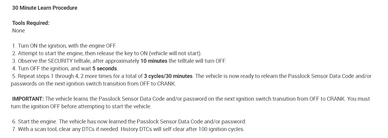

When you replace the ignition switch, you need to reset the password for the security system so it will crank and start. I attached a guide below for you to view on how to reset the system.
https://www.2carpros.com/articles/how-to-reset-a-security-system
There is a 10 minute relearn procedure that requires a scan tool. There is also a 30 minute that does not require a scan tool.
I attached both at the bottom for you to review.
