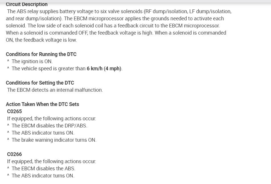

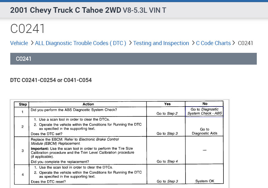

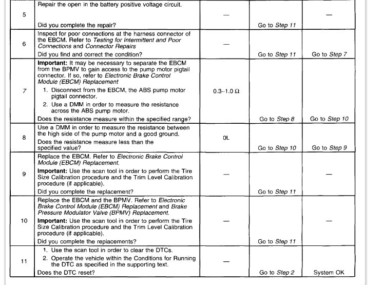

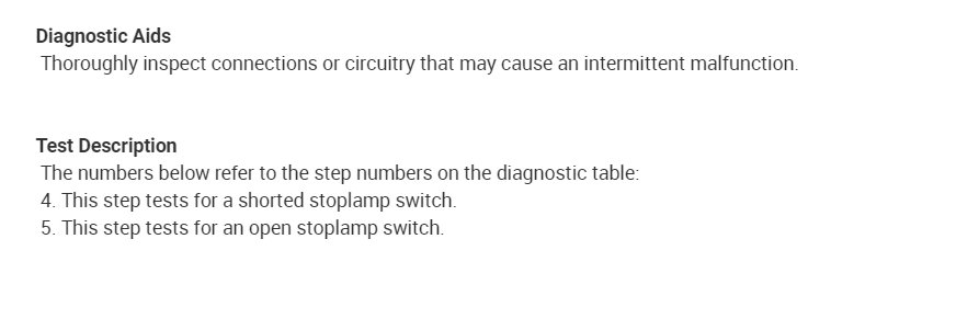

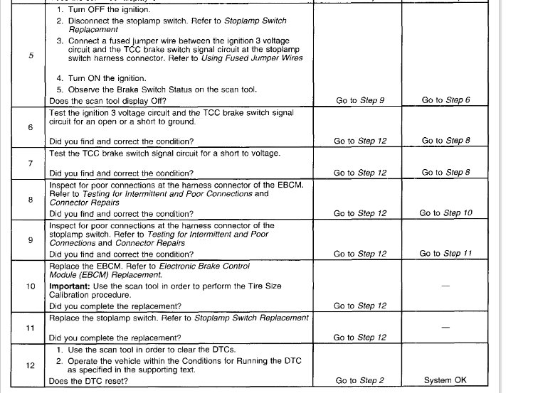

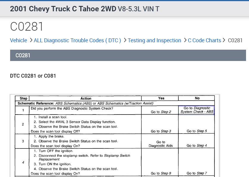

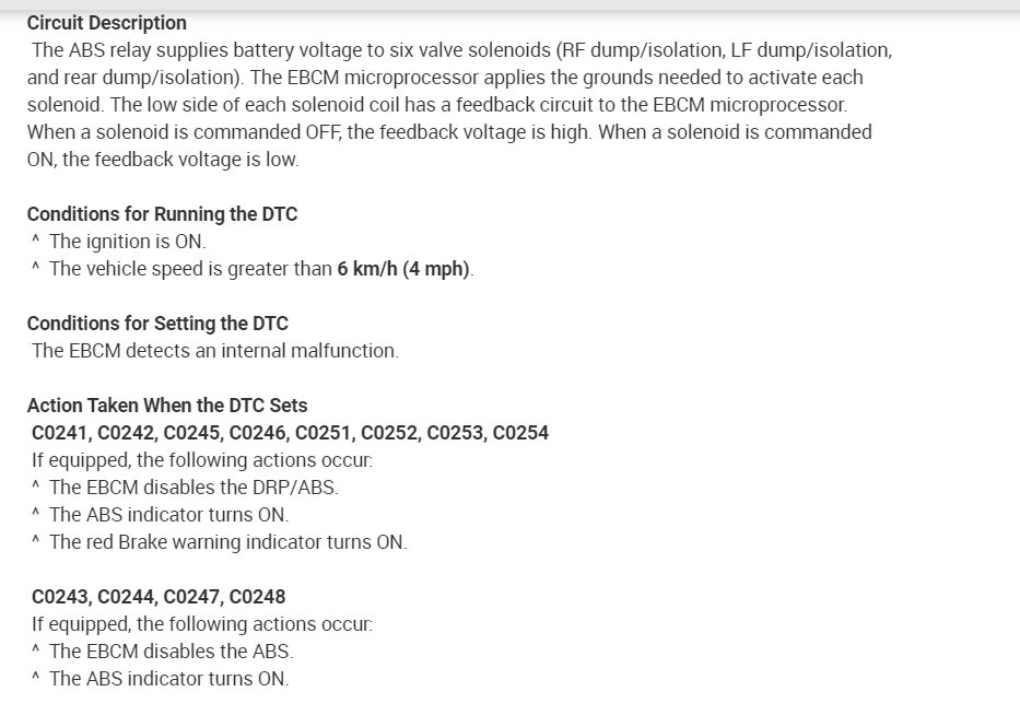

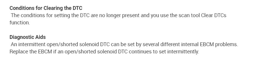

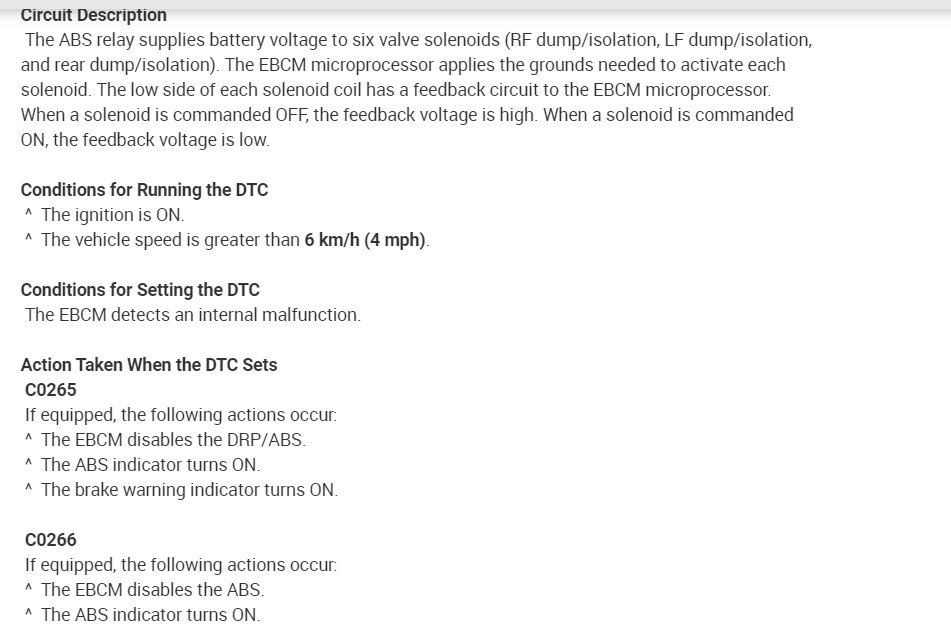

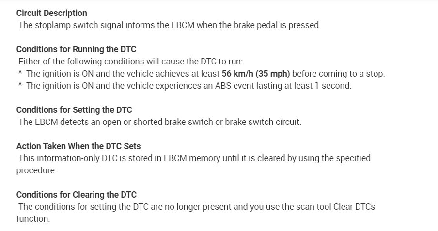

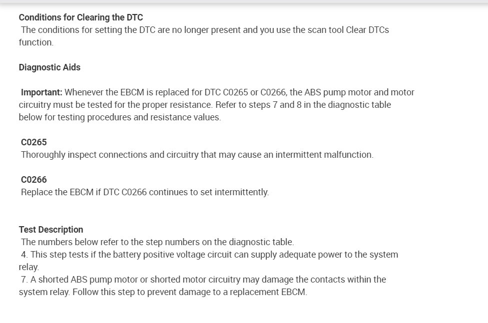

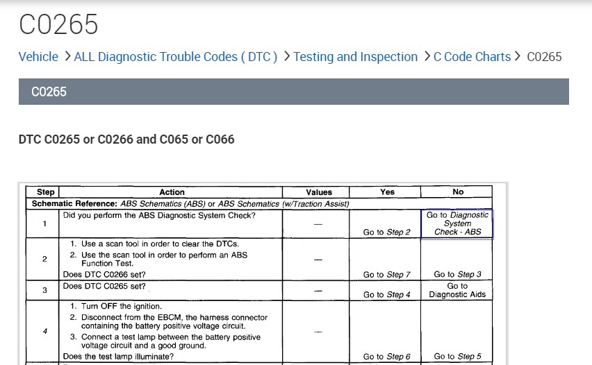

SCGRANTURISMO
CERTIFIED EXPERT

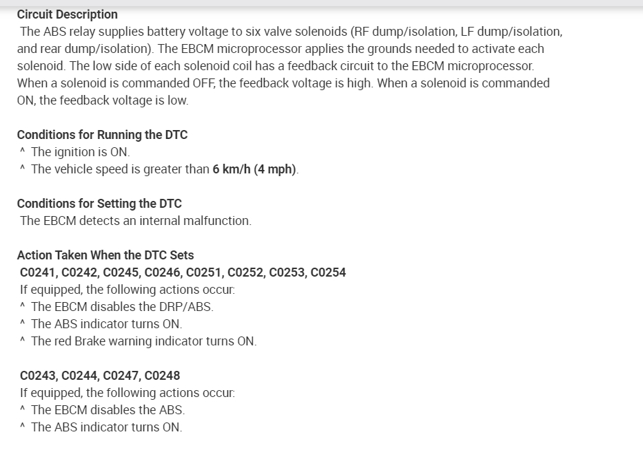

4,897 POSTS
All of the DTCs are dealing with malfunctions in your vehicle's ABS system. In the diagrams down below I have included diagnostic troubleshooting guides for all the DTCs listed above. Please go through them and get back to us with what you are able to find out.
