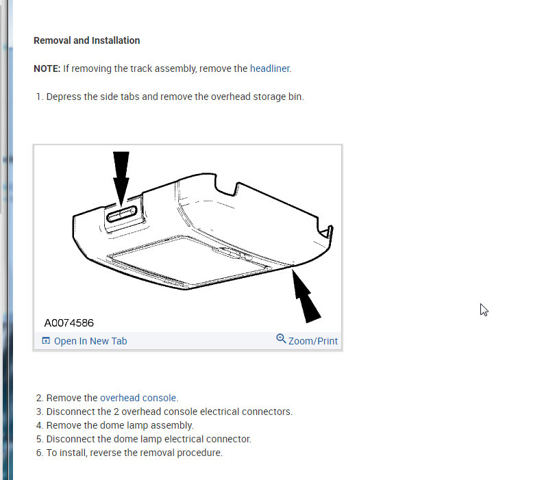

My left dome map light in my overhead console went out and I am trying to figure out how to change it. I cannot find screws anywhere. Does it just pull down with clips?
Dec 29, 2017 at 4:51 PM

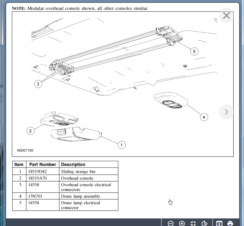

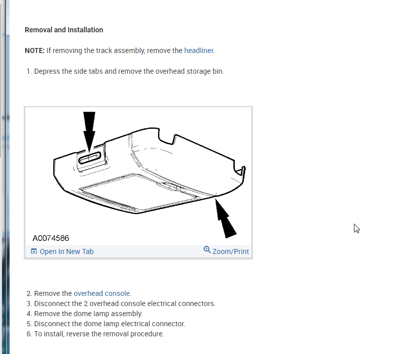

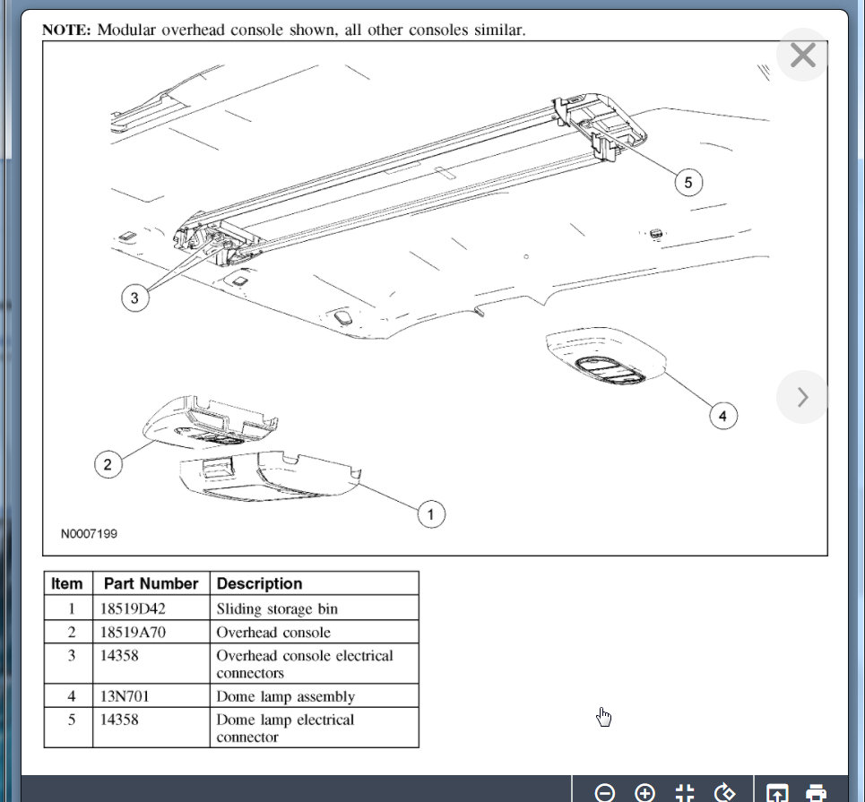

That is correct but you need to do that to the entire console not just the bulb. I am attaching below the process on how to remove the console so that you can access the bulbs.
Let us know if you have questions on this. Thanks
