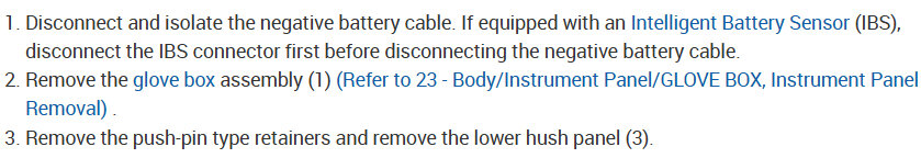

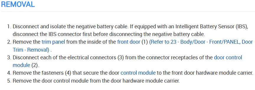

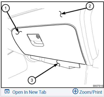

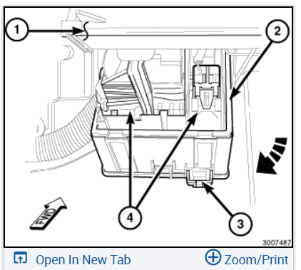

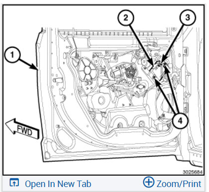

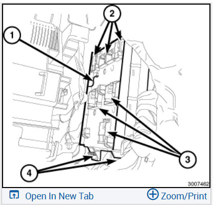

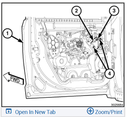

There is also a driver's door module that can be shorting out, I would remove the electrical connector and check it for corrosion, also check the BCM in the same way, disconnect the battery first. Here are the locations for both. Check out the images (below). Please let us know what happens.
