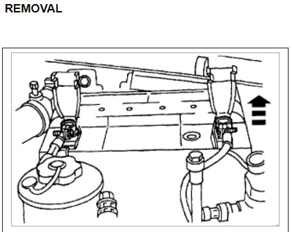

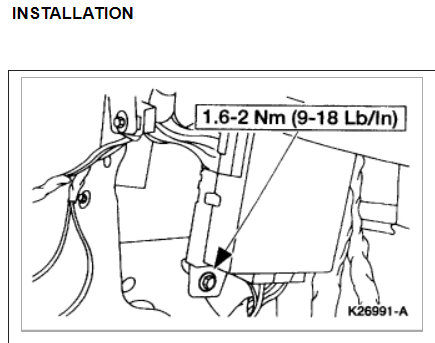

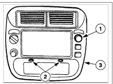

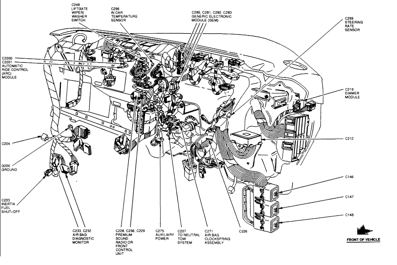

This is a common problem with these trucks. It sounds like the GEM is out and needs to be replaced. Here is its location.
Check out the diagrams (below).
