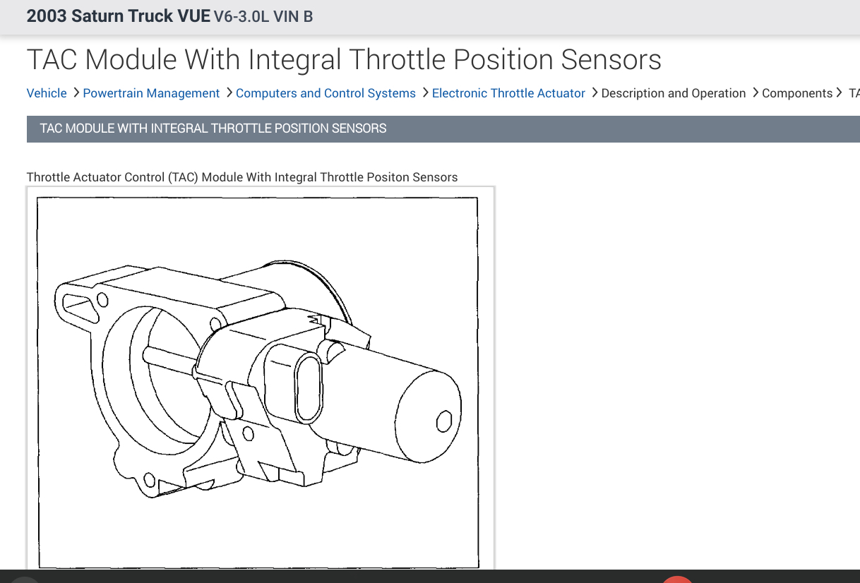

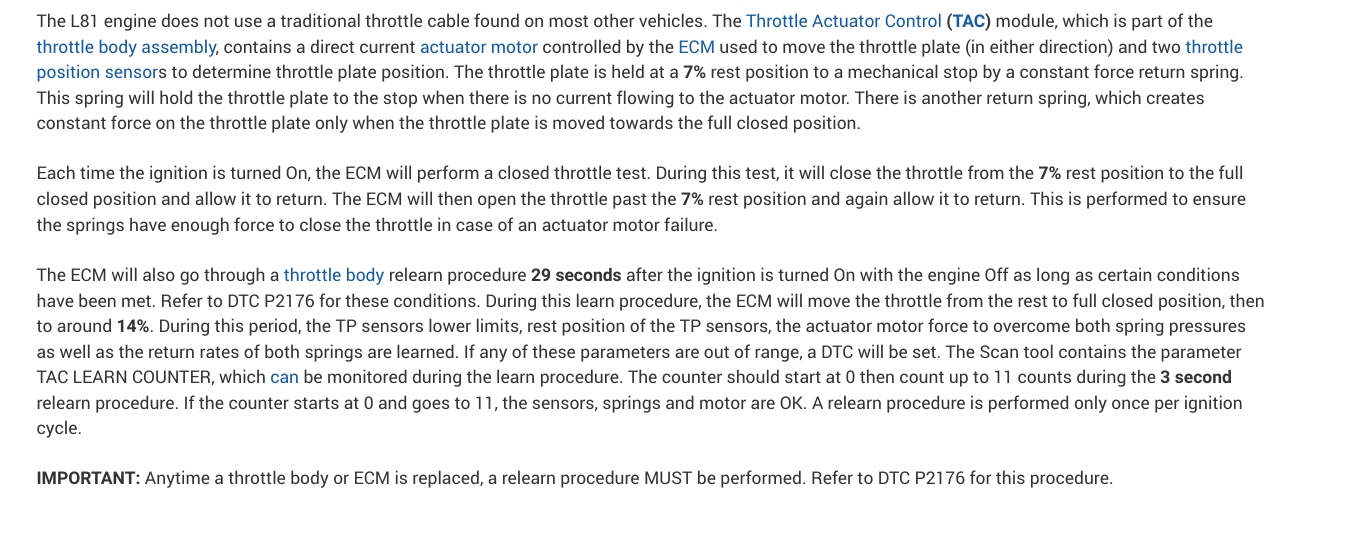

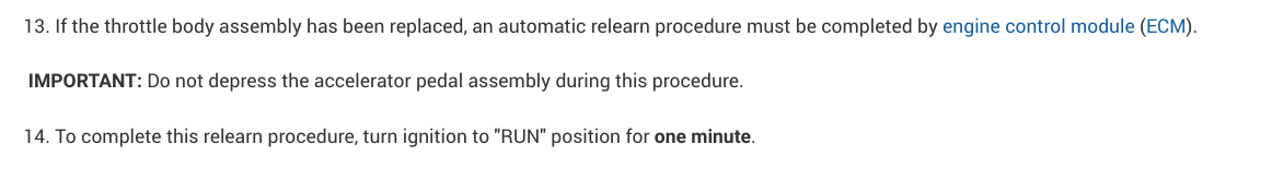

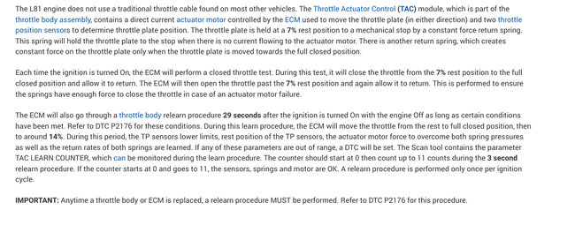

Okay, so I would recommend that you disconnect the negative battery cable from the battery's negative terminal for 15 minutes. Reinstall and tighten the negative battery cable to the battery's negative terminal and do the throttle body relearn procedure in the last diagram that we sent in the diagrams down below. Please get back to us with how everything turns out.
Thanks,
Alex
