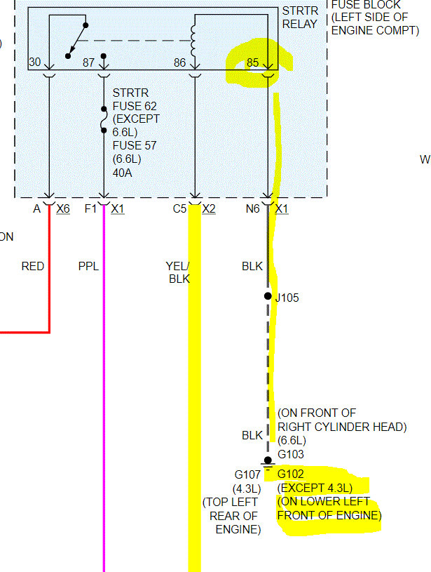

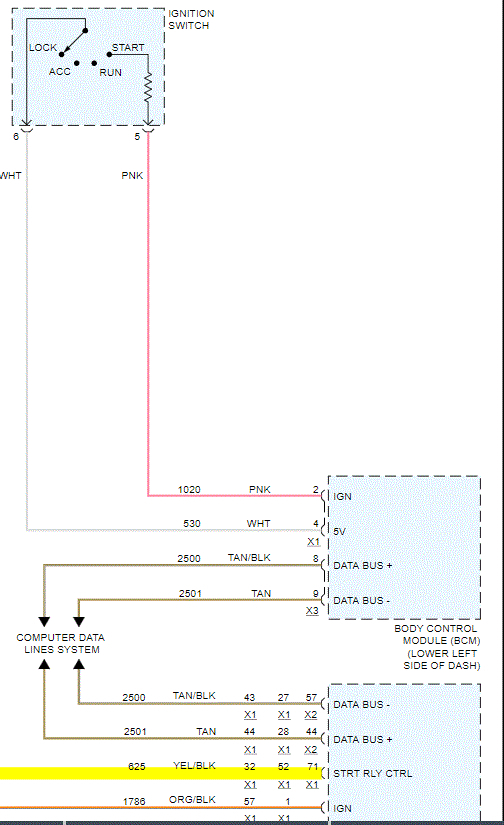

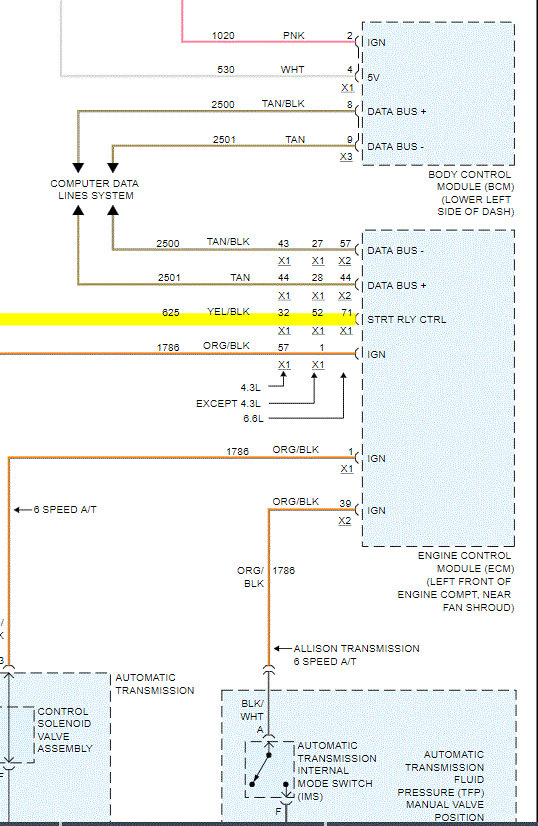

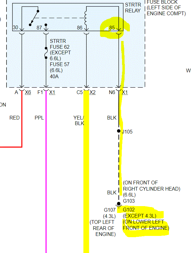

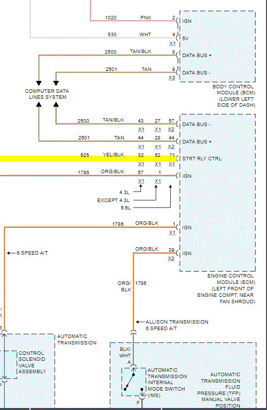

Now, if you are getting no nose from the starter / power to it, here is a flow chart for checking possible causes. Pic 1 correlates with the directions. It will require a scanner for some of the tests.

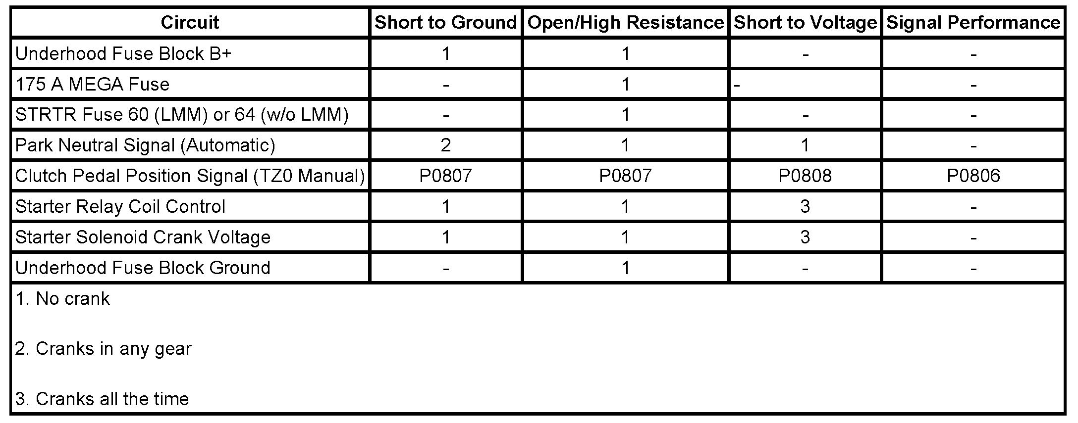

Diagnostic Fault Information
pic 1
Circuit/System Description
The engine control module (ECM) controls engine cranking based on a power mode input and the status of the park/neutral position (PNP) switch or clutch pedal position sensor. With the transmission in Park/Neutral, voltage at the ECM PNP switch signal circuit is low. This indicates to the ECM that conditions are acceptable for cranking. When a power mode crank request is seen, the ECM applies voltage to the starter relay coil control circuit. This energizes the coil side of the relay, which pulls the switch side of the relay closed, applying voltage to the starter X2-S terminal and engaging the starter solenoid.
