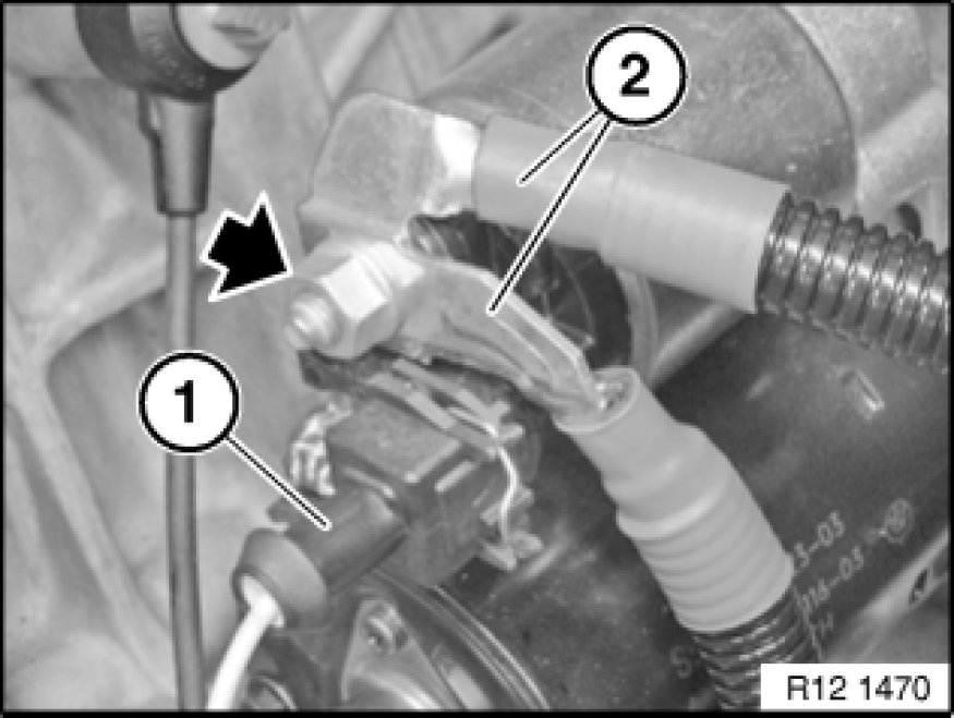

picture 3
Unlock plug (1) and remove.
Unfasten nut.
Tightening torque 12 41 3AZ .
Remove battery positive lead (2).

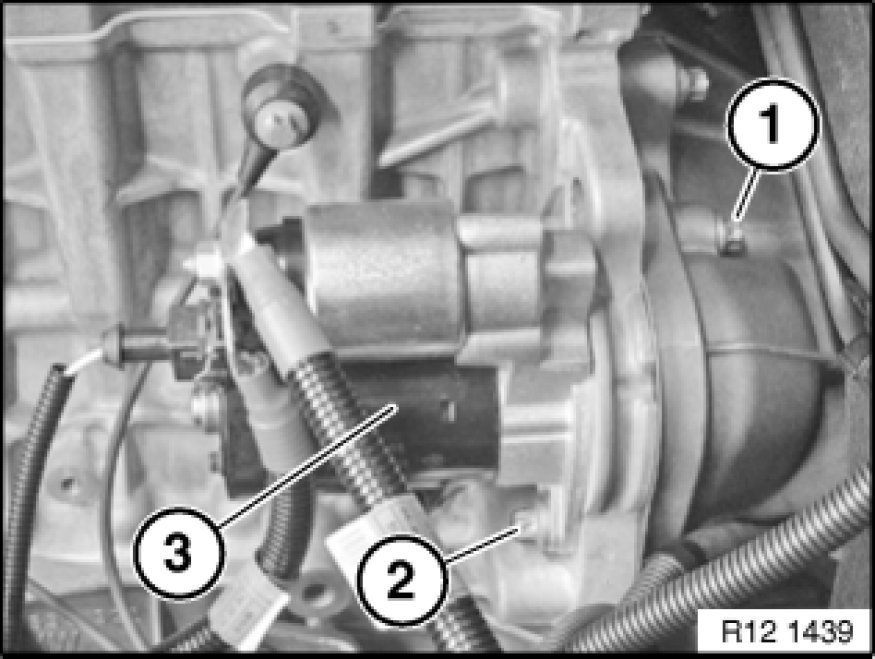

picture 4
Release screw (1).
Installation Note:
Replace aluminium screws.
Tightening torque 12 41 1AZ .
Release screws (2).
Installation Note:
Tightening torque 12 41 2AZ .
Remove starter motor (3).
picture 5
Installation Note:
Check starter pinion and ring gear for damage. Replace starter if necessary.
N53 only: In the case of a separate term. 50 lead (with dis-connector socket), the term. 50 lead is laid parallel to knock sensor 2 behind the fuel line.
I hope that helps. If you run into trouble or have questions, let me know. Also, let me know if this fixed the issue.
