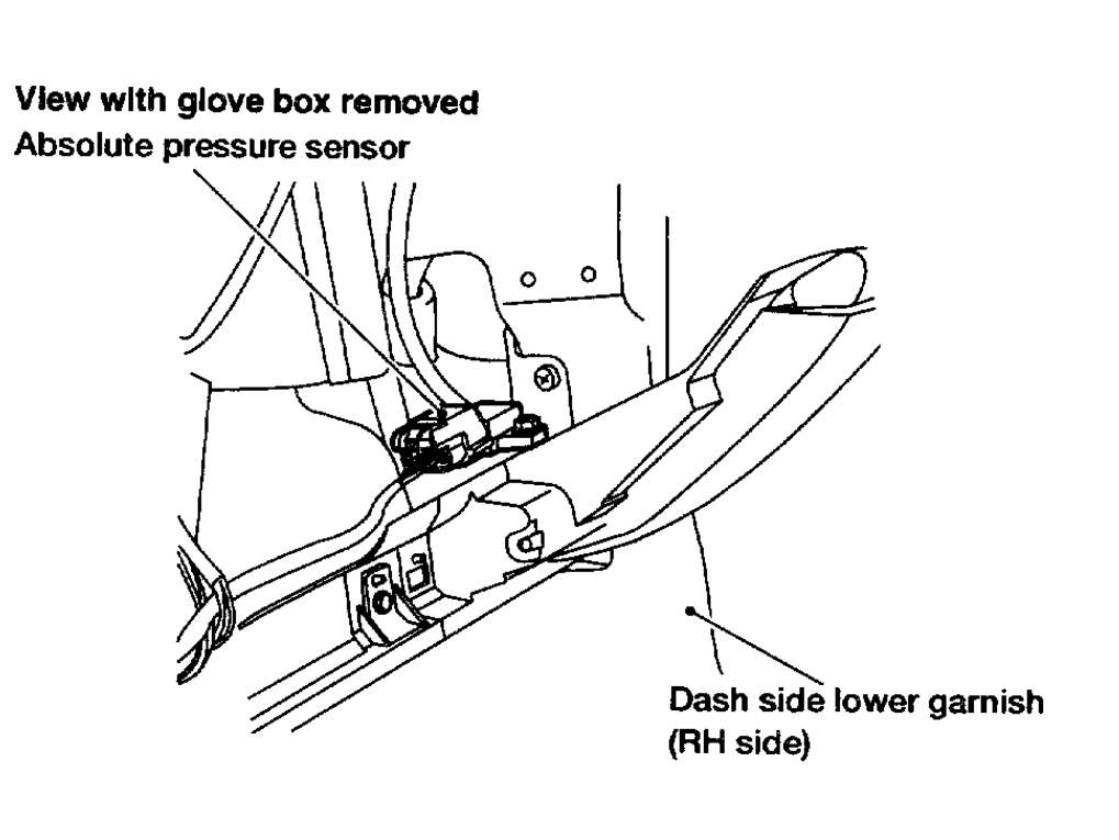

trying to find location of MAP sensor I have a code to replace it.

If you don't mind let me know which code that you have. Many times the code could be for a related item and not the exact part.

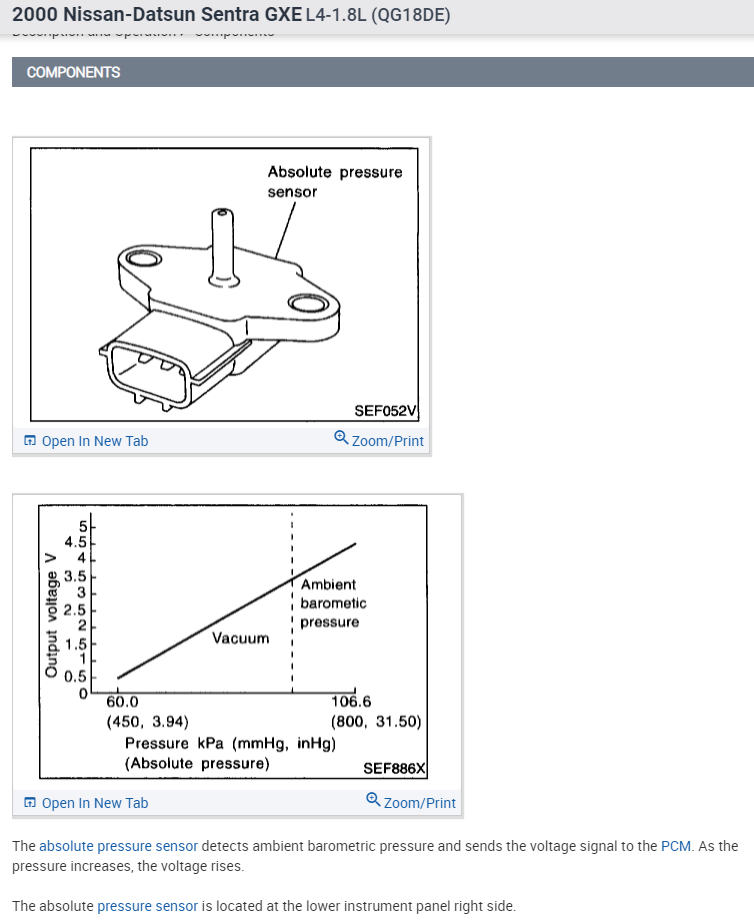

This vehicle have a absolute pressure sensor, it work like the manifold pressure sensor but located at the lower instrument panel right side.
