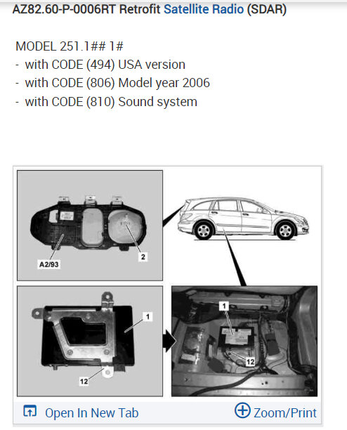

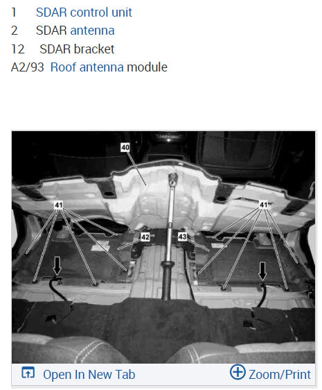

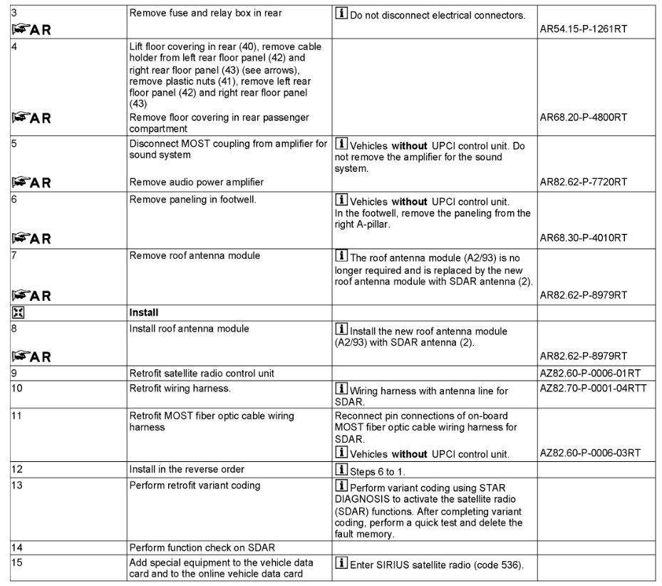

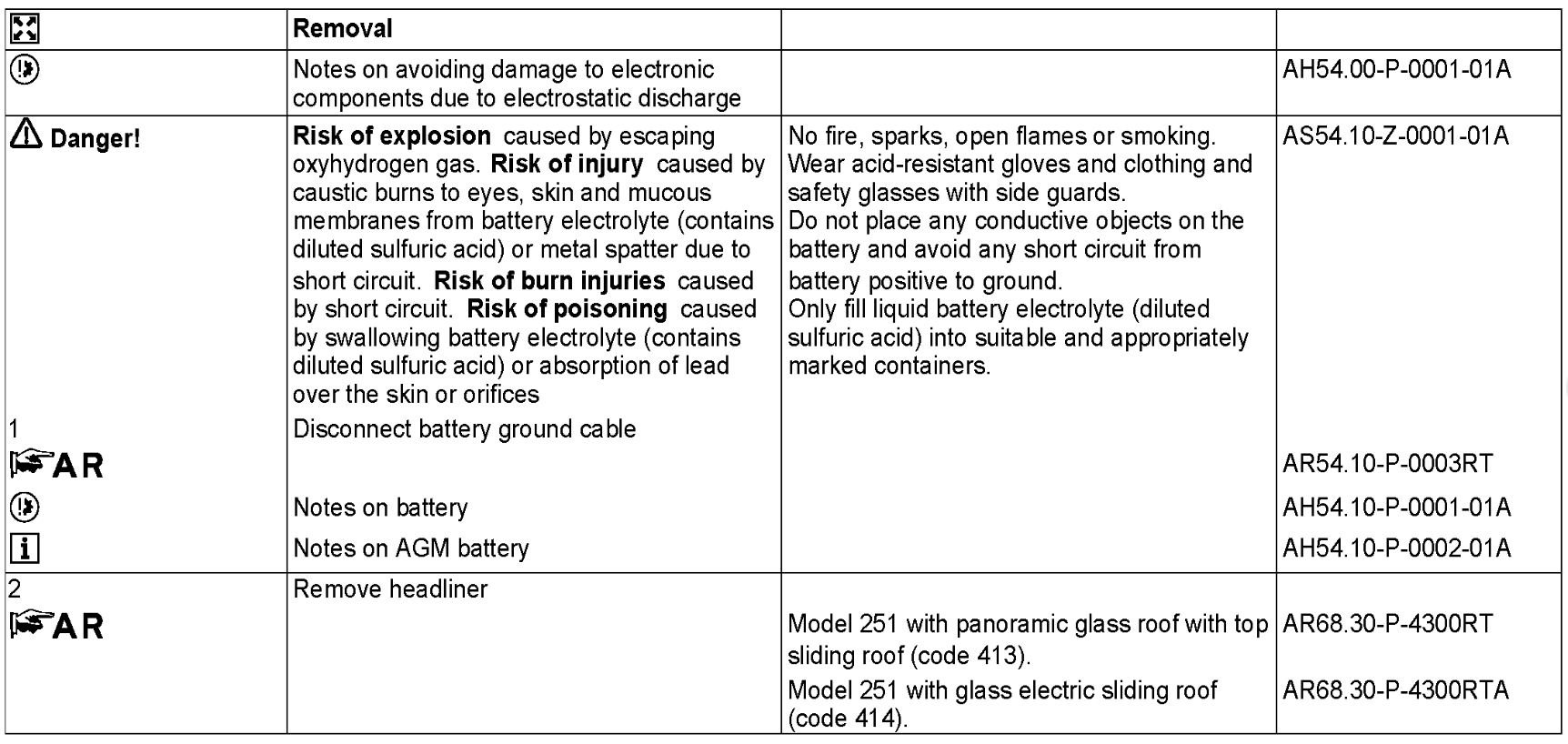

Yep, it will need to be coded using the STAR DIAGNOSIS system, the code is 536. Here are the instructions on how to install the Sirius Radio Module. Check out the images (below). Let us know if you need anything else.
